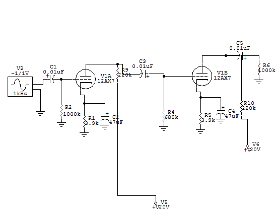

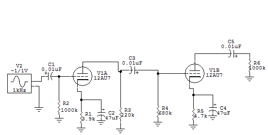

let see if got what said just look at my schematic

well, you need to have a B+ supply connected to the anodes...your schematic seems to show a ground connection where this would occur on the first tube, and shows no such supply on the second. For a fuzz, you could connect two diodes, one facing each direction between the grid of the second half and the decoupling capacitor off the anode. The other ends of both diodes connect to one side of a switch, the other side of the switch goes to ground.
For the exact values of resistors and B+ voltages, google "12au7 resistance coupled chart". Rp is the resistor from the anode to the B+ voltage. Ebb is the voltage connected to the top of this resistor. Rg is the resistor between the next stage's grid and ground (you only need one resistor to ground after the coupling capacitor between stages). C is the value for the coupling capacitor. Rk is the cathode resistor. Ck is the cathode bypass cap (For more distortion, try with and without a Ck at all). These are the symbols RCA uses, at least. If you can find a pdf of the RCA receiving tube manual (check on-line learning thread) it will have these tables toward the back. In my experience, using these values sounds very good, especially for instrument amplifiers. By changing the values of the resistors slightly, you can create different tones. DO NOT USE TOO SMALL A CATHODE RESISTOR!--the tube will melt.

yes, put your b+ at the end of R4...there is no equivalent resistor on section b, the resistor would be between the "top" (anode) of the tube and the capacitor. You'll need to look up how many volts and what size the cathode resistor (bottom of tube resistor) you will need. The capacitor will keep the DC high voltage from being carried to the next stage, but will allow the AC audio signal to pass.
I'm assuming that's more like 120v, right? not 20v? Anyway, I would try putting it together, and then adjust some of your capacitor values. It will probably work with sufficient voltage, but you may need to change some of those cap values to get the sound you want.
