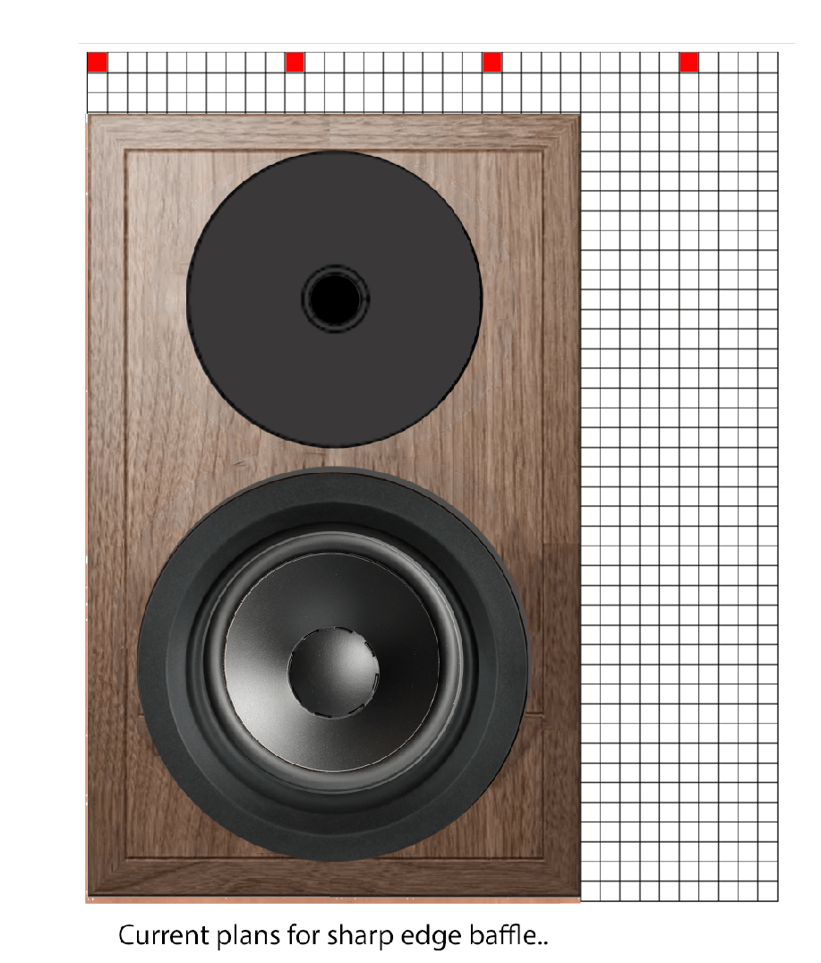

My 2-way speaker project has come to the point whrere i have bought drivers, tested them and know about size of the speaker.
(SBacoustic tw29txn-b & AT 18h52)
I will be using wavequide (jantzen 165mm) on tw29txn-b tweeter, and little selfmade wavequide on 18h52 (diy 200mm)
Thing is i would rather make from aesthetical reasons a sharp edged box, but i know that in "normal" nonwavequide elements rounding edges is benetifical.
I read that 1 inch is minium for it to have positive effect, and even more 1,75 inch is better (more depth in soundstage, reference from Lynn Olson)
-So what is your experience? Do i need rounded edges with wavequides or not?
I feel that because wavequides shape sound direction edgerounding would be not needed, but i don't really know..

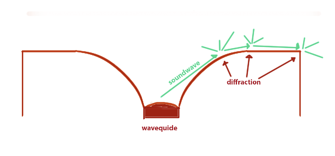

Hi Allen, thanks for the answer. Can you elaborate a little for a newbie?
So way i understand your response: Sound also travels beyond wavequide because of diffraction.
How much it travels is up to shape design of wavequide.
So in practical terms, yes rounding edges still would be beneficial with wavequide, if i want to go for "as good as possible".
-Do you think (in your own experience) that in this case with bookshelf there would be noticeable difference with straight edges vs rounded?
(Edges to baffle-edge will be 25mm straight, after wavequide edge, or 25mm rounded)

There are many factors so I can only outline them. Measurements might be able to help an experienced builder. Yes, diffraction.. but if a waveguide is undersized it will spill over more. Some design to fit the box, rather than the acoutsic requirements. This thread is about a different issue but gives a little insight into problems with the waveguide size being too small. - https://www.diyaudio.com/community/threads/is-it-best-to-use-a-non-axisymmetric-waveguide.375799/
It can also be a matter of the way the edge handling is implemented, the shape. Also yes, I did mean how low in frequency.
Don't forget that the waveguide is supposed to give directivity, and if it spills over too much then it may not be doing that too well. In any case, there's always a lot of overlap.

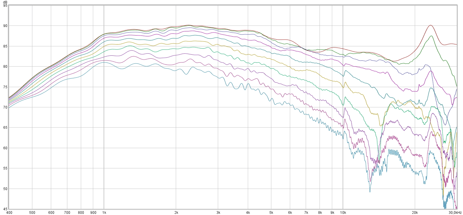

From my experience, WG + 20mm chamfering of the baffle provides perfect results if the width of the baffle is close to the dimension of the WG. In the attachment it is TXN + Jantzen WG, baffle 230mm, chamfering 20mm.
I did also measurement in 330mm baffle with 20mm chamfering and there was mild diffraction signature so in this case 30mm roundover would be better solution.
