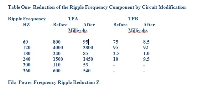

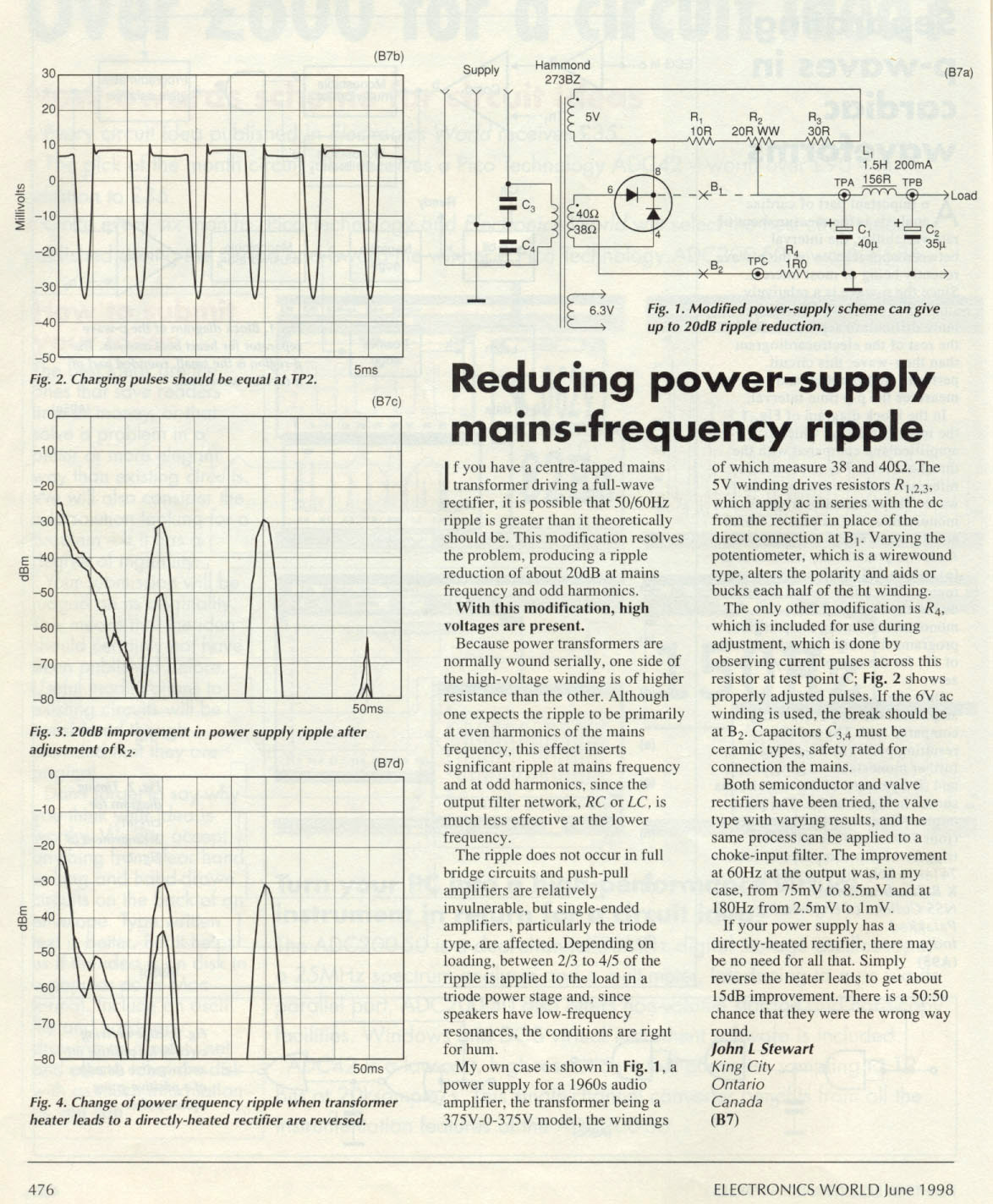

Here is something I tried about 25 yrs ago that might be interesting to others.
Reduction of power frequency ripple that could be a problem for SET amplifiers.
Something to think about,
I used an HP 302A wave Analyzer to measure the ripple magnitudes. 👍

I doubt filament voltage is in series , since for direct heated active tubes this would be a huge hum source 🙂

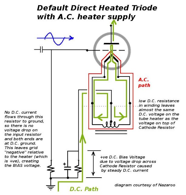

AC current has its own path , 5V winding and fillament , it doesn't flow in the rest of the circuit , so it is a floating voltage
For the ripple reduction circuit
If the 5V winding current is not flowing in the HV circuit , not just in 10ohm + pot , the result is = 0 , and reduction is just an effect of those extra resistors in series with the HT voltage

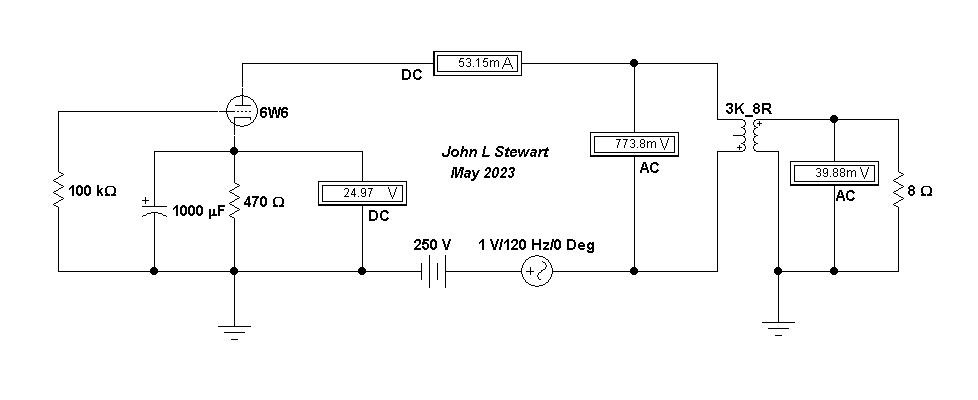

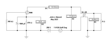

This simple circuit shows how PS hum / ripple can get into the audio output of an SET amplifier. Many will point out that PS hum can be reduced further without difficulty. That is not the point I’m making, but rather to simply show there is a potential problem. And its relative magnitude. Can anyone hear this in their system? Maybe.
Many people here on DIY & elsewhere spend hours discussing the merits of this or that boutique resister or capacitor & often completely miss far larger potential problems. This particular item may be something that is completely overlooked, it doesn’t often occur. But only when the power frequency happens to be at one of the LF resonances of the speaker system.
When I had a look at this 25 yrs ago I was most interested in the filamentary type rectifiers such as 5R4 & 5U4. The tests show there is a way to reduce the magnitude of the power frequency 50/60 Hz ripple component. So why not simply wire the rectifier to take that obvious advantage.
The difference in the resistance of the HV CT winding is less obvious & to a degree swamped by the rectifier forward resistance. But many are now using SS rectifiers, the PT HV winding resistances cause a much larger effect. For my own designs I’ve often put something like 100R into each of the SS diodes lead. If one of the diodes fail shorted there is still 200R plus the PT HV winding still in series. With luck the fuse blows before further damage. If there is a fuse in the primary.
While thinking of this today I recall how the common twin triode low mu triodes used in regulated PS all recommend series resisters in their cathode circuits to help force sharing of the load currents. Tubes such as the 6AS7G/6080 are well known not to be well balanced. That may also be the case with present production of tube rectifiers such as the 5V4 & 5AR4. Has anyone looked?

Also, on drawing out the circuit, I've also concluded the 5V winding is floating and not in series. It's obvious when drawn up. If I didn't use the 5V winding and powered with filament with a battery, it can be clearly demonstrated that the filament supply is not in series. Something that;s probably tripped me up in the past is seeing the filament windings in circuit diagrams as a secondary winding. Might be just my experience/impression but the 5V filament winding seems to be usually drawn up above the HT winding where the 6.3V filament winding is at the bottom.
