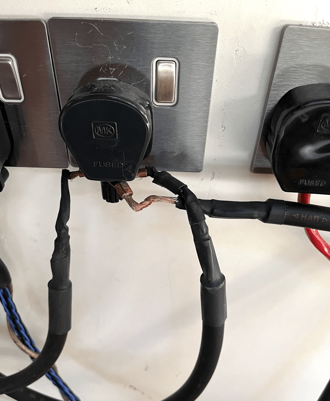

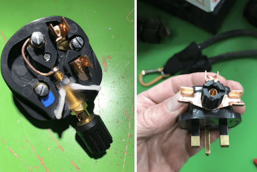

I use one of my sockets as an Earth only plug to take my circuit GND to earth separately to Chassis safety earth with an identical length low impedance cable on my DAC, preamp and Power amp. So I decided to move this to the problem socket D, I then connected L and N in the conumser unit to Earth, and L and N in the socket to join earth. So this leaves the MCB unused, and takes all 3 cores of the cable as Earth
Seems to have fixed the problem, it has however been a way of not really having to find the Why of the fault!!
