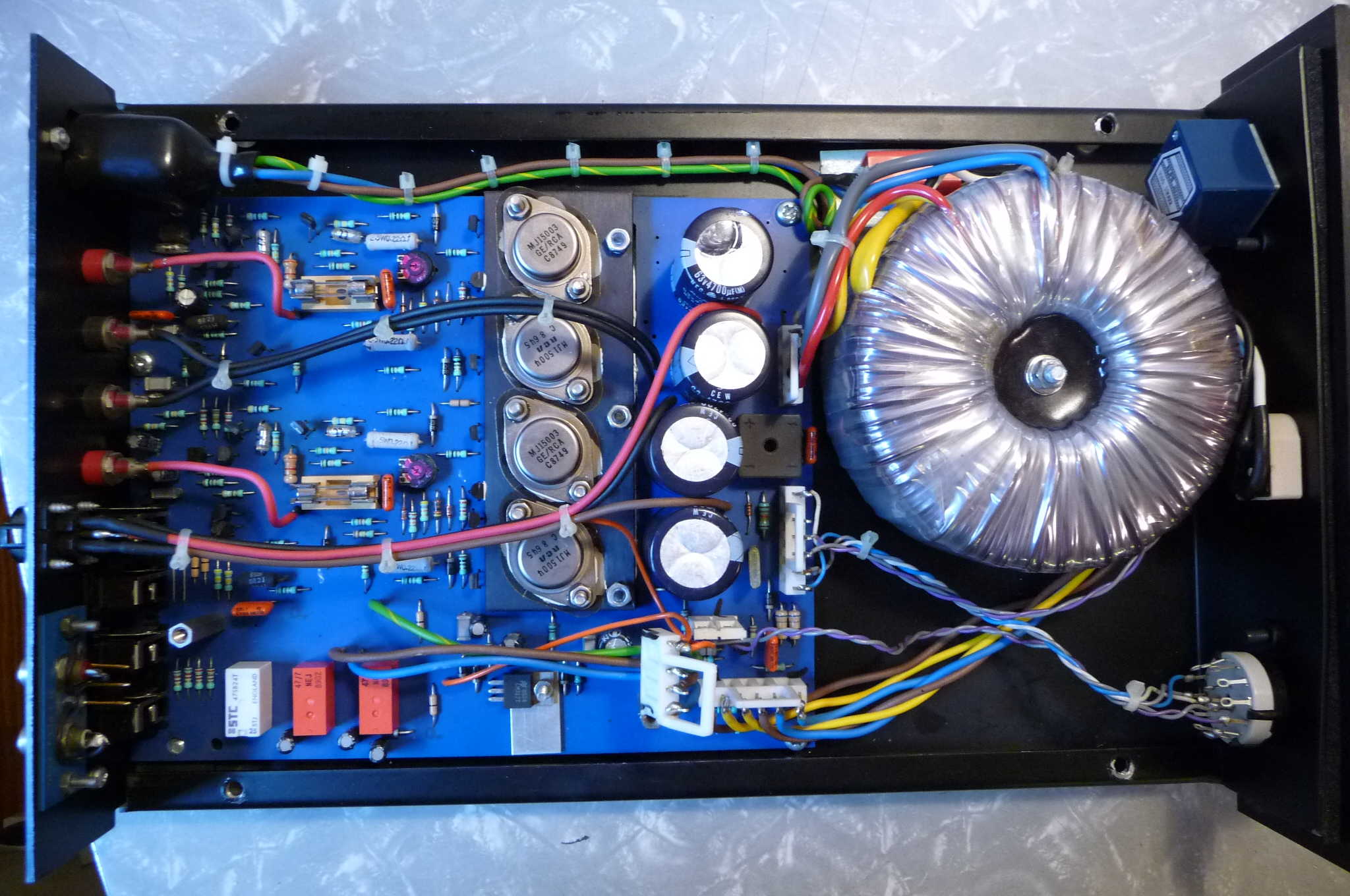

Hello all. I will be moving to Italy soon from USA and would like to take this with me. At worst I'll souce a new PT from someone like Plitron but hopefully won't have to. Anyone out there have this odd knowledge?

Have you turned off the power for a while and checked the mains wiring to the transformer? Assuming you can follow the mains Active(or Live) and Neutral leads to the power switch and back to the transformer, you should be able to see whether the wires that lead into the transformer are paired or single for each mains wire connection.
If paired, These could be separated and series connected in phase by a competent technician for use on 240 V. If only single, no. You will need either an external step-down transformer or the transplant as you say.
If in any doubt and better still, email the manufacturer with full model details. There are probably other owners on forum who will know the specifics. Hopefully they will have clearer directions for you

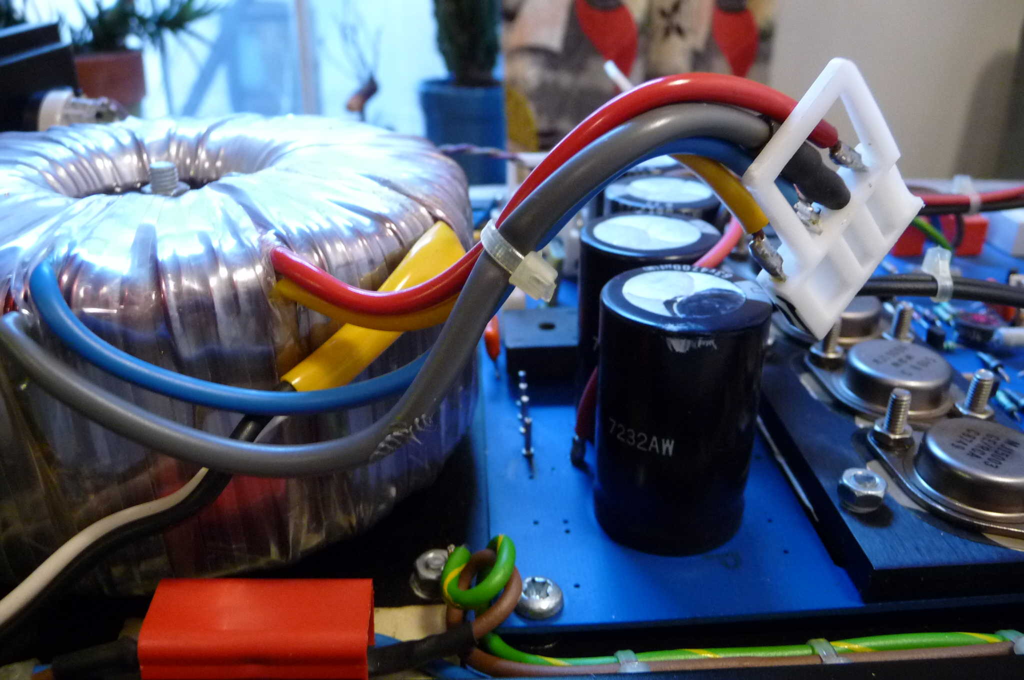

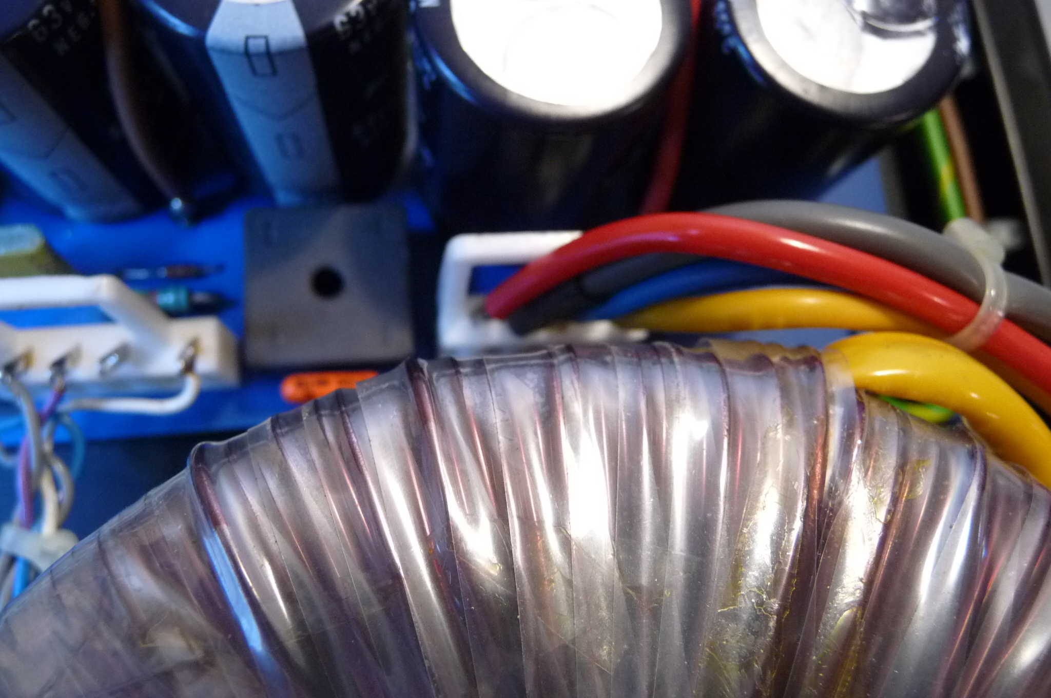

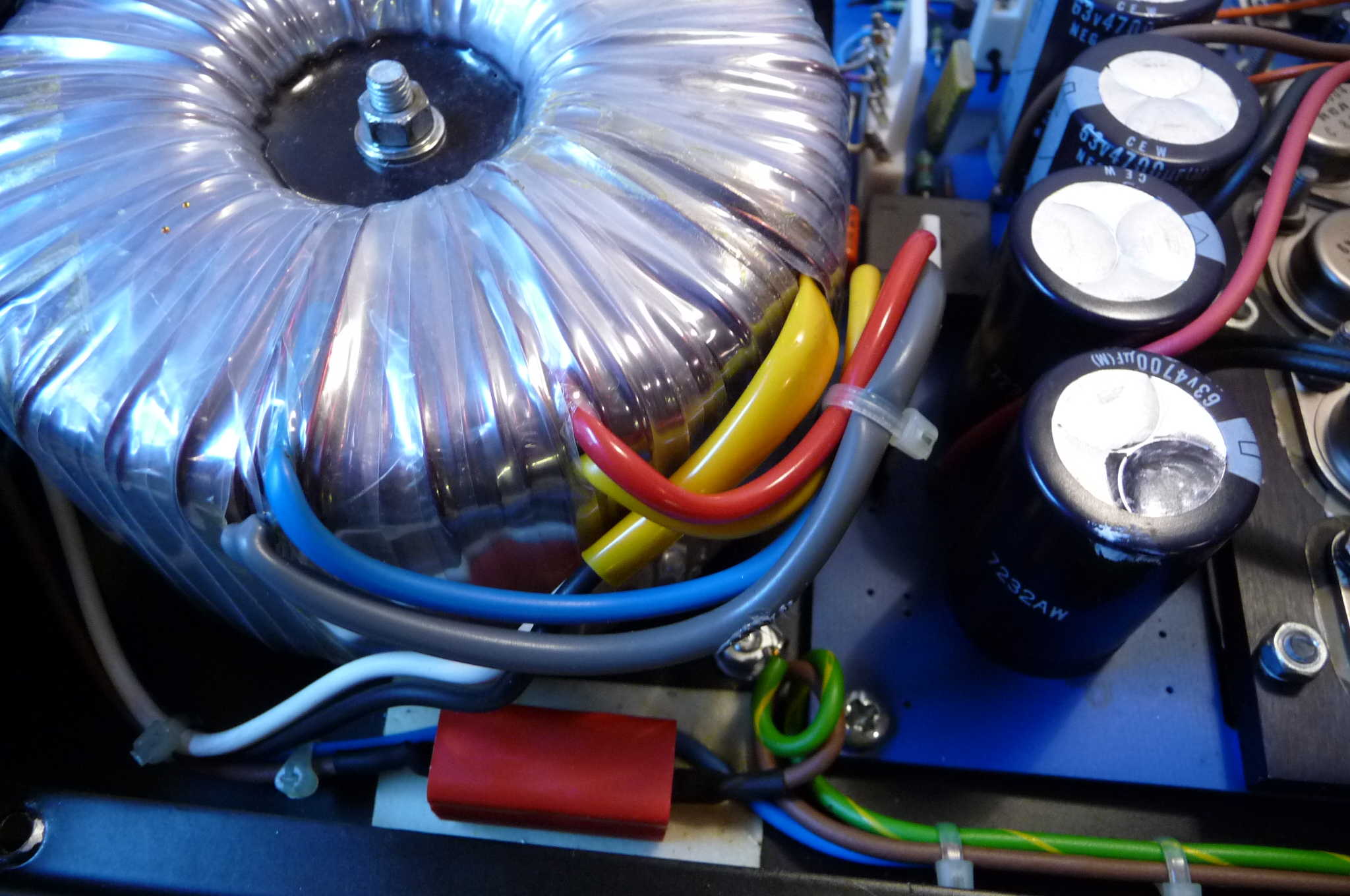

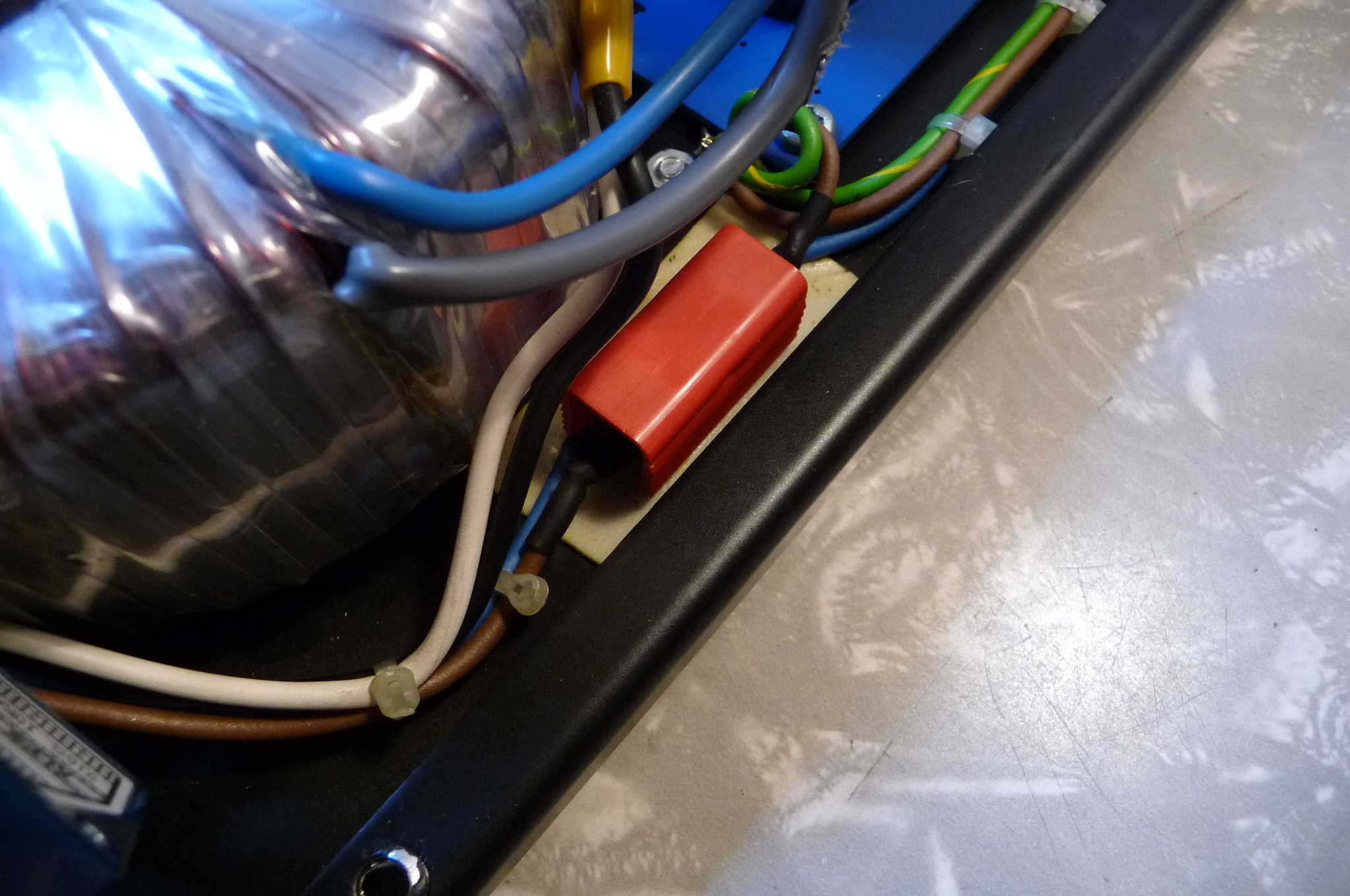

Thanks, pics tell us that you have four leads coming out of tranny to rectifier on PCB and another (black and white) pair apparently wired to a switch on the front panel. Presumably, the switch joins them to the brown and blue wires which connect to the mains socket at rear panel.
The sixty four dollar question :- If these are the only wires to the tranny apart from the four secondary wires already stated, you are out of luck. Sorry. You have only a single primary winding. However, the yellow PVC insulation on the wires may conceal the splicing of twin windings after all. Feel the wires with your fingers close to the entry point as a test. A skilled tech. may be able to safely separate any paired windings but I would not rely on this. Stay safe
