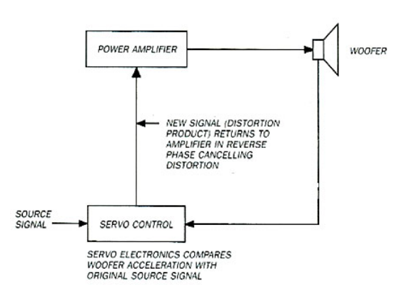

Posting this in case it helps.
Yes, thank you. That is pretty well described in the manual. The manual also describes, “ The signal phase of the SCU’s electronic woofer servo control circuitry must match that of the woofer amplifier.”
WARNING: The SCU’s phase switch must be correctly set for the amplifier in use. Incorrect setting of this switch can lead immediately to woofer and/or amplifier failure.”

Well, I flipped a coin and took a shot. Guessed the amp was in phase and I got it working with the speakers. I experimented with the center channel in the -3250 for just one side, figuring if I roached an amplifier, I could lose the unused center channel (independent power supply per channel). Thanks everyone for your replies/suggestions.
