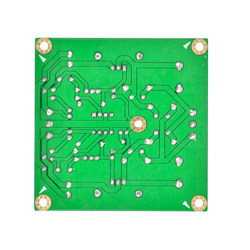

Does LM317,337 need thermal paste?
This is heatsink I have.
images
The back of the 317 and the heatsink are not infinitely smooth, so when you put them together there are small air pockets that hinder heat flow.
Thermal paste does fill the holes and has low thermal impedance so helps to transfer heat from 317 to heatsink, so it helps cooling.
Jan
Did I miss the answer to the question: "Is it getting hot?"
If you can hold your fingers on it then the answer is "no - you don't even need a heatsink"
If you cannot hold your fingers on it, then the answer is "yes, you need a heatsink. If you DO need a heatsink, then you need either a SILPAD or insulator bush and heatsink goo. "
Well I didnt run it yet, but it should be used for 30mA to 1A loads, so I should use heatsink anyway. Heatsinks arent connected via traces to anything on pcb so I shouldnt care about insulating. I will use silpad because I dont have any paste right now and its cleaner and easier.
