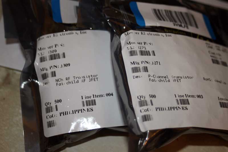

J271 is direct replacement here for 2SJ74 , even regarding that parameter
and - it's easy to source them at usual on-line stores ; just look what's written on bags on that pic in #17
Thanks ZM
I've seen the bags, no pb 😎
