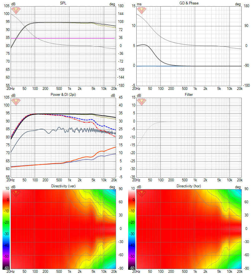

It wasn't... at low frequencies the driver acts as an omni. Depending on the frequency one calls low, just look at the horizontal and vertical plots of a driver of the size you aim to use. Depending on the driver size, if the wavelengths you ask it to play are larger than the driver size, it will radiate in every direction as if it were an omni.
attachment.php
The only example I had on hand. A 7 cm or 3.5" driver. See how both horizontal and vertical directivity plots show output in every direction below about 800 Hz?
So if it is playing below 800 Hz in this case, it wouldn't make a difference if it's pointed up or horizontal. It would radiate in every direction anyway.
Disclaimer: The plots above show a differing horizontal vs vertical directivity pattern. Horizontal pattern has been determined using Akabak and the used enclosure shape while the vertical shape belongs to a single driver in an array, hence the difference in patterns seen here...
