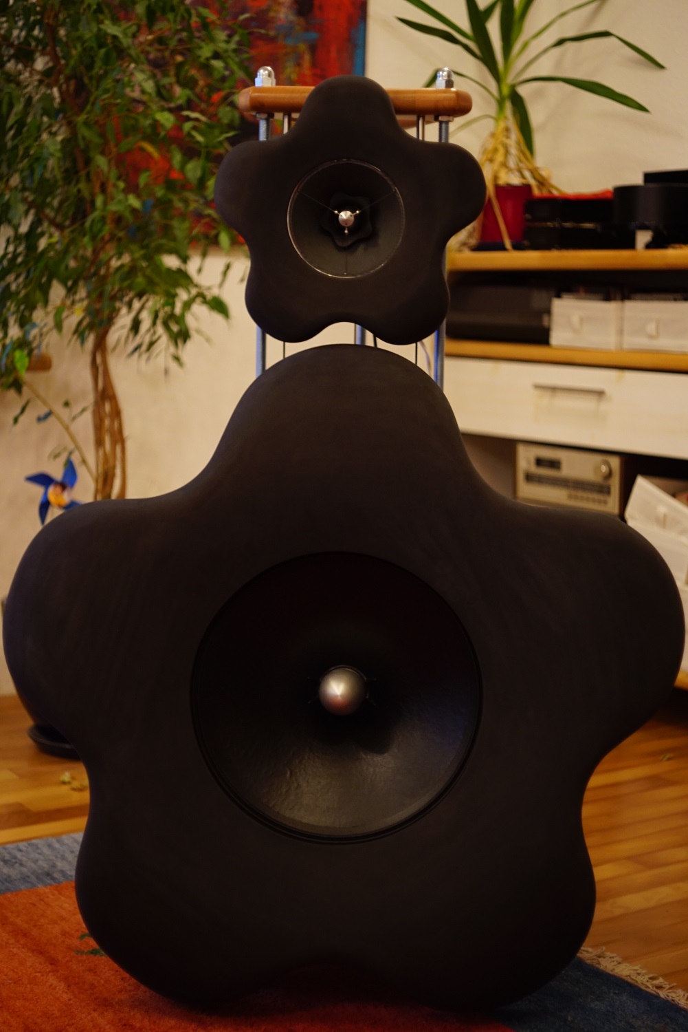

Hi Scone,

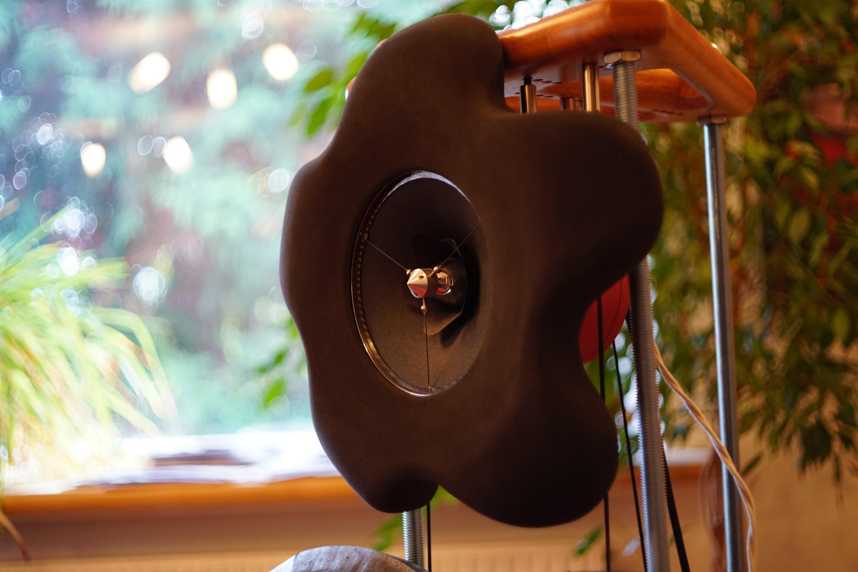

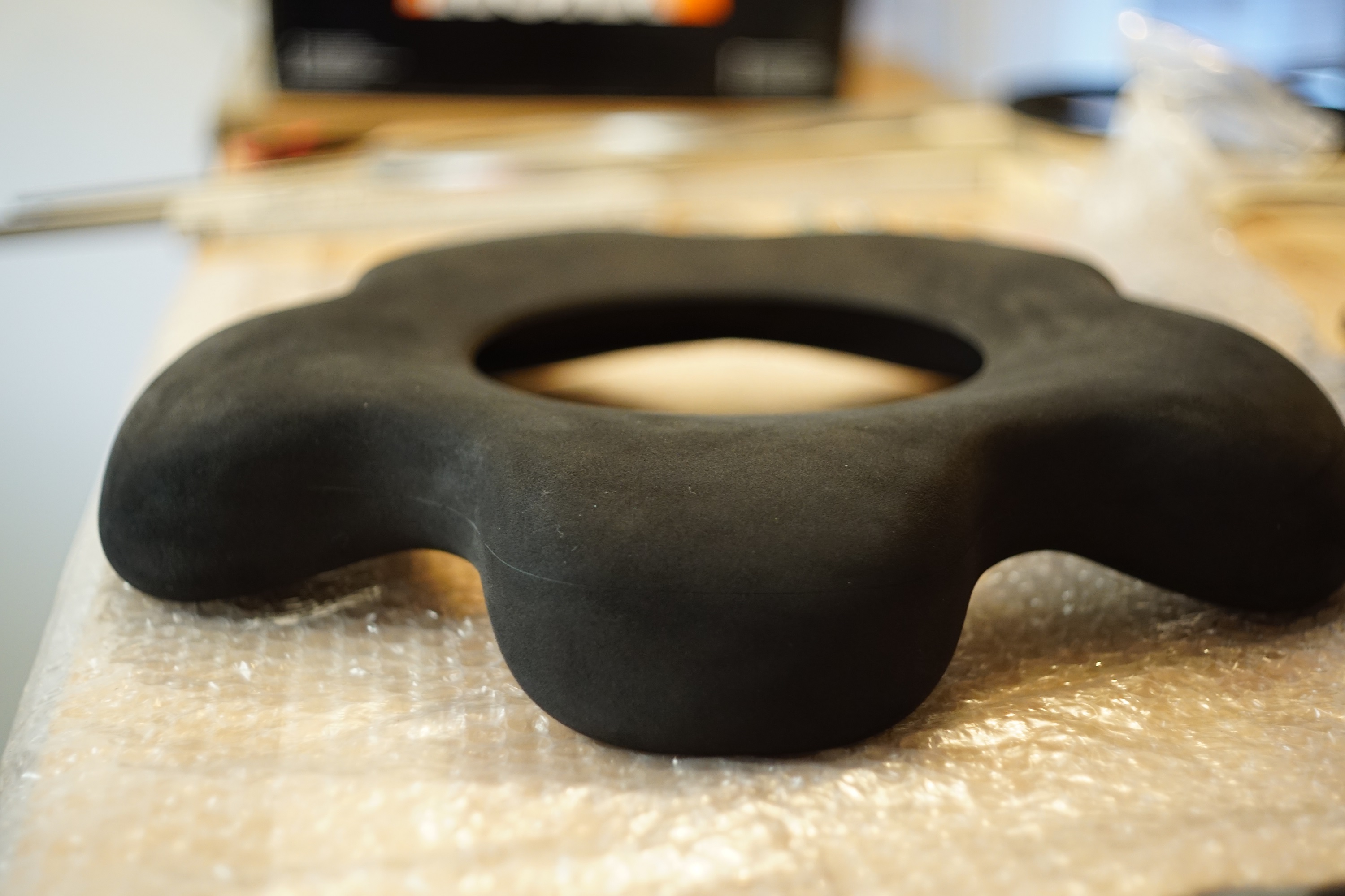

you´ve asked about the sonic improvements, and I might add my experience along the way with my speakers, although of a quite different conception.
I found that minimising diffraction (and in the same way, minimising baffle effects in my dipole OB system) will lead to
- a more precise system with less "hash" will give you a better insight and a clearer view onto the music (sorry if I sound not precise, English is not my mother language). This can actually distract your musical joy, as you´ll hear more of the problems inherent in either recording and design... but if all else is right, a good thing in my book.
- a better localisation of instruments in 3-D space, given all else is right.
- less listening fatigue, given all else is right.
So, if you´re able to invest time and money in diffraction control, this is a good thing in my opinion. For all technical matters and a lot more input there are several threads here on this forum, like this one

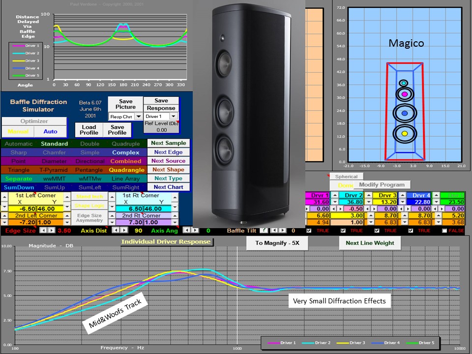

2) One example of MTM with large radius edge rounds on the front baffle to reduce distortion.

Or if you want to get a better understanding of the effects of changing baffle dimensions as well as the shape of cabinet edges and you have Excel, download the Baffle Diffraction and Boundary Simulator by Jeff Bagby (free!) and play around with that. All else staying the same, increasing the front baffle edge roundover has the most effect on the tweeter response and all of it is positive - the response becomes smoother as the size of the roundover increases.

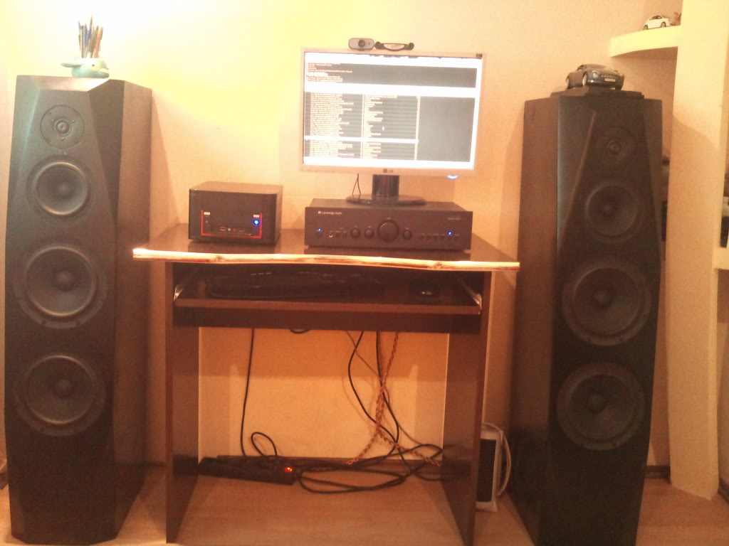

SB Acoustics 3 way -- deeper stereo bass, cleaner single midrange, better polar pattern/lobing --- than MTM
This thread covers construction of an Avalon style cabinet with two 8” SB23NRXS45-8 woofers for deep stereo bass. Your family might favor the cabinet shape. The cabinet has a slight tilt for T-M time alignment, but the tweeter uses and LR4 crossover which typically sounds coherent even with a no-tilt baffle construction like $22k Sony AR1. Post #29 has dimensions.

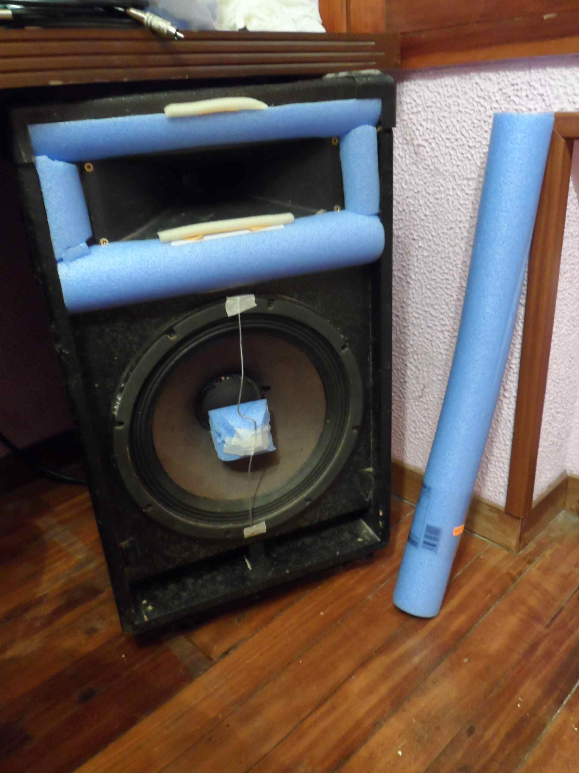

"Round ... Round ... Get-a-Round.... I get-a-Round" if you trust the Beach Boys and lust for Magico speakers you may want to ask Santa for a 1.5" quarter round router bit. Baffle simulations show significant reduction in distortion campared to sharp edges.
A 1.5" radius cutter will fit a 0.5" router chuck.

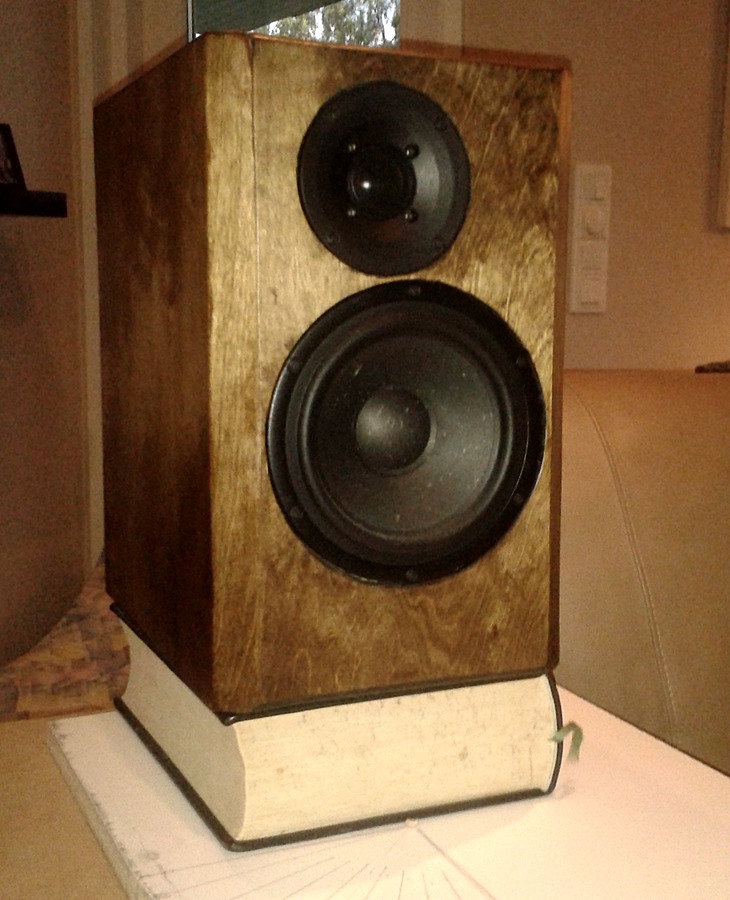

Outer edge chamfering to round shape is actually quite easy without a large cutter. First use a saw to make a bevel. Then continue with planer or hand file to round off edges. For smallish speakers just use the planer and belt sander.
I have this Makita.
Round edge must be painted, but a bevel can be laminated.
