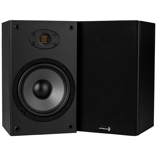

… B652-Air speakers ...
https://www.daytonaudio.com/product...2-way-bookshelf-speaker-with-amt-tweeter-pair
Less than $10 in driver & XO parts? (per box).
Likely a lot can be done to clean up the rough edges.
dave
I did modify the B652-Air crossover, you can see that in this thread:
https://www.diyaudio.com/community/threads/dayton-b652-air-outdated-bsc-crossover-mod.335560/
I'm appreciative of any tips. The woofer is polypropylene and could be used for a McKenzie style mod, although I have no way of knowing where the dimples should go.
