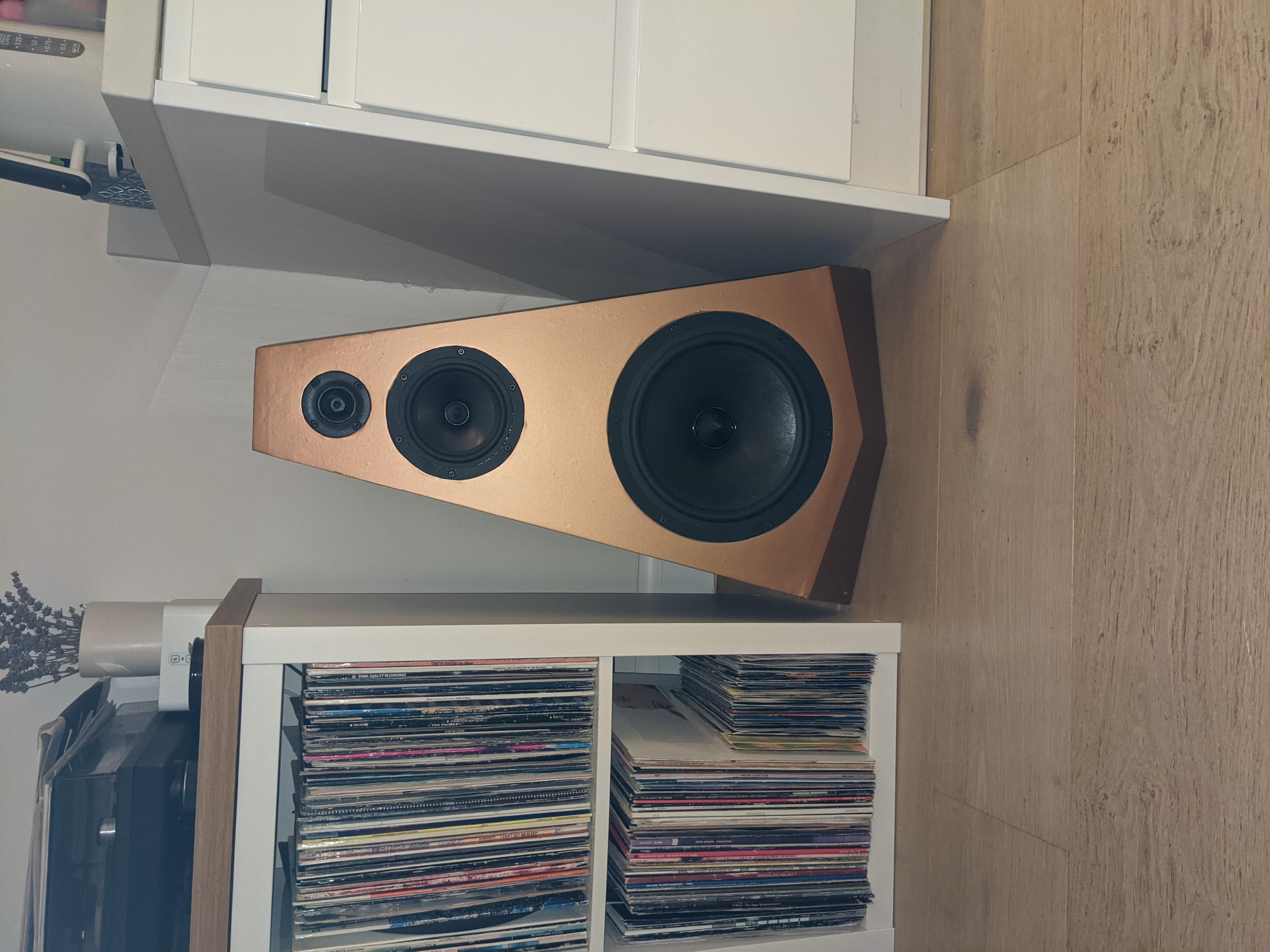

He moved on to the later Sony SS-M7A:
689876d1530555804t-crossover-mods-increase-bass-level-img_1433-jpg
Good cabinet construction:
689877d1530555804t-crossover-mods-increase-bass-level-ss-m7a-enclosure-jpg
For the technically minded, I think these were Vifa 8" and 5" polycones with a Vifa soft dome.
A good enough combo, IMO. The sloped baffle, aka time-alignment, is quite the rage these days. 🙂
You can estimate measures and angles by tracing (fprawn labs) good quality pictures, if there are any. Outer frame edge of an 8" unit usually is about 220mm, and some guidance provide enclosure measures.
Jonny,
I bought the demo pair of SS-M7s from the local dealer on closeout when they were discontinued. They were my only speakers for years, until I got the bug to start building speakers for the fun of it. They still sound good in my garage driven by a Luxman integrated, probably better than anything I build if I'm honest.
A sketch of the driver baffle is attached, dimensions in cm, NOT to scale. The baffle slopes back at 11 degrees as measured both by protractor and smartphone inclinometer. The sides slope 10 degrees (measured on the flat sides, not along the front edges).
If you need more measurements, just ask!
Bill
