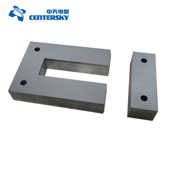

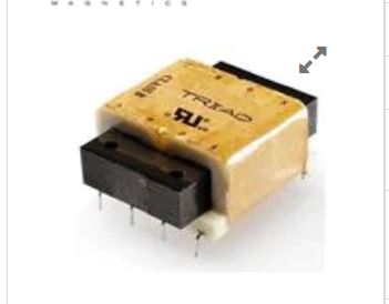

M mrjayviper Member Joined 2012 2023-11-06 6:30 am #1 2023-11-06 6:30 am #1 Is this what they call an R-core transformer? Thanks! click here for mouser link P pieter t Banned Joined 2004 2023-11-06 9:02 am #2 2023-11-06 9:02 am #2 No, it is a socalled UI core, a stamped laminate like an EI core. A UI core carries two bobbins (like a c-core and r-core); an EI core carries one bobbin. Attachments Ui-Type-Lamination-Silicon-Steel-for-Transformer-Core.jpg 18.3 KB · Views: 42 Reactions: mrjayviper You must log in or register to reply here.
