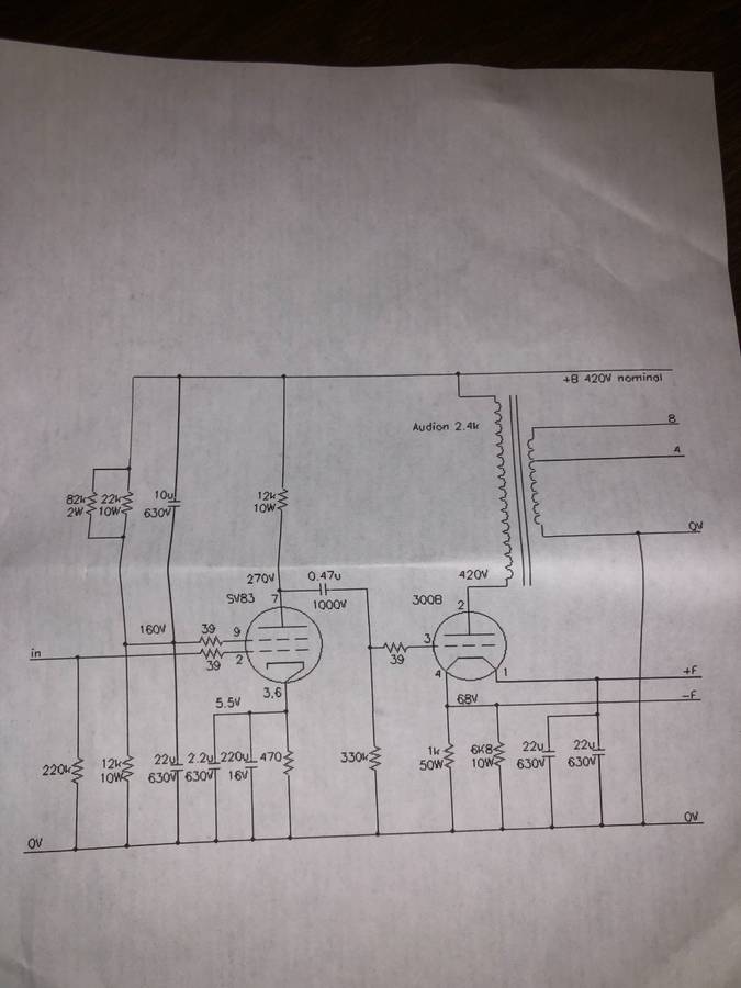

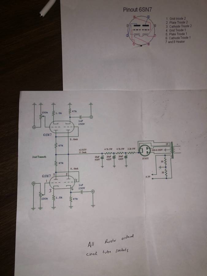

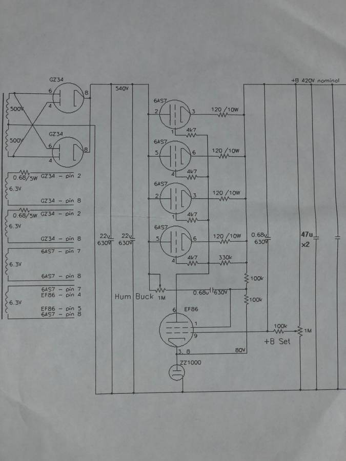

Does anyone know what schematics these are?!
A local seller posted a design based on these schematics and Im unfamiliar w/ the topology and/or schematic design. Does anyone know what circuit these are based on or what power I'd be expecting from it?

Looks like three schematics, one for a 6080/6AS7 power supply with dual GZ34 rectifiers that provides stabilised 420V at several hundred mA. The designer is pretty good, i see no obvious errors, allthrough EF86 as an error amplifier would not be my first choice.
Second is a 300B amplifier driven by a SV83 pentode, not a bad design, a classic in its own right, about 7W should be the output power of the 300B SE.
The last seems to be a simple 6SN7gt preamp.

The 300B-SE schematic is Thorten Loesch's 'Legacy', designed in the 1990s. He wrote it up on here about 18 years ago, search around here for the interesting text. Thorsten derived it from the work of La Maison de l'Audiophile.
It works very well with many types of driver pentode (I liked the 6BW7 best) - so long as they driver gets its own supply. IMHO it was probably the best performing (and sounding) 300B-SE until superior solid-state assisted driver designs supervened.
