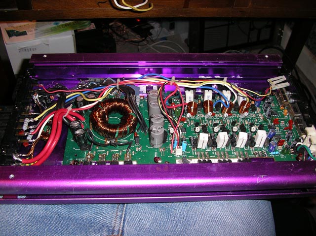

Does anyone know what amp this is and who makes it?
I got these amps for next to nothing, and I'm after a schematic, but I don't know who makes it or what model it is.
I've already hacksawed the PCB in half on one of them and now it doesn't work, so I'd like to find some more info before I get :smash: again. 🙂

Looks like 4 x 75W "generic Chinese". This stuff was available through several brands, and Pyramid was one of them. Some stuff from Magnat and Jensen probably came from the same factory. Are the outputs B778 and D998?

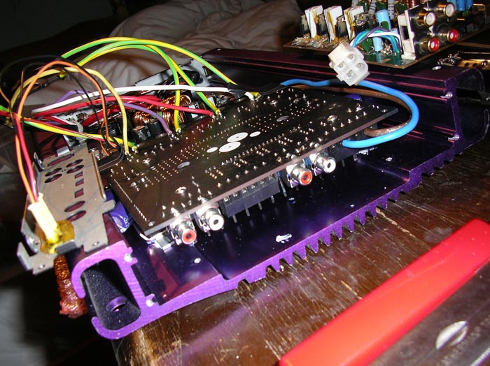

Yep, B778's and D998's, only one of them works, on 3 of the 4 channels, so I butchered them, and managed to use the power supply from one. I still have the other for spares....
I them put in a 4 x 100W class D module, and it works really well... I just need to figure out how to squeeze an active crosser or two onthere somehow... 🙂

In most circuits you can replace these hard to find output transistors by the widely available (at least in Europe) TIP35C and TIP36C, just in case you want to repair one of the amps...

Thanks, I'll keep that in mind... even tho I now have quite a few spares after I hacksawed the amp part of off one of the amps. :devilr:
FWIW, I tested it all out today, and it sounds nice and clean, certainly an improvement on the original.
For now I'm happy with my quick and dirty solution, as right now I'm using the inbuilt amp on my HU. 🙁
If I was to do it again, I probably would do my own circuit, or change the toroid at least... as this amp has 24v rails, and I only actually used the +ve rail for my class D module, so I have the -ve rail sitting there with no load. I may use the -ve rail for powering op amp at a later time tho... I only read up on push-pull supplies a few days ago, I'm still getting used to it all, but I'm glad to say I haven't released any magic smoke (yet). :bigeyes: :smash:

Also, I've decided to go with a separate pre-amp, I can't really squeeze any more in this amp case apart from a small voltage summer circuit to make my bass mono... 😎
