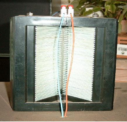

Does anyone know this ribbon driver?? I need some data on it. please!!!
I have this two of these fine ribbon tweeters, but no data on them....
Can anyone help?

They certainly appear to be Heil AMT's, (Air Motion Transformer), and they are considered among the best tweeters/upper midranges in the world. I auditioned them once in a stereo shop in the seventies-it was hard to tell because I didn't think the woofer in the ESS unit was all that great.
Do a search for Heil and you will see that this has been discussed often. There is even a member named AMT-freak!

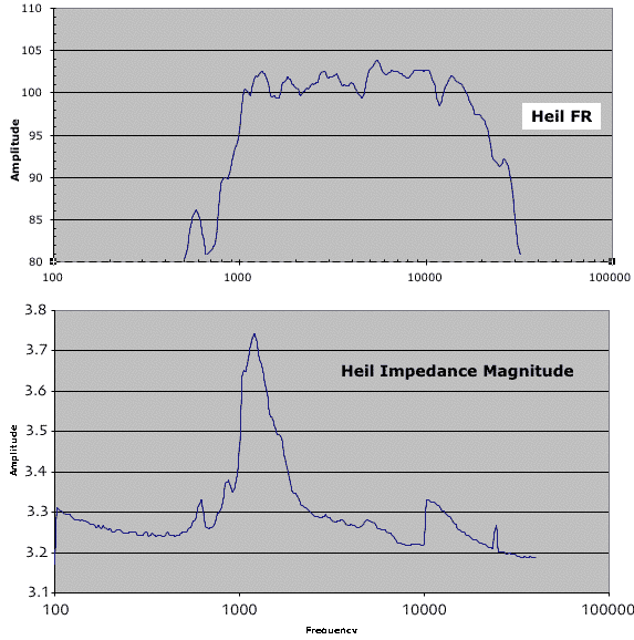

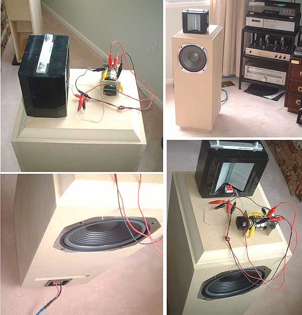

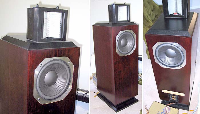

These are indeed fine tweeters. ChrisB and i are working on a design using these for a client (pictures are from a developmental stage -- i hope to get pics of finished speaker this week) and previously did a 3-way AMT-1 conversion.

The SPL level you have shown in the graph.. is this true... 100dB?

Lightning fast speakers as they are they're not easy to match to a woofer, though.
They aren't... they scream to be bi-amped. Even with 8 dB of padding and a passive XO they do mate well with the FW227 Fostexs (unfortunately discontinued). They should be running bi-amped later this week (2 x Decware ZEN Selects w PLLXO).
