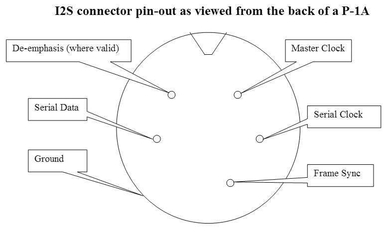

Does anyone know the pin configuration for I2s
Hello
I am using a P-1a and P-3a (modwright II) which both have the option of using an I2s input and ouput. The stock cable is not that good but no one seems to make a sensible priced replacement.
I have been able to source some 999 silver teflon coated wire and deicided to make my own replacement but I do not have any details of the pin conifguration. I think that only four pins were used and one is not but not certain.
I do remember that this may have been information already on the site and I have tried a number of searches using different words and names but have not been able to find anything.
If someone could either send me a link to the thread that has this or provide me with the details I would be very grateful .

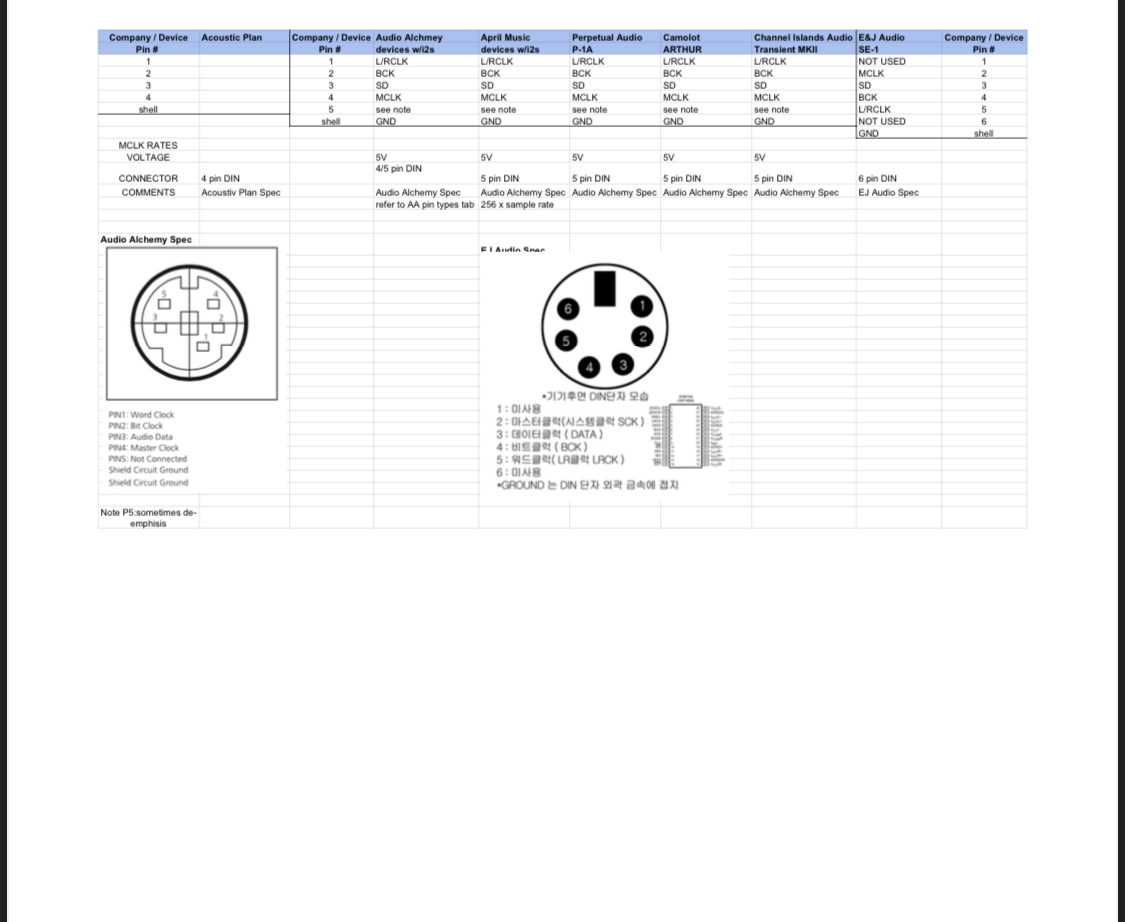

urgent please note
Please note that when making up this cable as per the advice given to me this cable did not work . I had checked that the wiring was all correct and that it was consistent .
I have now found after much searching the below picture which comes from another thread and this picture is supposed to have come from Perpetual Technology themselves .
This is the confirguration for the PT P-1a and P-3a units plus the Audio Alchemy units and for those units only. It would appear there is not standard cable configuration and these cable would not work with any other companies units such as Stello .
Please accept my apologies for getting this wrong but this was a genuine error .

I do not want to post this too soon as the original cable did not work due to me getting the pin configuration wrong as in the above thread. However I have been able to find a cable maker who will make up the 5Pin mini din for the I2S lead for PT equipment using 99.9% silver cable it is Achtung Audio on E-Bay .
I will confirm how this sounds and if it works once I have the cable reconfigured and will also confirm that the wiring as per my attached diagram does indeed work. I think this would be a viable and sensible cable with costs around £35 - £40 per 0.5 metre (try and keep this cable as short as possible this is not a proper protocol for use with cable but meant to travel only very short distances through pcb track between ic chips.)
