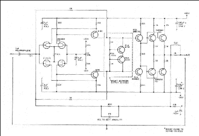

JC-3 toshiba input jfets
hi,
i'm delighted to see this thread
came across this schematic a few days ago, it looks wonderful.
my thoughts on transistor replacements were:
2SK389 and 2SJ109 for the input fets
MJE15031/32 drivers (the ones MikeW lists aren't in my supplier's catalog)
2SC3281/2SA1302 or 2SC2987/2SA1227 outputs
toshiba drivers would be nice.. any suggestions?
i would use only one pair of output devices and bias for only 5W class A, so about 600mA. 12w dissipation per device..
Mr. Curl, what is your opinion of this design of yours?
keyne

keyne,
5200/1943 chips are nearly the same as 3281/1302, but newer and improved. I use them in my amps. Datasheets are available (try google). In case you have any problem with these datasheets, e-mail me and I can send you PDF files. Another advantage of 5200/1943 is that there are not so many clones and fakes as for 3281/1302. I use BD139/BD140 as drivers for 5200/1943.
Pavel
