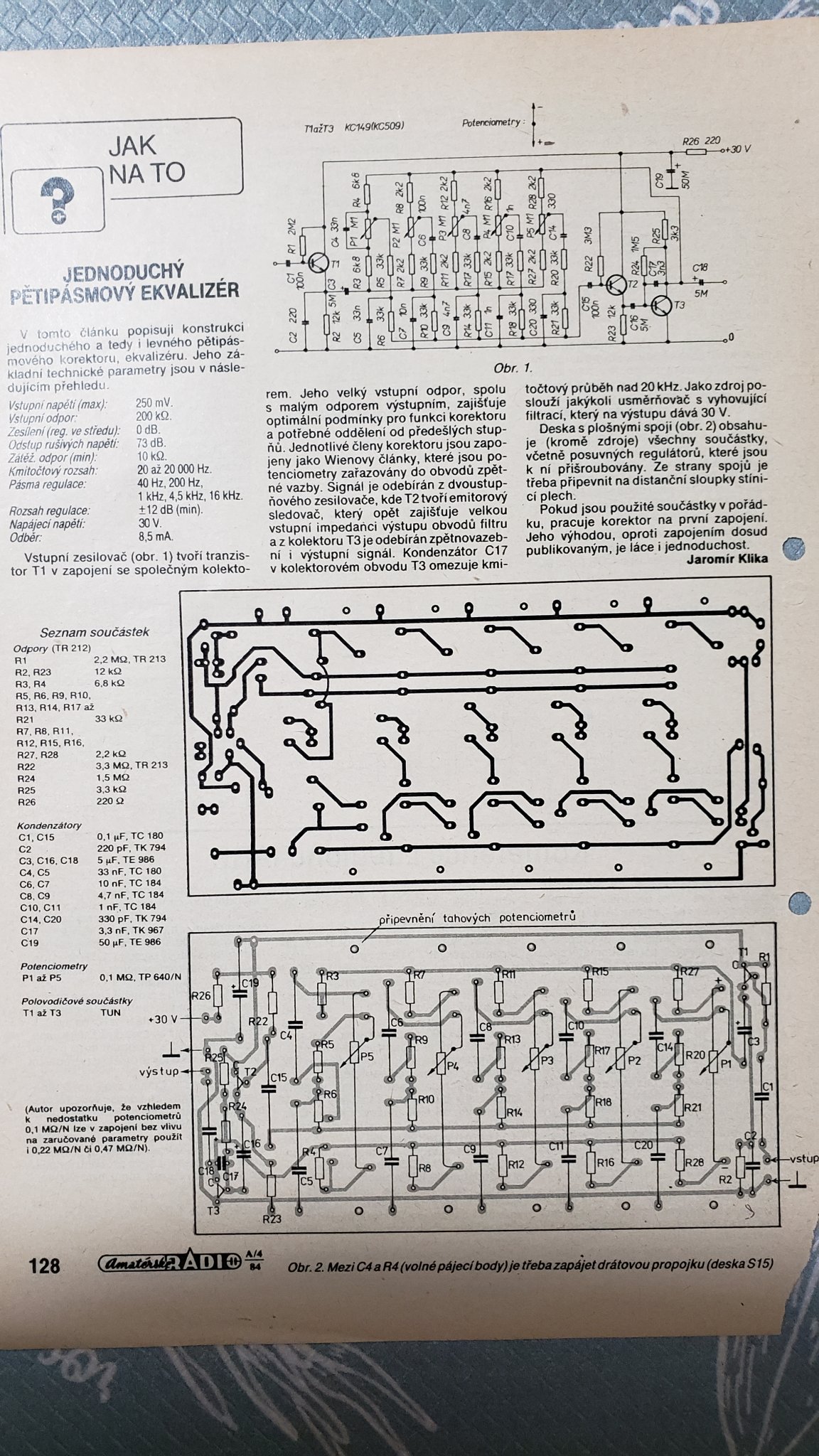

Does anyone have any pcb of a good 5-band tone control?
I did build 5 band eq in the past, just line in, line out, it had only 3 transistors. I believe it was adopted from jvc circuit.
It was published in old commies magazine Amaterske Radio. I do have box of those magazines in the atic somewhere. I can look for it in few days.
Otherwise, if you go to hifiengine, there may be service manuals for 5 band eq. Including pcb. JVC had surprisingly simple circuits which sounded ok.

Found it!
Send me your email in pm. I will scan it and send you high res scan.
This is just preview.
