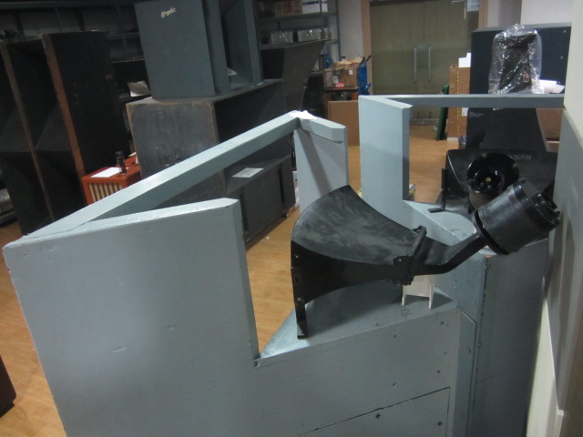

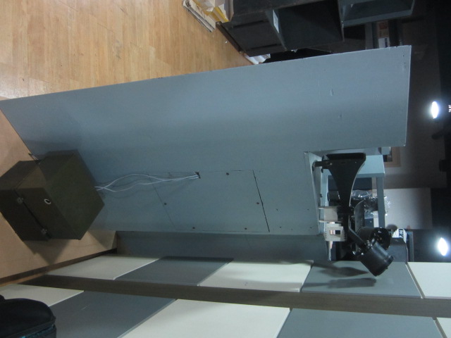

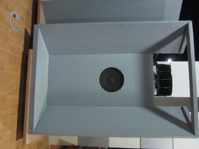

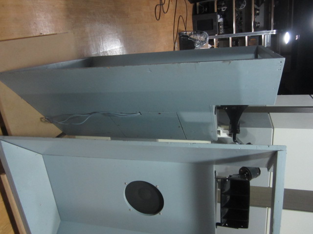

Years later...I measured and sketched out the dimensions of a Western Electric L8 and I'm posting this info here for the record.
Note: side parts add up to 70cm but I wrote 80cm in the heat of the moment. Not sure which is correct offhand but there is enough info given to calculate that out.
If any body build this, make me a pr also! ;op

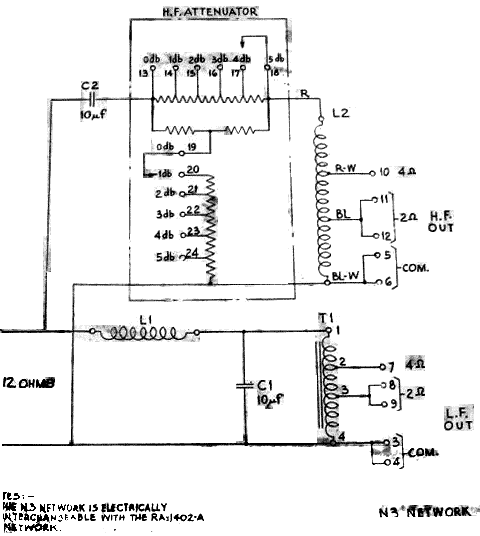

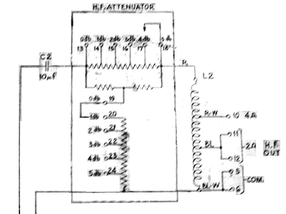

Attached also an image of the crossover schematic.
