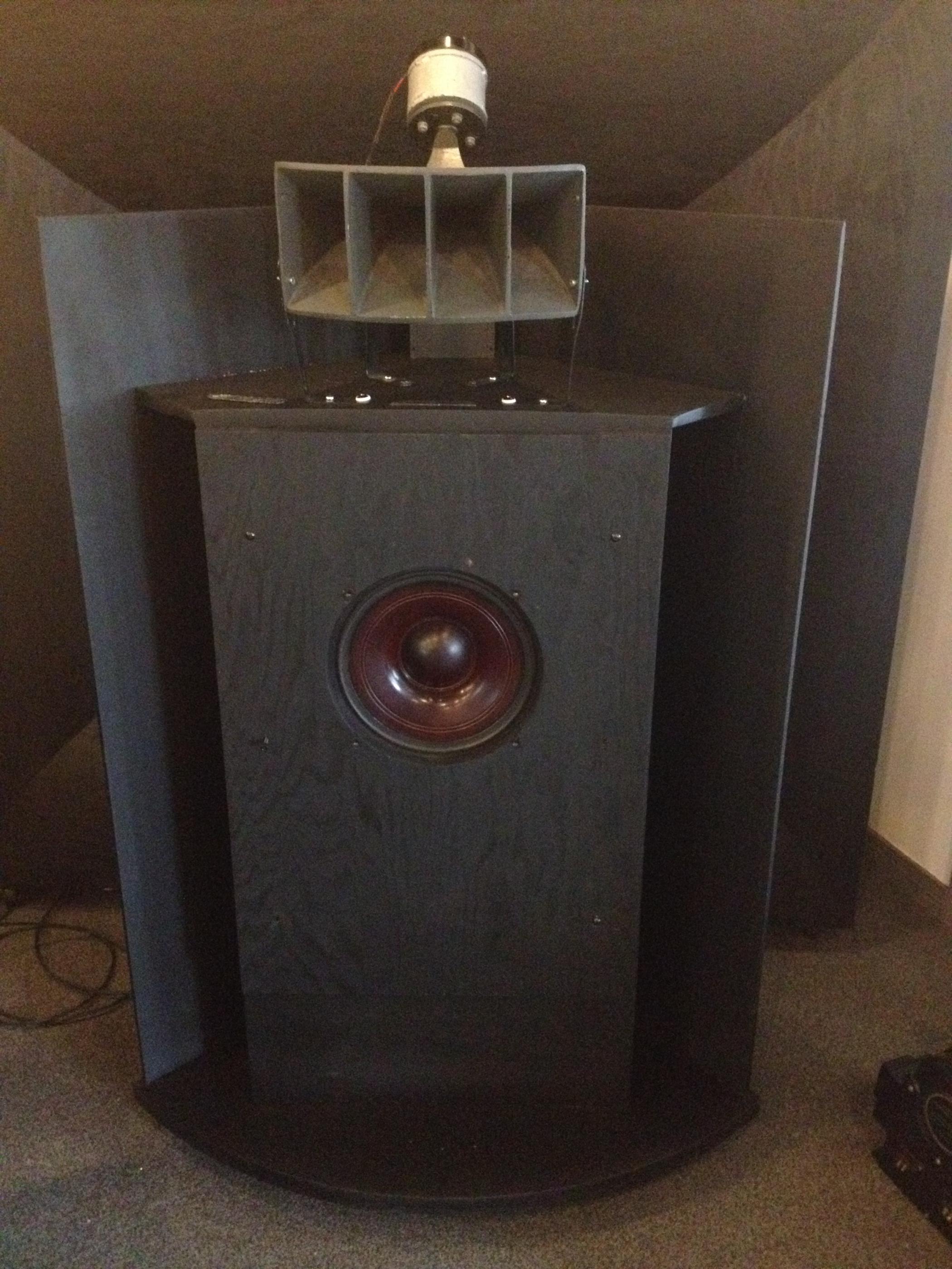

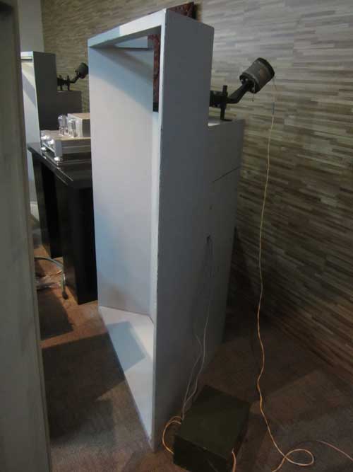

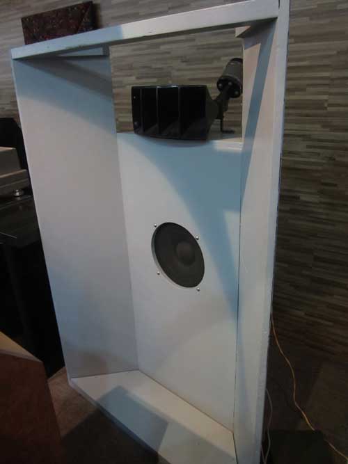

I am hoping someone might recognize this speaker- western electric L-8 system. It came from a late 40's-early 50's for western electric theater system. Altec A-7 system was made based on this speaker. Anyway I am looking for a plan of this speaker cabinet. I wanna make it for myself. Also I want to know more about this speaker. Any information anyone might have would be a help. Thanks very much.
That is not an L-8. It is not a WE design as far as I know.
It uses the horn and driver from an L-8.
The woofer in the pic is the phenolic cone predecessor to the 728B, the D173368, which was made for the US Navy.
The L-8 uses 728Bs or the 754A. Paper cone.
All of the WE cabinets in that "L series" were sealed back designs.

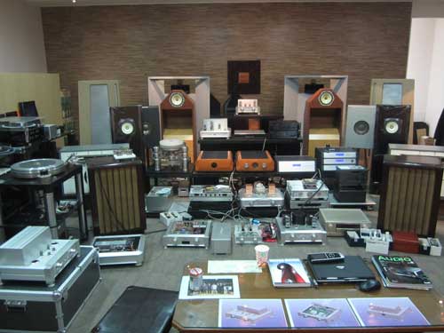

Here is a pic of the L8 in the Silbatone factory listening room...
Thanks for your reply Joe. I think you are right about woofer in L-8 system. But the cabinet of that speaker is also original L-8 cabinet. The only difference is that one was made by Westrex company. But we could call westrex is same as western electric. anyway Do you have plans for two speakers? cuz I like W.E design that you attached too. Thank you!

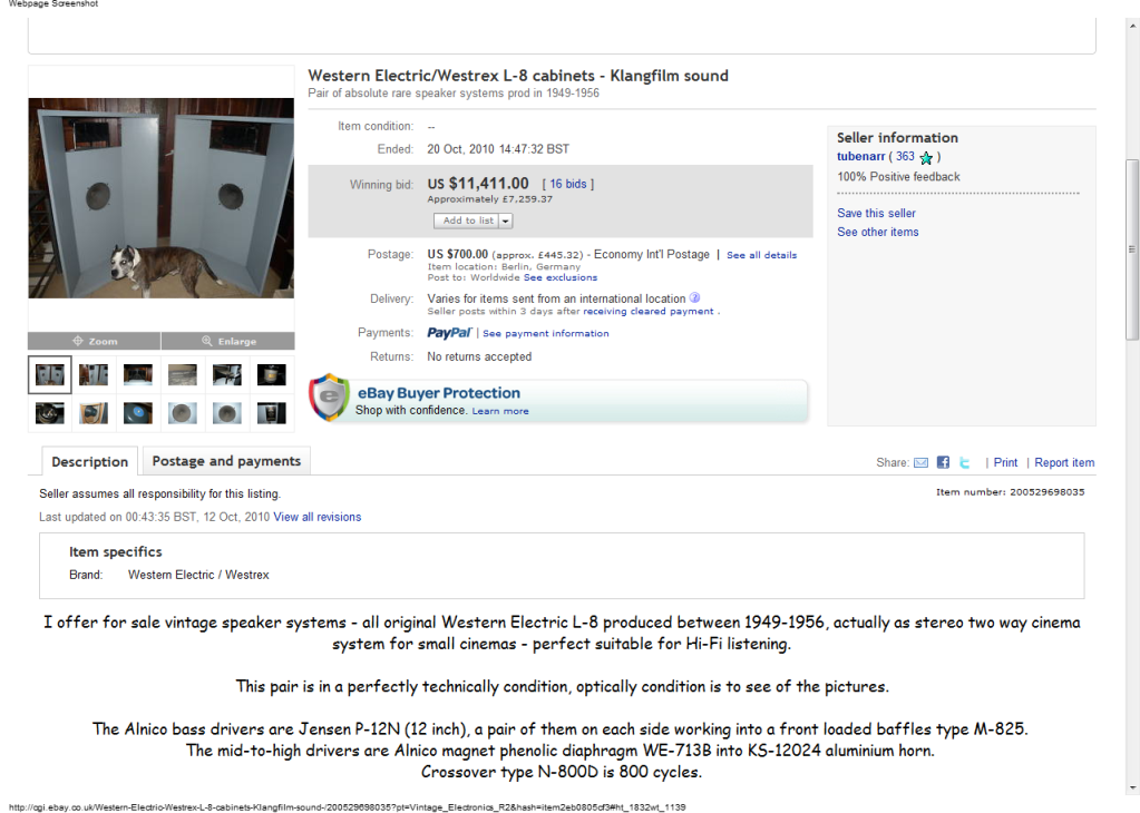

I have Westrex documents that talk about an L-8 with a Jensen P12N woofer, which WE never used, but I saw pictures of L8's with Jensen woofer from Germany and the baffle is the same as my photo.
This baffle is called WEX837 in post-1949 Altec Service Corporation literature.
Even Westrex documents usually name a 754A woofer for the L8. I don't know when/where they switched to P12N.

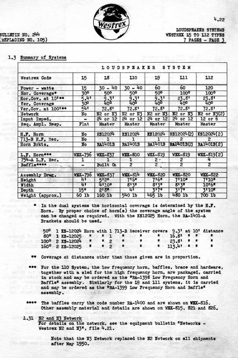

I saw that pic. But they call the baffle M825 when the 825 is an early VOT cabinet. I think that well-circulated information is WRONG.

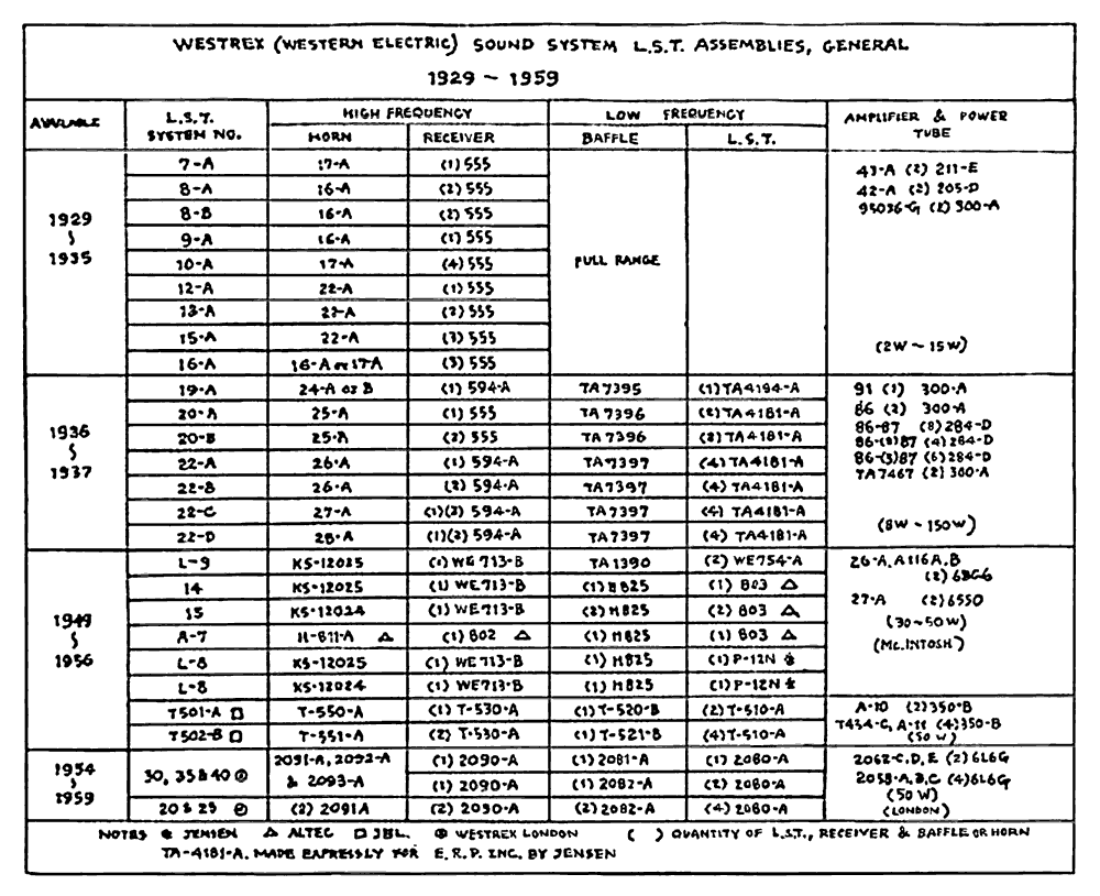

I attached the chart where I think this wrong information came from. It lists many cabinets as M825, when they are all very different! I don't know who made this chart.
It is possible that the Jensen P12N in L8 story started with this chart also but I think I remember seeing another picture of this....could have been the same German speaker in a different picture, not from ebay.
There was a Westrex system with an 825 bass cabinet and a 1005 horn but it was not an L number.
Maybe you have seen the Westrex list that is also attached. I would trust this more than the other historical chart calling it an M825!.

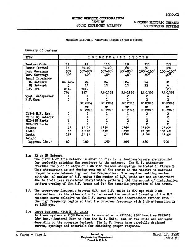

I have the same information in the USA 1950 Altec Service lit on the L series, by then referred to as Westrex. Model numbers for all parts are the same as the Westrex page.
I have not seen pre-1950 Western Electric literature on these L systems, only on the drivers.

The cabinet you posted might be a sealed box for the woofer, which is the usual way the WE 12" speakers were enclosed, and the rest is merely "sculpture." It looks like it might have side ports, however, which would be interesting and unusual for this driver!

I seems you can make a sealed box suitable for the woofer and then put the rest of that "Westrex" cabinet behind it.

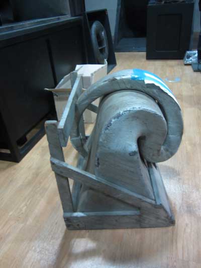

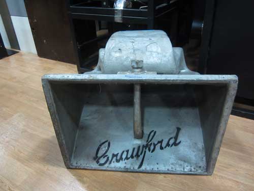

Yes KS12004 is from the 753C system. I think it's same type of Jensen 15pm woofer. right? oh I have a question for you. Could you give me information about that woofer? if you have any? Also the cabinet is a sealed box for the woofer. So I will make it that way too!
I never took the back cover off of a KS12004 woofer and I never saw the cone in front.
There were a number of Jensen PM drivers with different size magnets. I have some from the 40s that were portable movie projector speakers with very large magnets. They sound good too, although not in WE754A class for full range use.
I think the KS woofer might match some series of standard Jensens, quite possibly Jensen "PM15" of the 1940s.

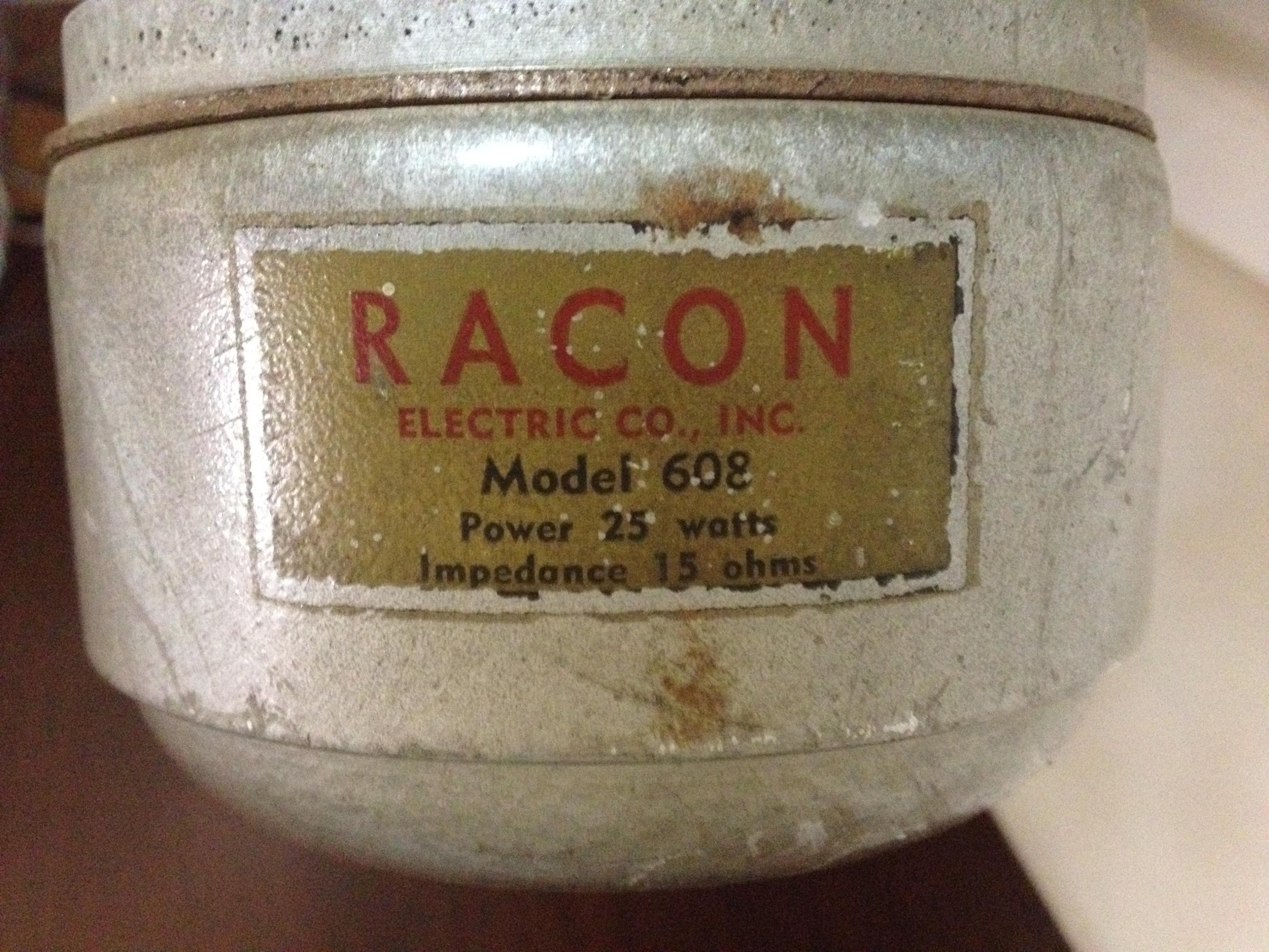

Don't know about the Racon driver. Racon was a PA gear company from the 1920s on. They made some interesting looking stuff, including some theater horns in the late-20s early 30s, but reputation among audiophiles is not great.
Here are some pictures of a crazy Racon paper snail horn from the 1930s called a Model 1. It is similar to WE 13A and KS paper horns, all mixed together!
