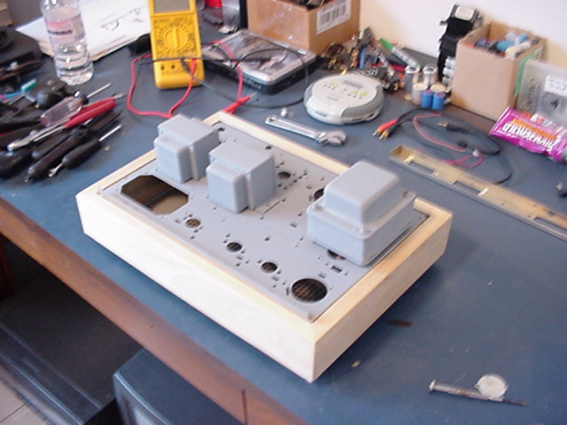

here's a pic of what you can do with it😀
saved all the part's to rebuild it. fresh wood and primer:cannotbe:

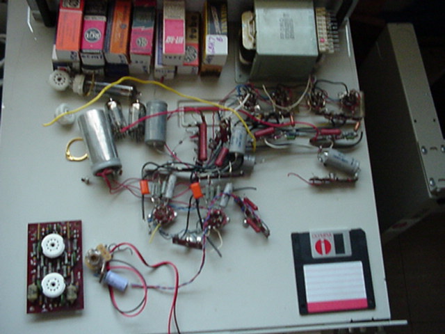

not sure about a scheme ill look around for it. for me what i did
is i took a lot of pic's of each stage of the amp so i dont make any
mistakes assembling it. next stage was drilling out all the rivit's.
for wire's any wire that was cut was cut short to leave a little
color plastic ware it was cut. that help's. should end up with somthing like this.
see pic

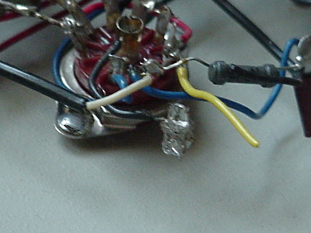

most of the ground's are like this and input and output
