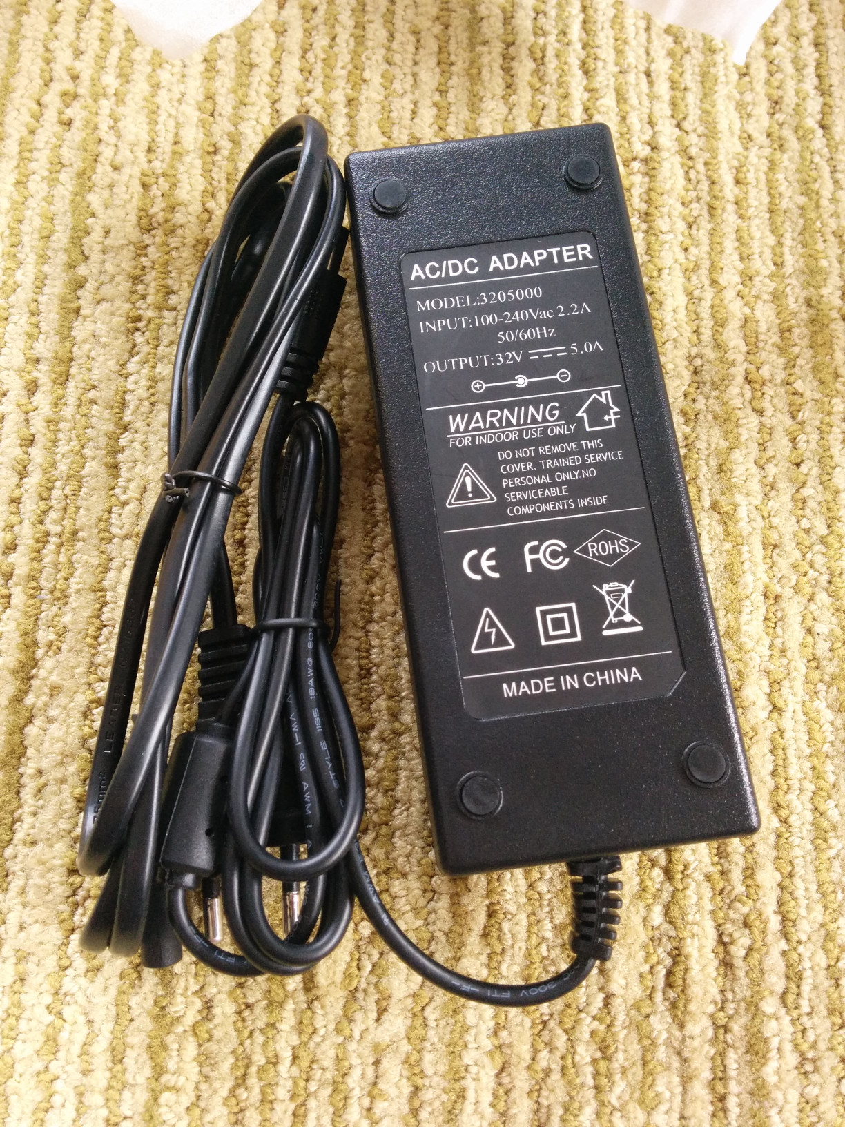

Does a mini class-D amp benefit from electrical grounding?
My current setup uses PE. But, I tried it without PE.
With PE: voltage difference is close to 0 on the metal enclosure and the metal mute switch.
Without PE: voltage difference is 1.4~1.5 volts on the metal enclosure and 81 volts on the mute switch.
It seems I will benefit from PE anyway.
Even if the power supply has class II insulation, the amp doesn't because voltage difference between PE and the amp's exposed bare metal parts is 81 volts.
Unless the amp also has class II insulation, PE is going to be important for safety.
I will either connect the amp to an earthed power supply or connect the amp's metal bolts to PE directly.

@CowCat, voltage difference of such level (1,5V and a little bit more, under 50V) is safe.
Read again my post, maybe it will clarify your thoughts.

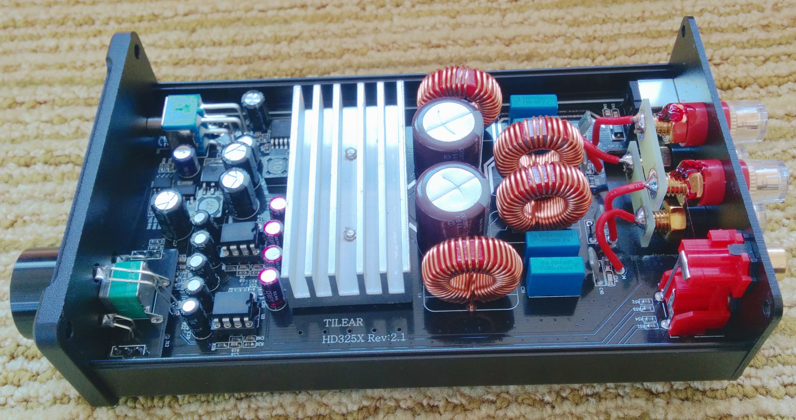

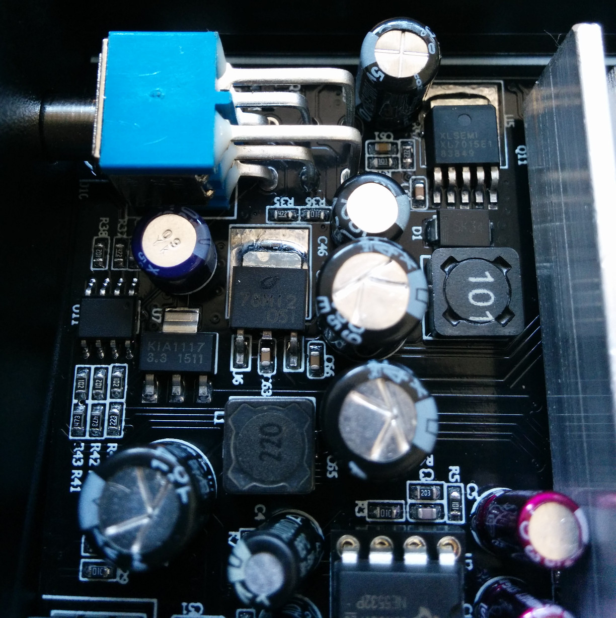

Do you have any kind of switching mode power supply in your amp (for stand by maybe)? If so, that is the reason why you have 80V difference.
First try what Douglas Blake wrote to you and if that didn't help, do what I suggested. If your socket is polarized (like UK and swiss socket), you can't do what he suggested.

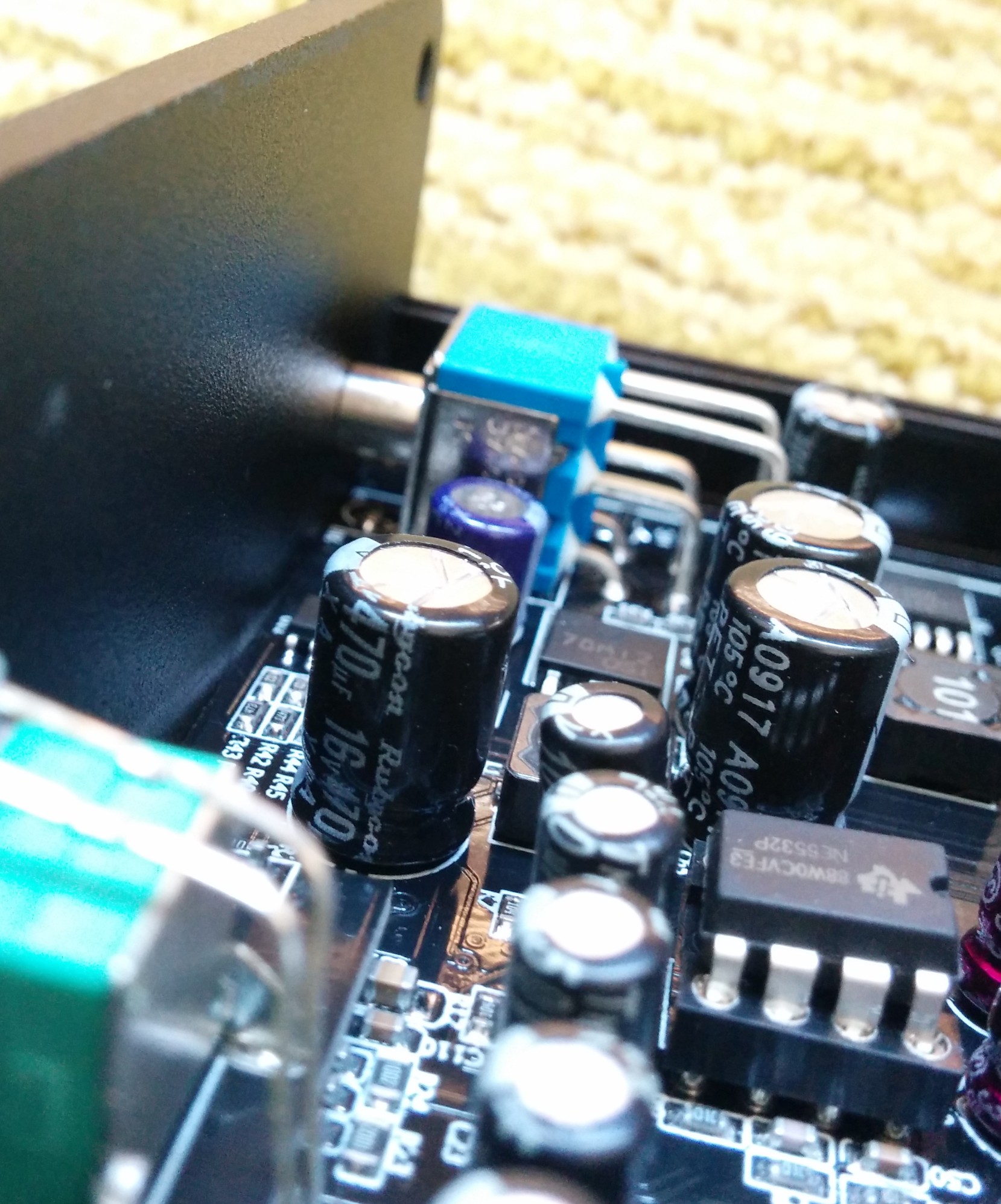

As you can see from the pictures in the first page of the thread, the amp doesn't have an SMPS inside.
Just to clarify, when the amp is not connected to PE, the voltage difference between PE and the amp enclosure bolts is 81~82 volts, and that between PE and the amp enclosure is 1.4~1.5 volts.
Rotating the power plug of the amp power supply by 180 degrees doesn't change the voltage difference when the AMP is not connected to PE.
What should the voltage difference between PE and the amp enclosure be if the amp is not connected to PE?
There are four bolts on the front and four bolts on the back. When the amp is connected only to its power supply and nothing else, the AC voltage difference between PE and the bolts is 81~82 volts and that between PE and the black amp enclosure is 1.4~1.5 volts. When the amp is connected to its power supply and the computer, the AC voltage difference between PE and anything on the amp is almost zero because the computer is connected to PE.
I think the metal amp enclosure is anodized and has higher resistance than bolts do.

You do realize that in most of these mini-amps the housing isn't connected to anything. The board slides in, the rca jacks are not connected to the case, the binding posts cannot be connected to the case and the power input jack is islolated by it's plastic housing. No connection... floating.
