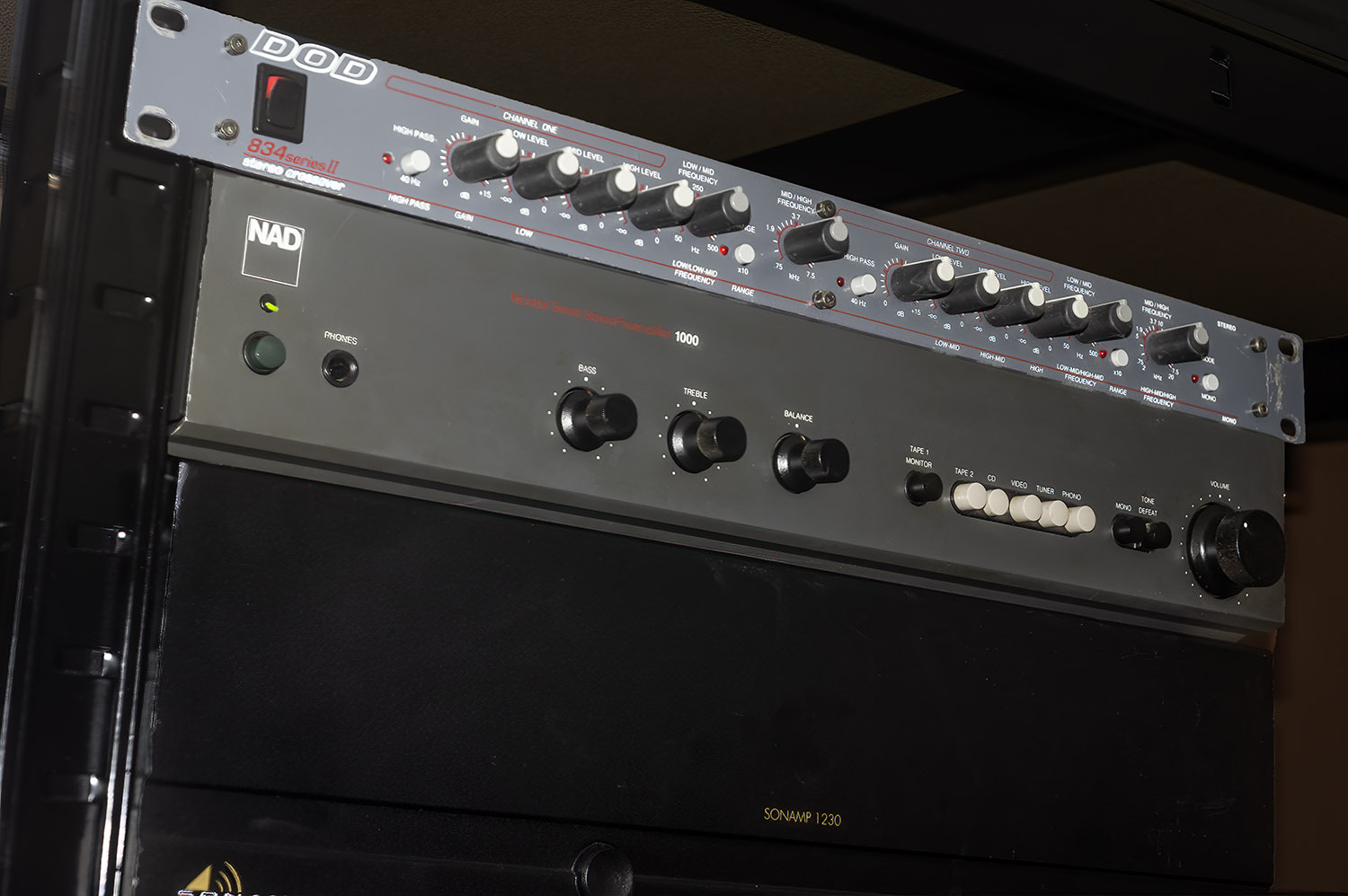

I'm having no end of trouble trying to get my new active crossover setup working.

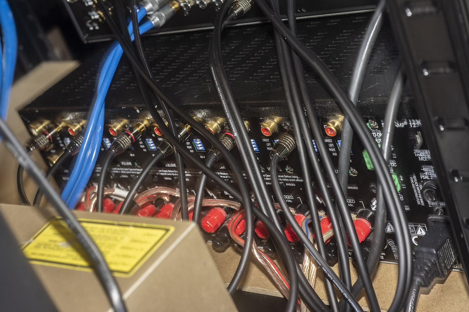

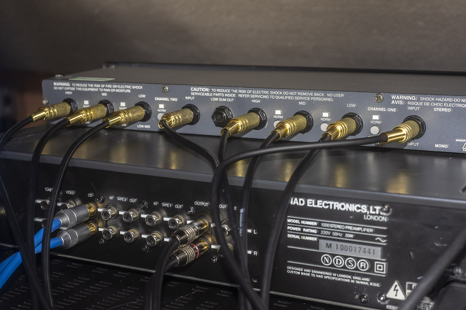

I have a NAD 1000 Preamp feeding into a DOD 834 Series II active crossover which splits the signal into Hi, Med and Low, which I am then feeding to a Sonance Sonamp 1230 power amp working in bridge mode to give 6 channels.
The problem is that when connected as below, with cables I made that have a mono 6.35mm jack on one end and a male phono on the other, I am only getting sound through one channel.
I've verified with a multimeter that all the cables are working properly.
If I press the stereo-mono switch on the front of the DOD 834, it changes the behaviour, it appears that now, the highs are on one channel and the lows on another.
I'm most confused, I can't for the life of me figure out what is wrong.

For balanced output from the crossover you are supposed to use TRS 1/4" plugs per user manual:
"All inputs and outputs are balanced. Use XLR type male plugs for inputs and female plugs for outputs. For balanced operation using 1/4" phone plug connectors, use only tip-ring-sleeve (stereo) jacks. For unbalanced operation using 1/4" phone plug connectors, use only tip-sleeve (mono) jacks. FOR BALANCED CONNECTION: Wire XLR connections as follows: Pin 2:high Pin 3:low Pin 1: ground or common. FOR UNBALANCED AMPLIFIER CONNECTION: To make an unbalanced connection to the unit's XLR connectors, wire the line connectors as follows: Pin 2:high Pin 3:NO CONNECTION Pin 1:ground. Use tip-sleeve 1/4" phone plug connectors for connection to the amplifiers, wired as follows: tip: high, sleeve: ground"

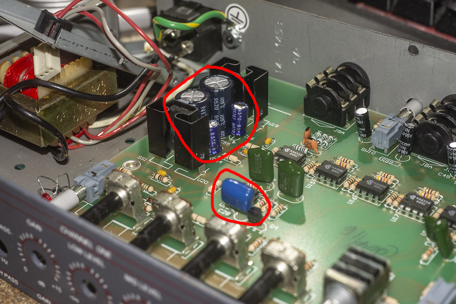

Well, the NAD preamp was faulty, but I've managed to fix that. So now on to the crossover.

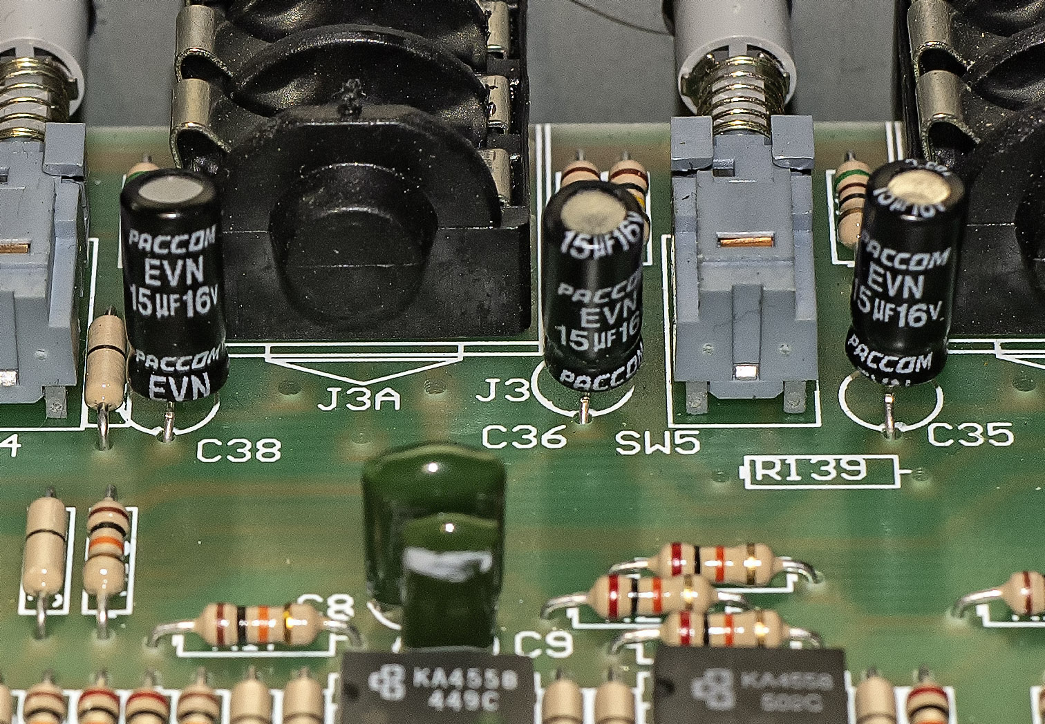

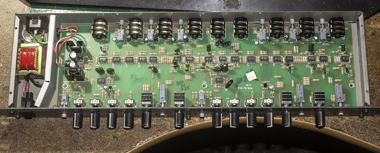

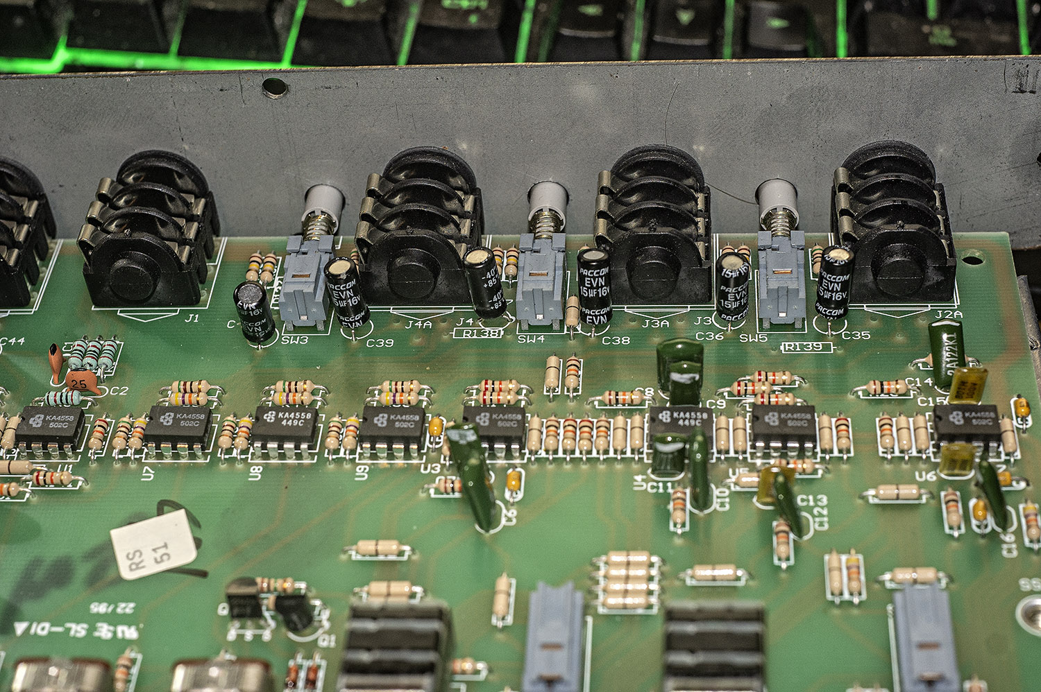

I've opened it up and replaced the four caps in the PSU, I also replaced two 1uF electrolytics elsewhere in the circuit with 1uF polyester.
There are fourteen 15uF electrolytics next to the inputs & outputs, they appear to be bipolar as I see no polarity markings on them or on the PCB, so I haven't replaced them as the only suitable caps I have are polarised.
I can't find a service manual for this crossover, so all I can think of to test is the voltage on the two rails supplying the opamps.

being an older x-over it's quite likely developed cracked solder joints to the 1/4 inch jacks i would remove the pcb and reflow the solders to the jacks.
the behavior described makes me think it's intermittent, i've been lead astray by intermittent faults...
look for simple causes before leaping to cap substitutions.
also if your running unbalanced the phase inversion switches could be a source of trouble creating a short in the inverted position, those are meant for polarity inversion with balanced lines to resolve overall system phase between adjacent bands.
and do clean those i've seen those cause signal drop out.
Cheers, I already have it apart and the pcb out, so I'll reflow the joints.
I just thought I'd replace the caps while I had it apart as it's about 30 years old and probably would benefit from new caps.
I am indeed running unbalanced, is it sufficient to spray some servisol or similar into the inversion switches and press them on-off a few times?
