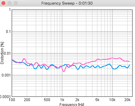

sorry here is some data from earlier testing with ne5532
Nice curves, but is there a way to do an average of those waterfall curves, and not a waterfall? There's no time or decay component, so the extra time dimension isn't as useful as is taking the average of all of those curves. That will help you to resolve low level details better and provide less error on what you measure. Not certain if that software is up to it, but a friendly suggestion nonetheless!

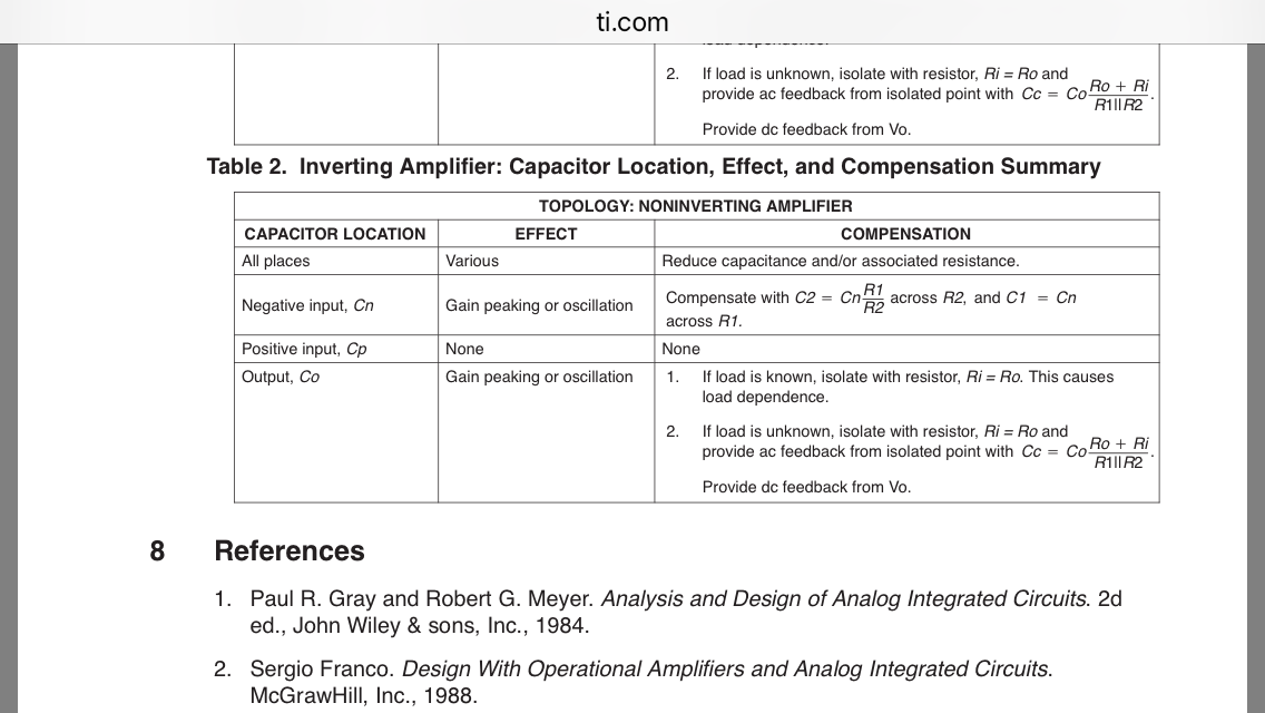

If you're using a non-inverting amplifier topology, there is an effect found with junction isolated JFET input stages that is worth considering. Basically, the input common mode signal voltage modulates a parasitic drain to substrate capacitor on each input FET, adding distortion that rises at 6dB/octave. These papers explain it in more detail:
http://www.analog.com/media/en/technical-documentation/application-notes/742022599AN232.pdf
http://www.ti.com/lit/an/slyt595/slyt595.pdf
These effects won't happen with an inverter, since the inverter topology results in no common mode signal voltage applied to the input stage, and thus no modulation of this parasitic nonlinear capacitance, so it doesn't tickle this form of distortion. However, most people who use JFETs do so for high impedance non-inverting stages, and thus encounter this problem.
There are other reasons for an amplifier to misbehave with common mode input signals, so in general, if you can use an inverter, your circuit will be much cleaner.
I had no clue. Thanks , going to re-test as inverting. That limitation should be in the data sheets.

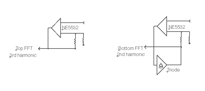

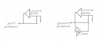

Here is a pic on one i tested this morning. Its a basic CF with feedback from cathode out to ne5532 non-inv input. 1/2 of 12au7 is used (as output). Distortion is almost at noise floor of my setup. Really only one resistor is required, the cathode load. ferrite bead is on gate. +-15 to +-24 works. The 180 ohm resistor is a protect for sig gen. I’ve destroyed two of the subminiature tubes while testing opa445, tl071 and Op275.

Just have read the full text of those links. I had this one in my library and glanced over a few years ago. Should have studied it.
http://www.ti.com/lit/an/sloa013a/sloa013a.pdf
I re-tested using inverting inputs, much better now with only one 22pf cap needed and distortion is behaving as expected.

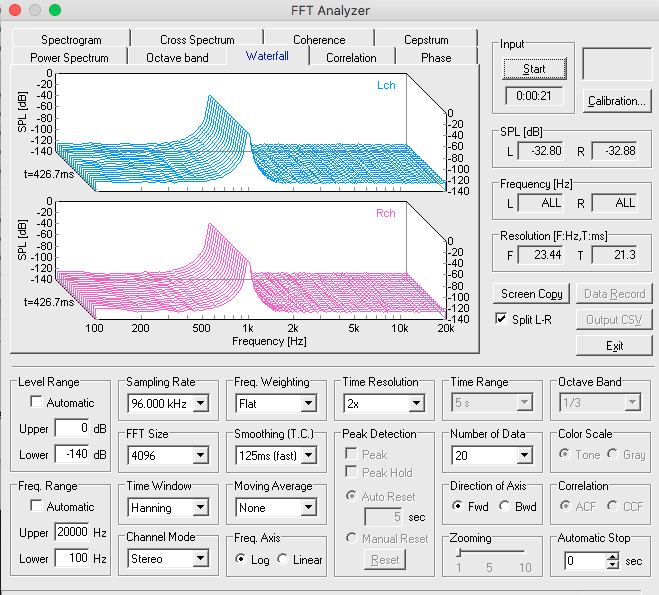

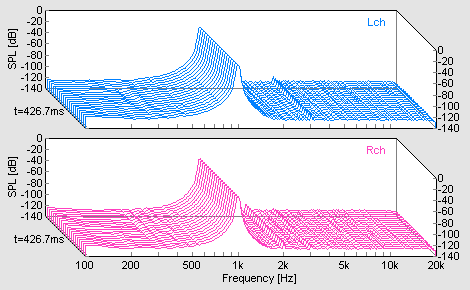

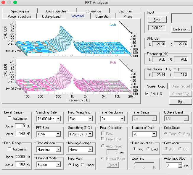

UR22 based audio analyzer
I did a set of external hardware loopback runs, the file names in zip file file detail settings. The waterfall previous was 250ms avg. I did a 125ms and 250ms waterfall here. Also thd, and freq response. The system is OSX High Sierra, Yamaha Steinberg UR22 USB sound interface, external cables line 1/4 jack to BNC. The clip leads are all connected together at cable ends. 96khz 24 bit word. Let me know if questions on settings or problem with zip file.

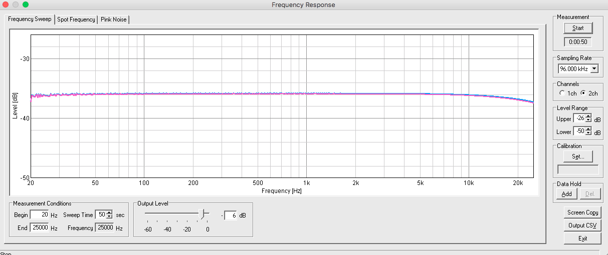

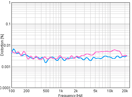

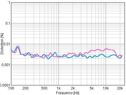

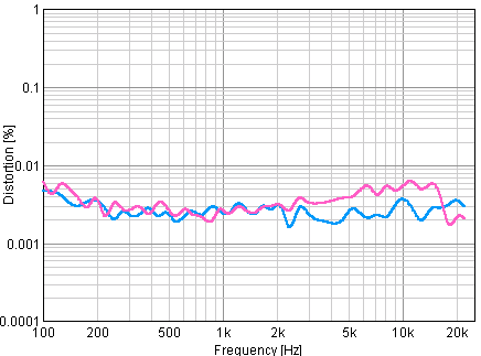

Well did more testing today with the goal of replacing all op-amps in my Hafler DH100 pre-amp with DOA/Composite type 8Dip packages each utilizing a 12au7 'riding high'.

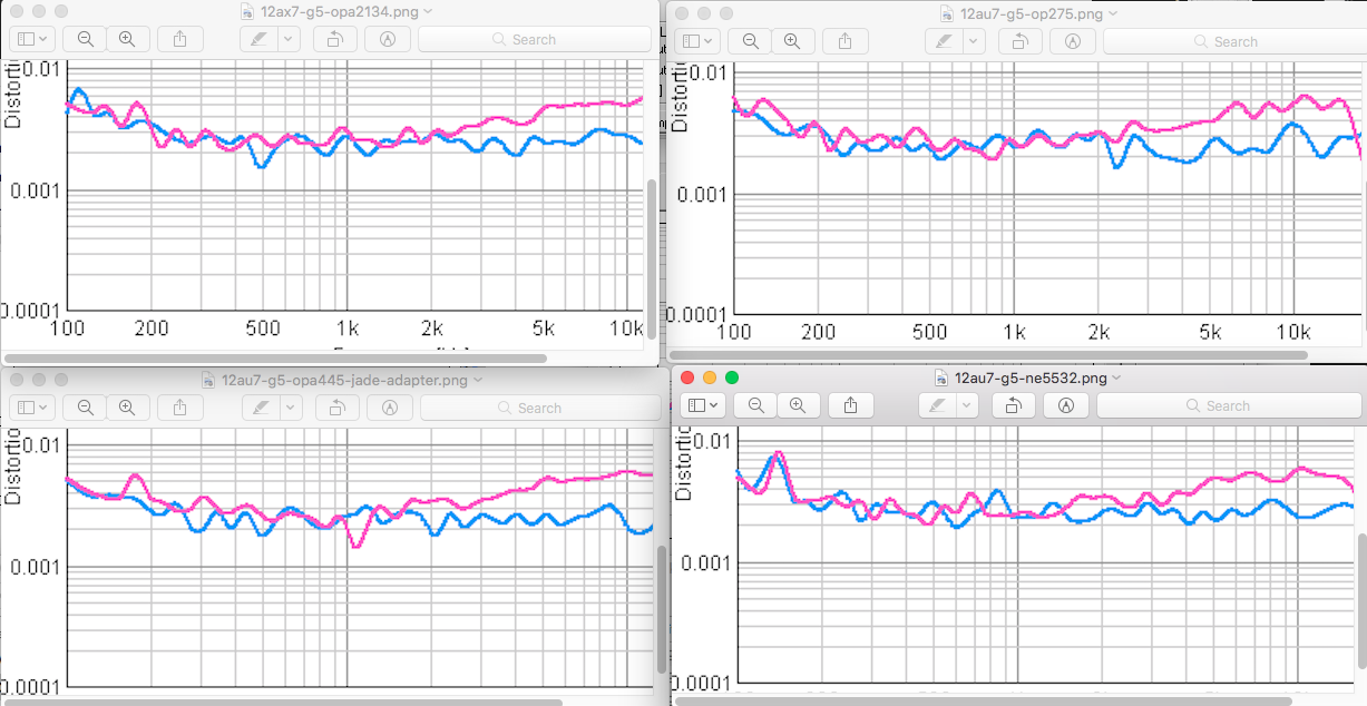

Here are some pics of the various op-amps tested. A 12ax7 works fine but less output swing unless cathode resistor is matched. I get a minimum of 15Vpp out with the 12au7 running at +-15V. I tested gains of 1,5 and 10.

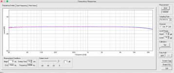

File names indicate which op-amp is used. Blue line is system baseline and magenta is DUT.

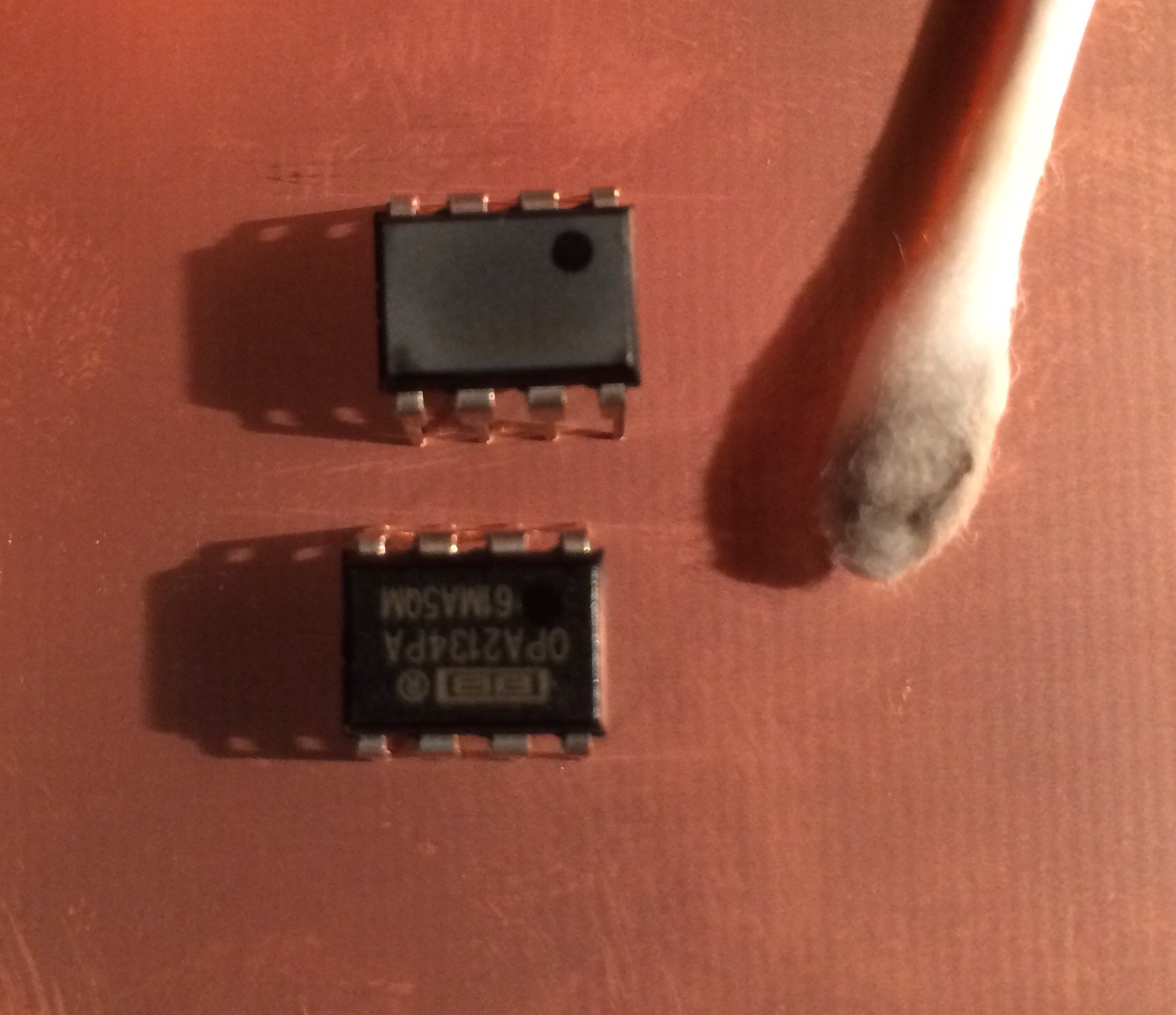

in the pic on previous post containing four plots, the OPA2134 has been found to be fake. Lacquer thinner used to remove fake laser marks.
Odd they turned out to sound great and are installed on some of my hi end eqpt. I've been using them for some time. No fails yet.

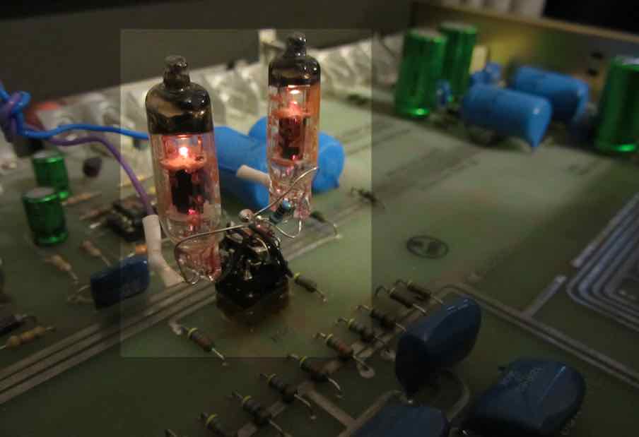

Shown in DH100 using stock board, no changes, same ps but you can see wires for triode heaters. The original DH100 op-amp is TL072 on rev 1 units and ne5532 on later models. The prototype is in IC4 active 'tone' circuit of dh100.

All the distortion plots you showed a couple of posts back are fine - but do show distortion levels from your composite valve / opamp that are an order of magnitude higher than the op amps would present by themselves.

Dont kno. It sure sounds great.
The ur22 has a thd floor of .005 - .003, so i would need other test equement for a real dist evaluation.
But you are very correct , its not only distortion that defines good sound.
So this example uses a nullator (op-amp) of your choice and the norator ( a triode in class A).
The nullor block is 8 pin dip housing (twin sections).
This is the more demanding challange compared to a single opamp or one of the pro audio module footprints.
A single stage triode cannot achieve thd levels ( in previous plots) without the op-amp.
An op-amp alone cannot sound as musical as a triode.
Next I'll do a novel 9 pin type prototype (12au7 ) etc but wanted to do the twin minature first.
