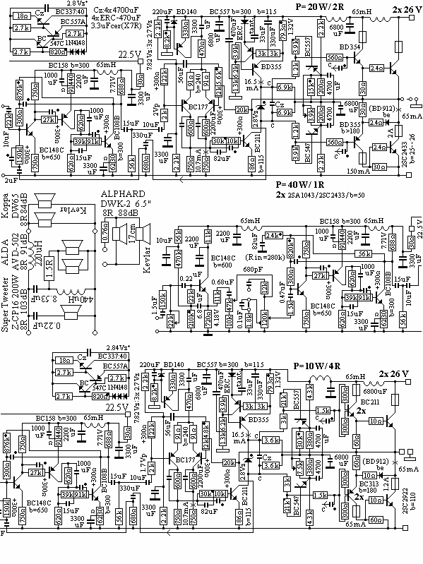

I have given on this forum just normal things that are in this world, full-clean amps.
P144W+15dB=810W -32 speker, (stereo)+18dB ---P=1140W -64 speker, stereo---P=1950W(2xP=144W).
