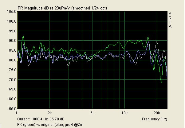

I had a couple of Wayne Picquet refurbished treble panels over in my shop and did a frequency response measurement. See the attached image, the green line is the Wayne picquet panel and the grey and blue ones are original Quad panels.
What can be seen from this measurement is an overall increase in output (sensitivity), which is to be expected for a refurbished panel (about 3-4dB), but also a significant increase in output above 5kHz which is rather strange. I can only assume that PK did something to these panels (I measured two and they showed the same effect) to get this.
I auditioned the panels and so did a couple of friends and (no surprise here) the speakers with the PK panels sounded rather 'hot'. Some people may like it like this but to my ears it's not an improvement. I prefer the original English layed back, neutral character.
To prevent confusion, this is the original Quad ESL 57 I'm talking about, not the ESL63.

Measuring on Axis alone will not tell the full story , worst case for a linesource, panel type speaker ( avg response will tell you a lot more ) . PK panel has more on axis energy than the original and due to such will require less to no toe in vs standard quads . 2 much toe and they will sound hot ..
On the other hand the original panel will sound dead off axis and lack any high frequency detail
This can be offset by running more toe and if any cables , wiring etc was updated to compensate for such , would make the newer panel sound "hot"
A-J,
If that's his decision by design then fine. But why mess with something that ain't broken? The Quad ESL in it's original form has an excellent balanced neutral tonal character. I'm not saying they are perfect speakers, they have plenty of faults, but tonal character is not one of them. In fact it is the foremost reason people love this speaker. Messing with the panels to give more high frequency output does not gain you anything.
I'm not sure what he does , to my understanding his upgrade does not Modify the panels FR, but is geared more to improving power handling and dynamics ...
Tastes aside , the PK panel response shown is the better FR from a design point of view IMO....
I don't think I could disagree more. I guess we have completely different views on speaker design then :boggled:

The original Quad has a very "polite " frequency response and an avg FR would have shown how dead it would have been vs the other .
Did your friend have the bass panels done 2 , if not this might be the imbalance you are describing , as i have to agree with Calvin here that the original 57's stock are barely listenable.

Recently I bought some 3.5 microns Mylar to try on my ESL. The measurements from this ESL look quite similar to what you've got from PK ESL. The frequencies beyond 5kHz just jump up like that. The sound is hot (sometimes harsh) as you describe.

A rising output with frequency response will sound sometimes harsh, but always unnatural. This is because nowhere in nature we experience this. A slightly downward slope is something very natural and we associate that with distance, since high frequencies are damped more than low frequencies by the air.
In scientific studies done (by for example F. Toole), blind tests point out that experienced and inexperienced listeners prefer a flat frequency response.
