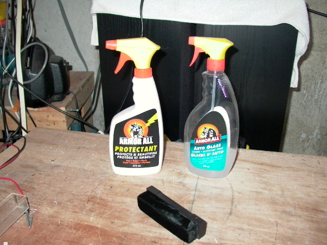

I do, I already waxed most of my vinyl, because it sound good. the idea come from the first step to make vinyl is cut on a wax plate, a very very thin layer of wax on the top of vinyl will lubricate the needle as well reproduce same condition in cutting, I did try a lot of material for this purpose finally 10 drops of car wax to a bottle of car window cleaner(picture 1) shake well make it milky from clear will do the job. I use my home made vinyl cleaning machine (picture 2) for application, let surface wet through with wax solution brush it for a while, use paper tower clean the solution out, and polish by a vinyl vacuum machine(picture 3), you will have a brand new vinyl looking .

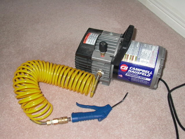

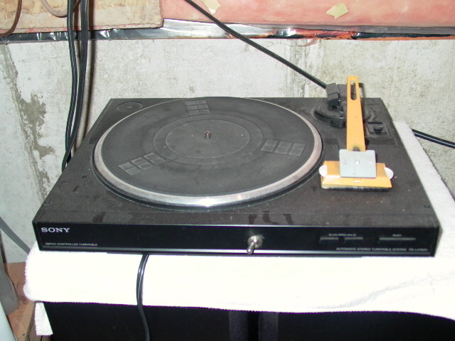

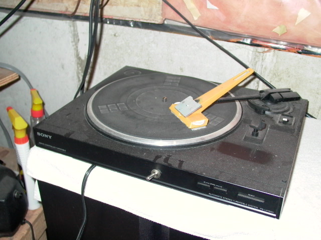

Wax is the second part of it. cleaning first, my home made cleaner is a cheap turntable ($20) with tone arm, take off the head shell, place with a pad brush and add weight, liquid, I use same car window cleaner without wax. after brush, I use a portable air compressor to blow the liquid off start from inside to outside , but the blow gun tip has to be a very small hole for stronger air flow. next is wax, but do not blow off the wax solution use paper towel . first paper towel off the most ,you will see white wax remain on, second flesh paper towel clean the rest by press down, and then polish by hand or machine

Automotive and household window cleaners have Ammonia in them, and they react badly with plastics.
Use some inert dilutant, like water or something.
If you want to try something, give Armor-All a go (silicon based will really let it slide) or even better Rain-x Original Glass Treatment

Where's the wax? Armor-All is not wax.
John
sorry I can not give you the answer some white stuff remain in the disc from Armor-all mix, that is, I don't maid it is wax or not maybe I am wrong end up with the listening result that is good for meWhere's the wax? Armor-All is not wax.
