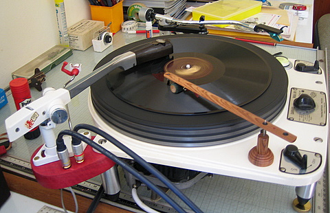

I still keep a sizeable collection of 78rpm shellac records and besides the usual Carusos, Giglis et al, I have ol' Al Jolson, Dinah Shore, Elvis Pressly and many other interesting recordings.
I've played them off and on for years and even diy'ed a Micro Seiki MB-18 for this speed.
I recently bought a 50's Garrard TPA12 arm and must say, I bought it only for the Garrard cream colour...
It was dirty and corroded and of course wired for mono and came fitted with a custom cream Shure Headshell.
Getting into the swing of things after refurbishing the arm, I thought, well go the whole hog, ya know the SPU look.
I had a 3-pin brown bakelite 'shell bought new with a new ceramic cart fitted.
Over the weekend, I turned an extra cart pin for it and made up a new 78rpm stylus in sapphire which I fitted to another nos Shure SC35C broadcast cart.
The hard part was making another mini armboard for the Garrard as I decided to run it with two arms.
Anyway, the job got done and here's the result
bulgin

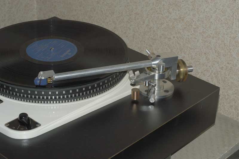

Gosh, I remember an arm like that school! You really need some mass for that 301, though. I made my plinth from a sandwich of MDF and lead flashing, used a planer to get the edges flat, then covered it with black Formica.
I like your wooden "Dustbug."

The plinthless one is often transported hence no plinth but I will get round to doing a plinth for it. Nice arm you have there. Is it a Schroeder diy?

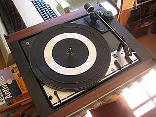

@ Leadbelly, here's a pic of my Dual 1215 which plays 78's too.
I have a number of brandnew ceramic carts and perhaps someone here will explain how to rig them for playing in a modern setup.

Ah, yes, a 301 on a proper plinth is a transport nightmare. The arm is a unipivot to my own design.
http://www.diyaudio.com/forums/showthread.php?s=&threadid=10171&highlight=
I'm very impressed by Frank Schroeder's arm design.

Well as it is Sunday I had quite a bit of time to work on my Dual 1214 project and it's coming along quite well! When all is said and done it actually might be a better TT for LP's than the cheapo JVC I use now 🙂

Thanks. Do you know of a comprehensive source for 78 eq cap & resistor values for opamp preamps? I found Rod Elliot's site, and what I didn't like about his Project 91 http://sound.westhost.com/project91.htm was that it was too generic. I also found Roger Wilmut's site http://www.rfwilmut.clara.net/repro78/cct2.html which does have a comprehensive list of eq cap and resistor values, but it is for his discrete preamp and I am unsure about applying it to an opamp.
The Dual 1214 will be my 78 TT. It has a Dual DS630 cartridge with flipover style LP/78 stylus. I am thinking I will make a dedicated 2 channel 78 preamp just so it will integrate much easier with everything else. I believe the Dual cartridge just outputs the identical signal on both L & R.
EC8010 said:
A cartridge with a turnover stylus is almost certainly ceramic. Why not fit a Shure M78 (magnetic specifically designed for 78s)?
Hmm, that's goes beyond what I was hoping for in my project budget, but I'll think about it. The 1214 TT is actually higher quality than my JVC LP TT, but it has no strobe, so I think I'll dedicate it to 78 service.
