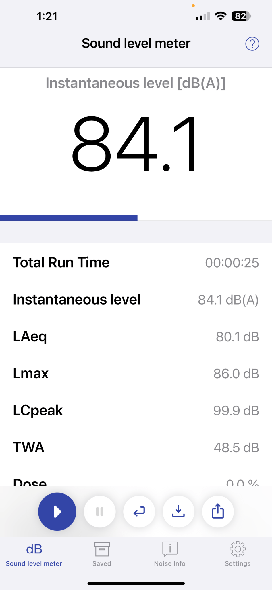

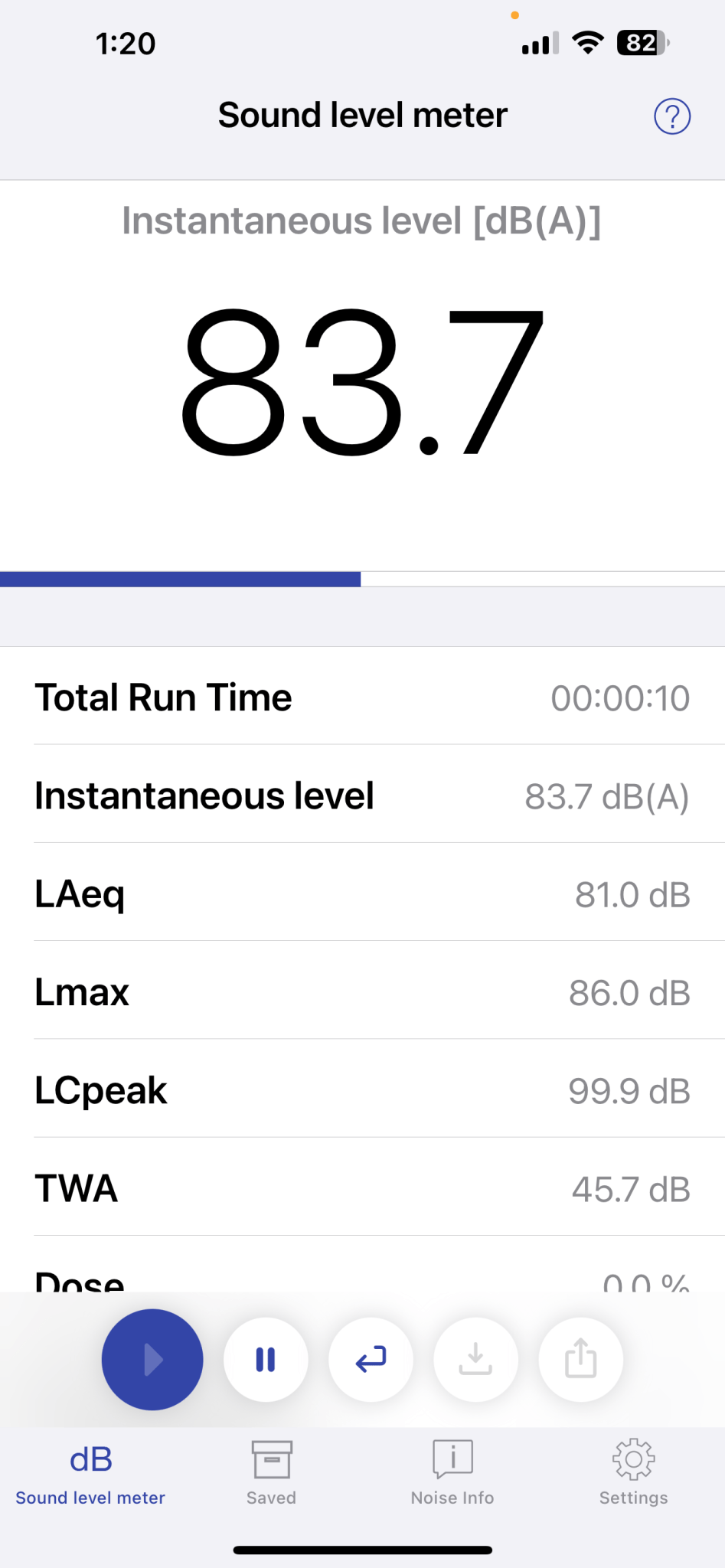

Sorry that I was unable to articulate better. The image (attached) shows spl level about 3 meters away. Room is 12ftx12ft. Volume pot is about 3 a clock position. What I meant to say is less signal attenuation. I feel like I am getting more of the sound. Usually you have to crank the music up for more detail, but in this case, I feel that I am getting more of the signal without higher spl. Less room reflections that way. I assume you are an analog person, not sure how to test this. I hope this info is at least as interesting as wood cable risers. 😁

Started at 2vrms, full blast on ACP+. Had to turn the pot to 9 a clock. Changed it on the fly to 1vrms. Turn the volume to 12 a clock. Load, but more detail. Eventually, I turn it all the way down to the 200mVrms, and suddenly I really start to hear that elusive low volume listening that people talk about. Volume pot is close to full at this point, its loud, but not extremely loud. The sound information is there. Bass is not impactful, but it’s there.
