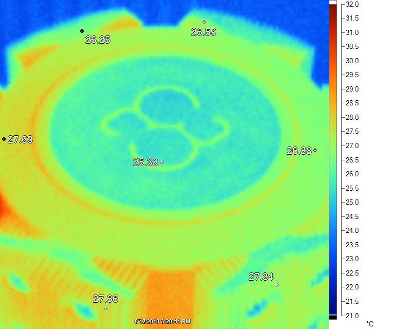

When using an IR temperature device, be that a camera or just a plain IR thermometer, you have to take the emission correction factor into account.
If you put in a bit of effort to do so, you can get reasonable results with an IR thermometer. It does however take that you read the manual, and understand how it works, to get anything useful out of it.
A while ago I bought myself one of those Fluke thermal imagers.
As mentioned earlier in this thread, such a device sure makes things possible, that we could not even dream of being able to do without.
Partly it works wonders when building amps, but just as important is is pretty much a miracle tool for finding broken/dying components in a circuit.
Thermal imaging equipment also have many other purposes, like finding moisture in a building, or checking the isolation of the house.
Lately I have even used it on the car, as the coolant system was acting up.
I think as the thermal imaging cameras gets cheaper, we will see them become quite popular, it's a wonderful tool.
Btw., Fluke sells a reasonably good IR thermometer at the moment for less than 100$, that is well worth the money.
Magura
EDIT: Added an image of an amp I made a while ago. It shows how small temperature differences a camera can measure. Note that the entire amp is within less than 1C, but the variations are obvious.
