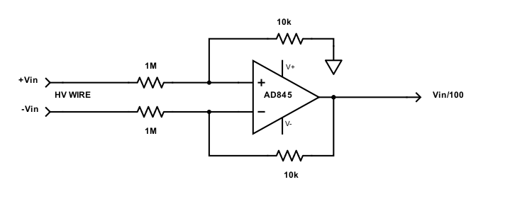

Here is a simple HV diff amp that can work quite well.
Keep the two input leads close together, or twisted.
Use a ground plane, plastic case, and HV test probe wire for the inputs.
Multiple, series resistors for higher input voltages that exceed the
voltage rating of the input resistors should be used when necessary.
Thanks, Rayma.
Filed in my (large) future projects folder!
