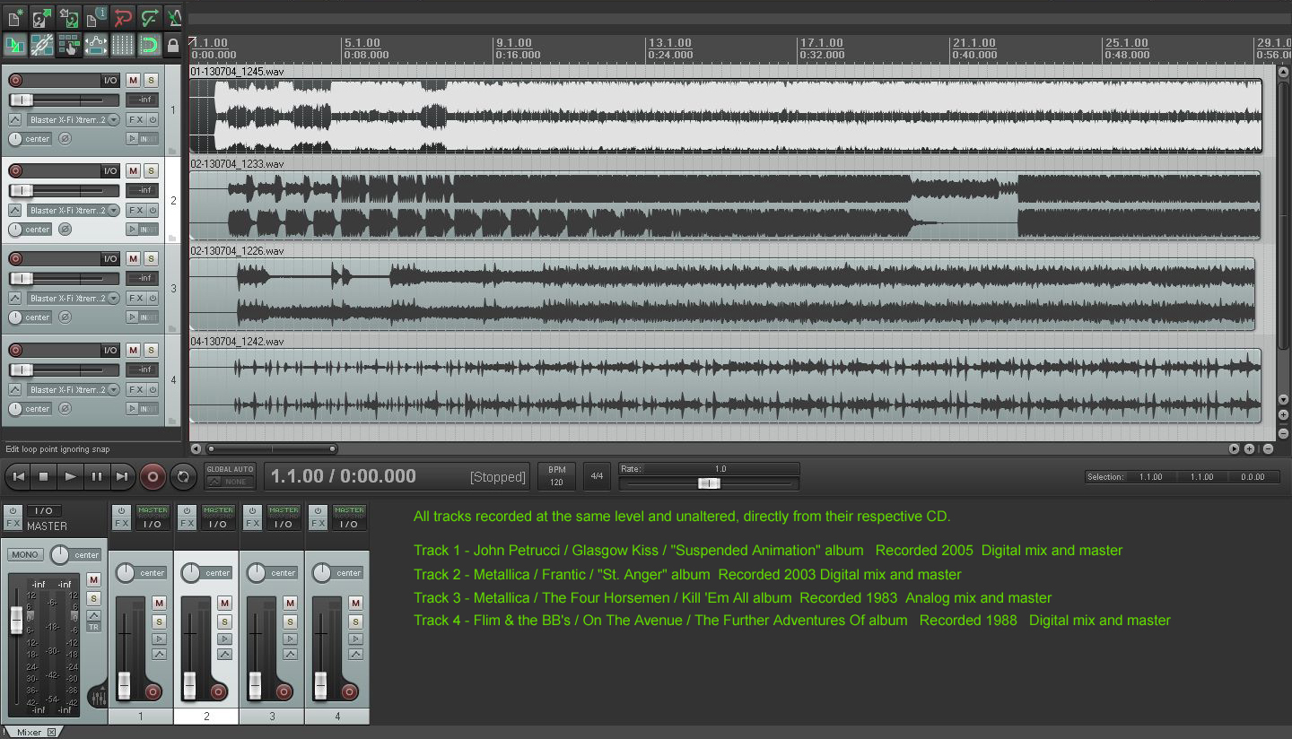

Here is one place to go to get an indicator that isn't subject to audiophile opinion:
Album list - Dynamic Range Database
This database won't necessarily tell you if some recording "sounds good" or not, but it will tell you if a recording has been compressed to an overall DR rating below ~12.
I've found that all recordings below this threshold, i.e., a DR rating of 12 for the album, have shortcomings--almost without exception. YMMV.
The idea here is that if the dynamic range of the album is squashed the entire recording has probably been irreparably damaged in other ways. Note that my view is "do no damage" from the musician's creation, not from the idea of fame for the people that are charged with recording and producing copies of the music for sale.

I think both of the above are a good way determine if a disc suffers badly from the loudness wars. If you have never used a digital audio editor then try Audacity which is, I think, free.
I use cool edit pro (now Adobe Audition?) and can easily rip and view any track from a CD.
Lets start returning any CD that is compressed to nothing!
