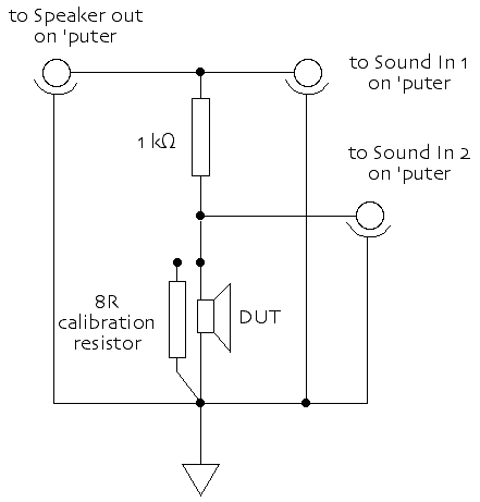

@dave - you lost me when you said these T/S parameters are not always measured using a low Z signal source and that you have several high Z signal sources specifically for the purpose of driver evaluation. As I respect your status as a well seasoned speaker system designer, please explain.\
T/S can be measured with both a voltage souce or a current source, but using a current model seems to be the preferred method.
K can’t find Brian Steele’s method of manually measuring a driver, but it uses a large R to make a voltage amp (and it has to have a stiff PS that doesn’t sag) act like a current amp.
I used a simialr circuit with FizzMeasure.
attachment.php
And then S=L WT2 which comes with a dedicated USB in current amp. And it actually uses the same algorithm as Steele outlined, instead of measuring the impedance curve and guessing the patameters as many products do.
