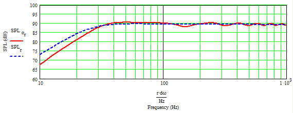

I started playing with the worksheets. Way more information then I know what to do with. I'd have to say the thing that stands out most to me, is how important damping is. Finding the correct density is just as important as the form of the line itself.
Here's what I have thus far.
fs 25.5hz
vas 133.1L
re 4.16ohms
qes .28
qms 4.57
sd 510cm2
123" long
- 47" @ 1.5sd w/ .5lb stuffing
- 38" @ 1.09sd w/ .5lb stuffing
- 38" @ .44sd w/ .333lb stuffing

GuyPanico said:Here's what I have thus far
Usually there is no point building a line that doesn't do as well as the sealed reference.... try shortening the line & making it fatter.
