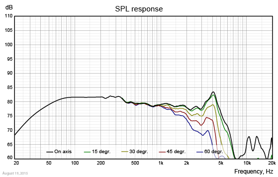

When I look at FR in a program like WinISD, do the T/S parameters for a driver help model the low end FR/Rolloff, or is the program assuming a flat-ish response driver and the box response is more of a contributor to low end roll off?
For example, when I take a driver, the manufacturer FR is this:

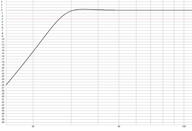

And when I do a basic modeling of that driver in an enclosure in WinISD, I get this:
So, at 25 hz, the driver in free air is down almost 10db from 100 hz, but in WinISD in a vented box example, the reponse is down only 5 db.
What's closer to reality?

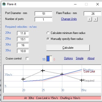

The reason this matters to me: I'm looking at port velocity in a flared 2 inch port, and WinISD and Flare-It show I'd be in danger of chuffing at the power levels I anticipate, but at VERY low frequencies, like <35 hz. So I'm wondering if the port and driver will really be as excited below 35hz as WinISD models, or if the driver's roll off down there will make it lower than predicted?

Manufacturers measure the FR by mounting the driver on a standard square baffle (IEC standard, I think 1m x 1m). Infinite baffle would be better, but not practical.
A correctly built enclosure would realize what WinISD predicts.
The software predicts the LF response base don T/S.
They are accuarate up to the mass corner or so and typically do not include the actual response of the driver.

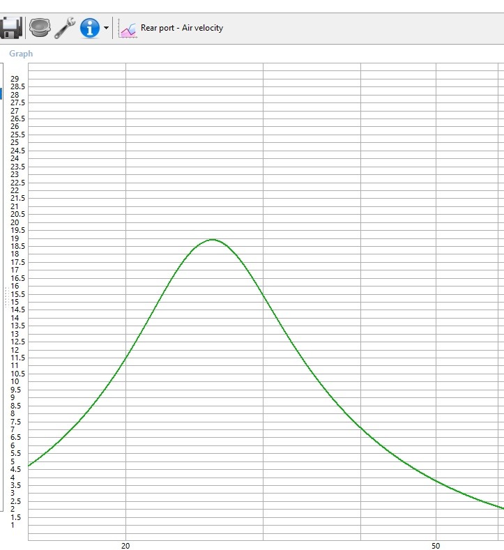

Default leakage or Ql for WinIsd is 10
7 being more realistic so that will drop port velocity.
can be changed in advanced settings
Port efficiency or Qp be 100
can drop that to 90 or 80
Velocity also go down.
Using Max SPL setting just applys full thermal power you enter
in the driver info.
So if your looking at port velocity with max SPL ,it is higher
than real life. since very rare youll get full thermal power into
a speaker
I just enter power manually till it starts hitting xmax
Below tuning or Fb. Basically look at when the unloading
hits Xmax
Then look at velocity. it usually will be lower.
18 to 20 ms usually acceaptable for velocity.

Kind of a design influenced by Carmody's "Burro" or "Turtle" design. Had to alter dimensions to fit my situation, and then the driver too, since an 8" wouldn't fit the baffle size I need. Carmody talks about being concerned about port noise with his Burro design using a 2" Precision Port (even with their flares, etc). I read enough to see that many think my port velocity would be acceptable for most designs/situations. But then I came across Collo's info and Flare-It program.... And seems his research, even with some padding for seating distance, masking, etc..shows that a 2" port with flares and all will chuff at 11 m/s and 15 m/s at 25 and 30 hz.
In my case, I'm front porting, AND putting a cloth grille in front of the driver and port. So I have risks of chuffing at low frequencies, AND trying to oscillate air at high velocities through the grille fabric... that was making me re-think my port choice. So I wanted to confirm that the WinISD port velocities wouldn't be way off, and that the driver response modeled would be close at LF. Interesting on the advanced parameters one could alter in Win ISD...moving port efficiency to 90 didn't change much.
So, I'm looking hard at going to a 2.5" or 3" port instead of the 2" model shown in my port velocity screenshot above. I have about 18" of internal depth, so a 2.5" port could be 1 port diameter off the back and be right about where I want it tuning-wise....but still might have some chuff risk according to Collo's program. A 3" port I'd have to start adding bends, but it is possible to fit.... but also starting to worry about port resonance there coming under 300 hz.... The 2" port peaked at 19 m/s, 2,5 at 12 m/s, and 3" gets me down to about 8 at these power levels.
