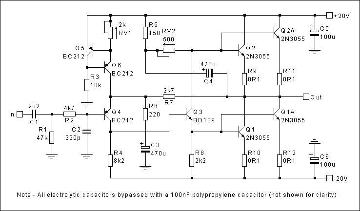

I put a schematic, a class A schematic that simulates very well and i will assemble.... but 30 watts in 4 ohms is less than i want.
So, when i reach distortion i want this amplifier to switch to AB... this way the power will increase.....in this moment a reduction in input signal to prevent override.... and same time another output is conected to the 30 watts class A amp (Already switched to AB) and this output have higher voltage on their output transistors....

Hi D-x Carlos,
You should look for the updated version with two ccs. The version that you posted RV2 is rather difficult to get in good quality it needs to be around 2watt or above. I think it was said that this circuit can not will not work in class ab, I may be wrong here...

If I understand correctly then you'd like to build something like a class G amp that runs class A at low levels. You will need a complementary design if you want to do this.
Meyersound uses such an amp with their X10 active studio monitor.

D.Selfs class G amplifier can be configured to
class A with rail switching at class A "clipping".
🙂 sreten.

D.Selfs class G amplifier can be configured to class A with rail switching at class A "clipping".
That's a worked-out example for which even PCBs are available! I don't have a scanner unfortunately but maybe soemone else does, who has the respective issue of electronics World.

Or the place that sells the boards
signal transfer uk
Maybe the inner transistors could be biased up to class A. Poke around, This guy has lots of good reading material.
