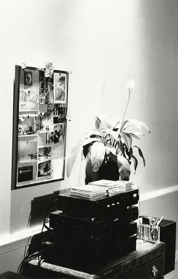

We're not getting near answering the Mundorf question here, but I can relate my experiments with three capacitors in a simple 2.2uF + 47K resistor highpass crossover to a metal dome tweeter. The lowpass was just an inductor on simple little Mordaunt Short compact reflex speakers on stands. Here's a ca. 1997 photo to prove I don't make this stuff up!
This was a very good front end of high-end Rotel preamp and power amp, my current RCD-965BX but iced with an expensive Rotel DAC. The DAC brought a stunning bass register and a silky top end. Wish I still had it actually.
The music was Karolina Kruger's "Se pa meg", IIRC. A very good and delicate female vocal.
What I noticed was a sibilance on her voice, but interestingly, it was not appearing in the centre of the stereo image, but rather out of phase on either side of her vocal. Sibilance, or a hissing on "S" sounds really, is about 7kHz, as it goes. The crossover must have operated about 3 kHz.
Opening up the speakers, I found 2.2uF non-polar electrolytics. I swapped them some smallish Solen (250V?) MKPs I had lying about. This made a very noticeable difference, and the sibilance disappeared. Being interested by now, I bought some very fat 630V 2.2 uF Audio Grade Polypropylene Capacitors at Maplin. Swapping these in and out, I decided that the big fatties from Maplin had a lot more top end than the Solen's. A lot brighter. Well, that's what I know. 🙂
