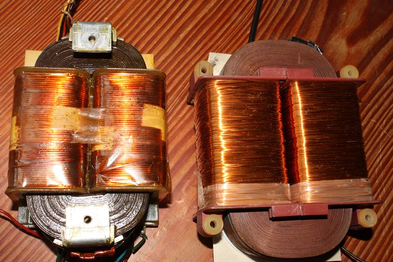

both are salvaged from scrapped amps, but have a guess which is 'new', and which is 'old' 😉
