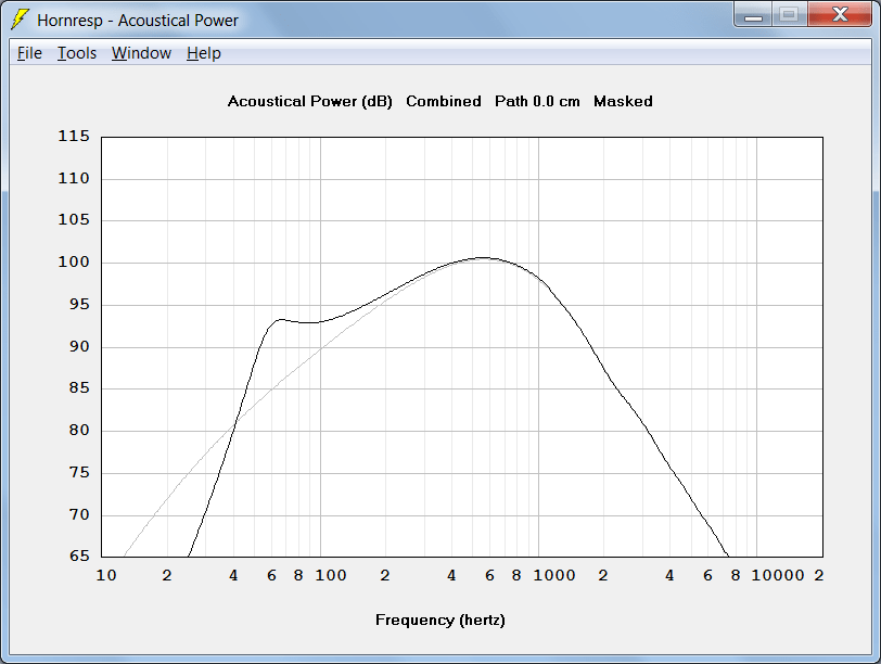

Do ported speakers really act like an IB above the port resonance frequency?
Black trace = ported enclosure, grey trace = sealed enclosure:
Thank you David. Could you help me to understand your graphs please, although I’m fairly confident I understand the first two.

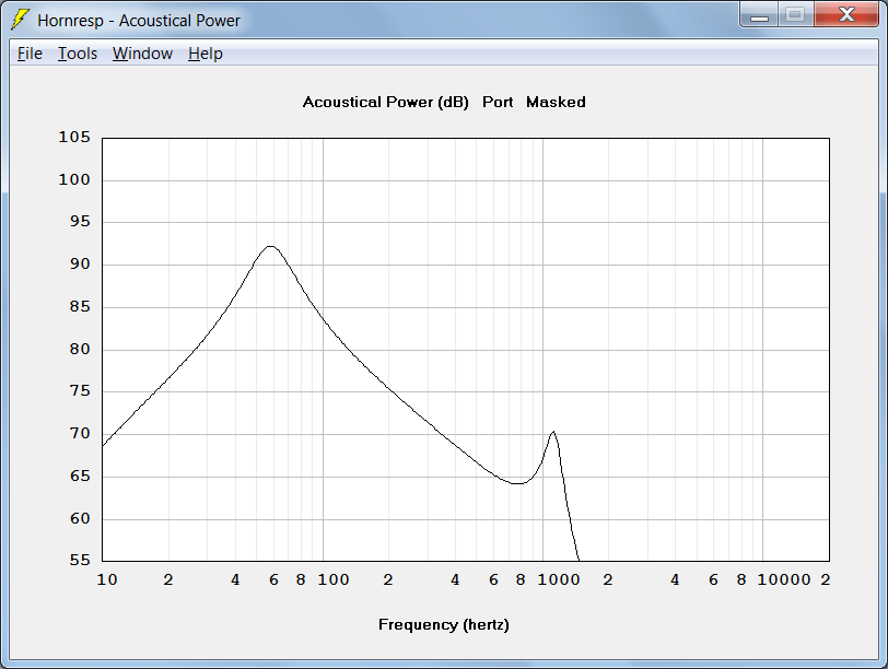

Graph 1 : Driver response & combined Driver+Port Response. So the port response would be the difference between the two responses?

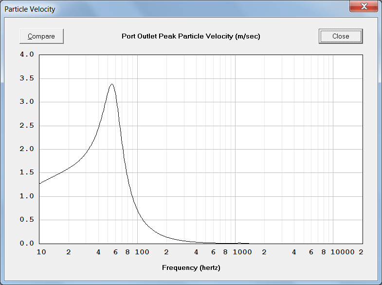

Graph 2: Port air velocity
Graph 3: I can’t work this one out!
Interestingly, graph 2 has answered another question I had about ports: Do they stop working below a certain air velocity? It seems that, by looking at the graph, output is continuous, gradually reducing with air velocity down to 0 m/s?
