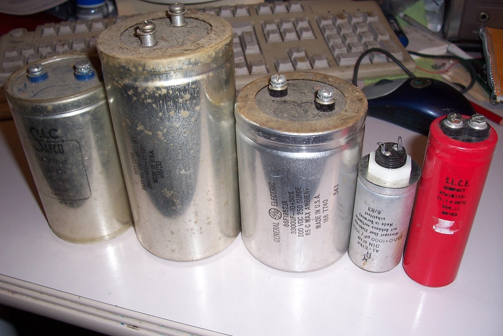

Some examples of vintage caps:
attachment.php

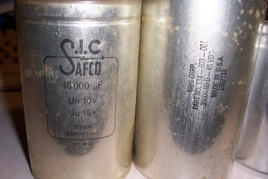

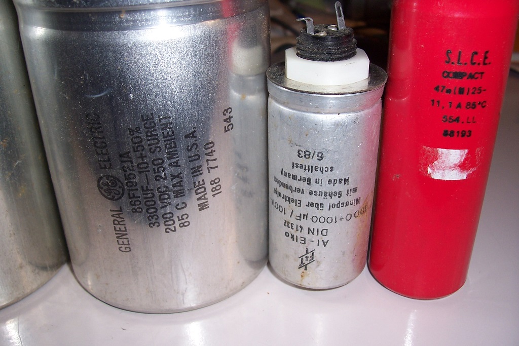

From left to right, in chronological order: a SIC/Safco 40,000µF/10V (1963), a MDS 39,000µF/45V (exact date unknown, early seventies), a GE 3300µF/200V (1977), a F&T 1000+1000µF/100V (1983), a SLCE 47,000µF/25V (1988).
attachment.php
attachment.php
Those have been not been used (yet), they have been gathering dust for decades on a shelf, but their twin brothers have worked, also for decades, in my bench and lab supplies, and I know that I could use them without problem, and without reforming them, except the F&T and the GE.
The F&T is a rare example of dodgy cap, and I wouldn't risk using it in anything serious.
German manufacturers generally have a very high level of excellence (like Siemens or ROE), but there are exceptions, and F&T is clearly one of them.
The construction type is antiquated for something made in 1983, and the quality standard also lags.
The GE one is a very good cap, but I wouldn't take the risk of a full 200V cold-start: the explosion of such a massive can could result in serious damages.
In general, computer-style caps are OK, even if they are very ancient.
Of course, the volume/capacity ratio is ridiculous by today's standards (the 40,000µF/10V is thumb-size nowadays), but they are also incredibly reliable by the same standards
