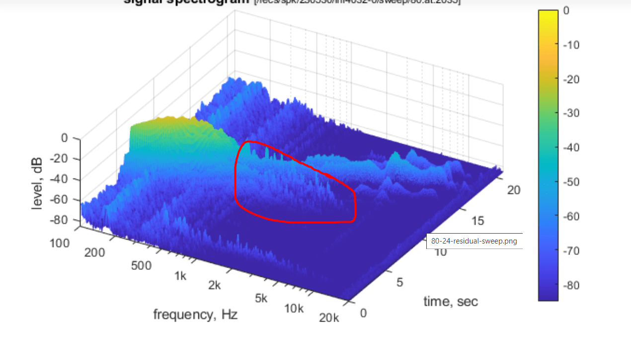

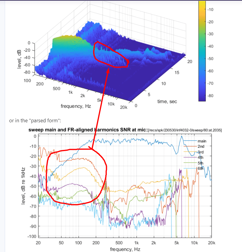

There is a KEY element for a measurement - it needs to be repeatable and compareable! If it can't do that you are drawing pictures and don't do measurements.For example, 15 sec of Mozart piano concerto, 300-3000Hz:

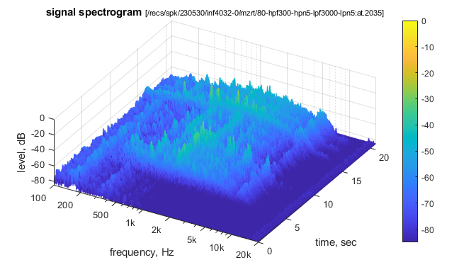

and the distortions (residuals of LTI filtering) are:

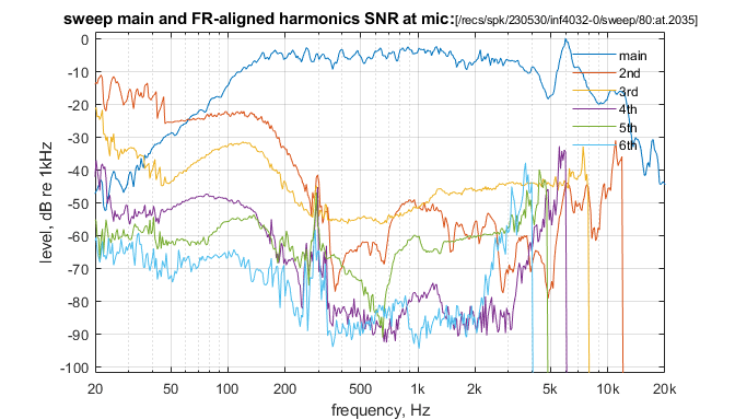

or in the "parsed form":
Actually, I am interested to learn how many DIYers would find the examination of adaptive filtering distortion residual useful?
The 2nd graph fullfills that criteria - it's repeatable and very well compareable. You can monitor even small changes during a development process.
Your spectogram is a nice graph but needs an additional step to make a measurement out of it. e.g. relation to the source signal. Pick out a time slice and have a closer look. We need to be able to see differences of at least 0,3dB - you now have a 80dB scale with colours ...
Many of the usual measurements are trimmed to exact these attributes - Frequency response with MLS/Sweep is repeatable, robust and precise. THD the same and shows a lot of the characters of a driver.
How they translate into what we are hearing ... is a different story. Klippels full scan gives a pretty good view of a speaker and uses these "ancient" measurements.
Short - distortion residual IS interesting, but we need a MEASUREMENT, not some pictures.

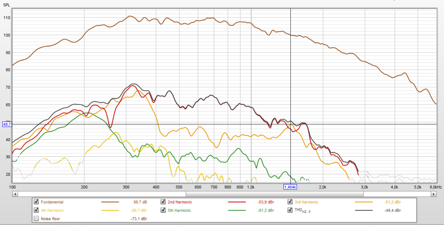

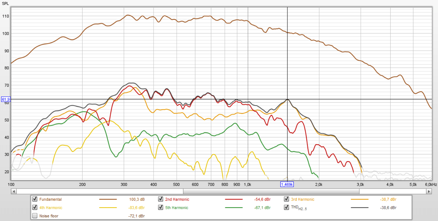

edit. here is midrange driver in application settings, with only DSP, and the other one is with series inductor and DSP adjusted to match closely. Drop in distortion is quite remarkable, although it's not particularly audible in the first place.
If I'm reading Mikets measuremnet corrently, this distortion that got reduced by increasing series impedance, is nicely visible plotted like so.
It's nice way to see how important excursion is to control distortion, even though the distortion seems nice and low on the midrange on the traditional distortion plot, the distortion products stem from the lows and output at the midrange. Basically the whole bandwidth is distorted if there is lows to make great excursion, no matter how low swept distortion plot shows for the midrange.
