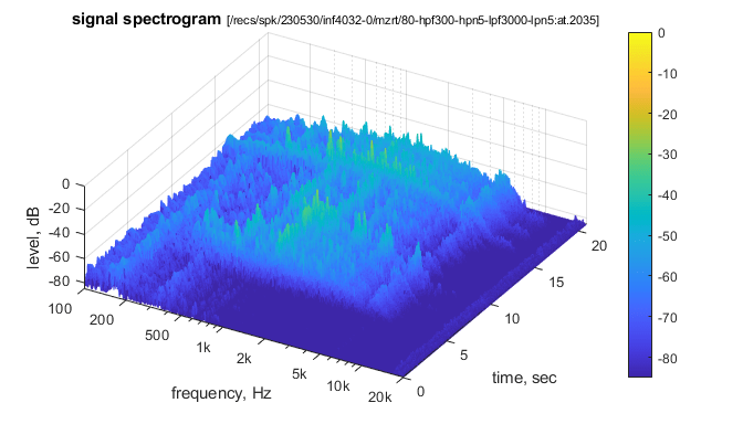

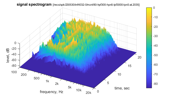

I am a mathematician specializing in adaptive filtering. I know how to separate the linear part of a driver/loudspeaker signal from non-linear distortions for any input including music. You can excite a driver in a test enclosure with a band-pass driver emulating your crossover, and see (and hear) the distortions separately.
For example, 15 sec of Mozart piano concerto, 300-3000Hz:
and the distortions (residuals of LTI filtering) are:

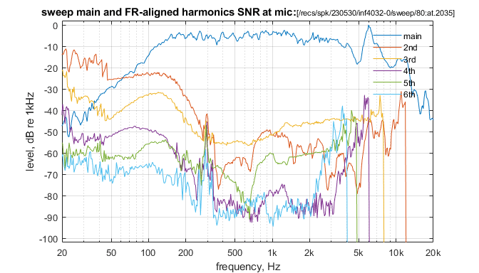

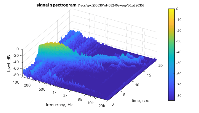

Now let's see the spectrum of sine-sweep distortions:
or in the "parsed form":
Some (most of🙂 speakers are pathetic in passing rising fronts of a signal.
As you can see, constant amplitude sine sweep measurements can not tell you the entire story, far from it. The "traditional" methods of loudspeaker measurements are antiquated and laughable ... but it's the best we have had.

All we had were swept sine, and they revealed terrible speakers for sure. I would agree they won't tell the entire story, but they can show a lot. Once we had waterfall responses to examine, well that told you a lot more. We even tried measuring distortion, however the signal to noise ratio results in a high residual. Signal averaging today can drop the noise if it is random.
Passive crossovers (are never passive in that they affect things) really make controlling the drivers difficult. An active crossover with one amplifier per driver cleans everything up a great deal. So you have to approach a system with realistic expectations. A passive crossover is a "make it go" solution. Want performance? You need to use an electronic crossover and separate amplifiers.
Leading edge response will always look bad when you hit a driver with a rise time that is outside it's passband. They have mass and limited motor ability. That's why flame (ion) type drivers were investigated. Panel speakers follow the same thoughts.

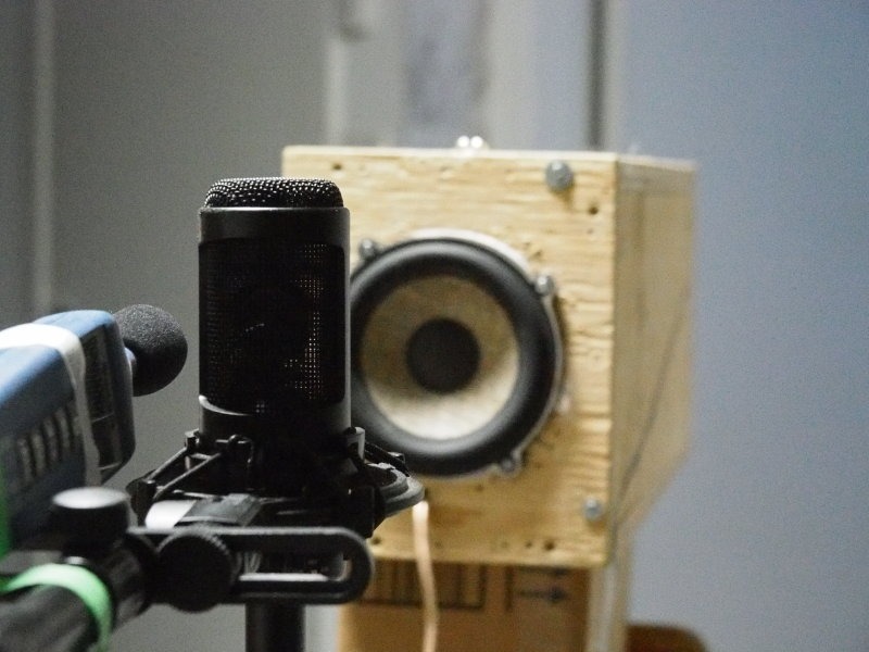

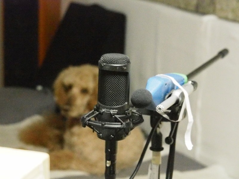

average 8' high living room, some sound absorption on the wall, area rugs throughout (I have dogs). Measurements are made in the center, 4' up, directed to avoid exciting mage resonance modes.mikets42: could you go into more detail into your test setup? It is not clear to me.
I use a dual mic setup for measurement mic is not good for anything besides measuring FR. A low-noise condenser mic, manually (sw) equalized to match the measurement mic, is used for actual measurements. There is also a sound level meter - just in case because the measurement mic was calibrated to have 94dB SPL at -11 dBFS. Cross-examination of a kind.
The DUT is a speaker mounted on a quite rigid test box full of damping foam.
The DUT and mics must be as close as possible without exceeding mic's {max sound pressure -25} but also to avoid letting amp noise dominate the room noise. Outside of the picture: Focusrite 2i2 G3 and 20i18 G1, i7-11700K desktop, TI's 3255 amplifier, cables.
Room's windows must be closed and all constantly blowing appliances stopped. Wait for a refrigerator to calm down and here we go....
You will need a home license of MATLAB (US$150 last time I checked) with signal processing and audio toolboxes. Register, download https://www.mathworks.com/matlabcen...peakers-for-aec-measurement-and-linearization
(GPL freeware) and start having fun! All your feedback is appreciated as I have endless blind spots.
Did I miss anything?
If this math-loaded approach gets enough customers then someone shall convert it into a more usable package,
Thanx, but the principle is not yet clear: what does one and what does the other mic register? You feed the 15 secs of 300-3000 Hz Mozart clip and record that. But then I am lost....
