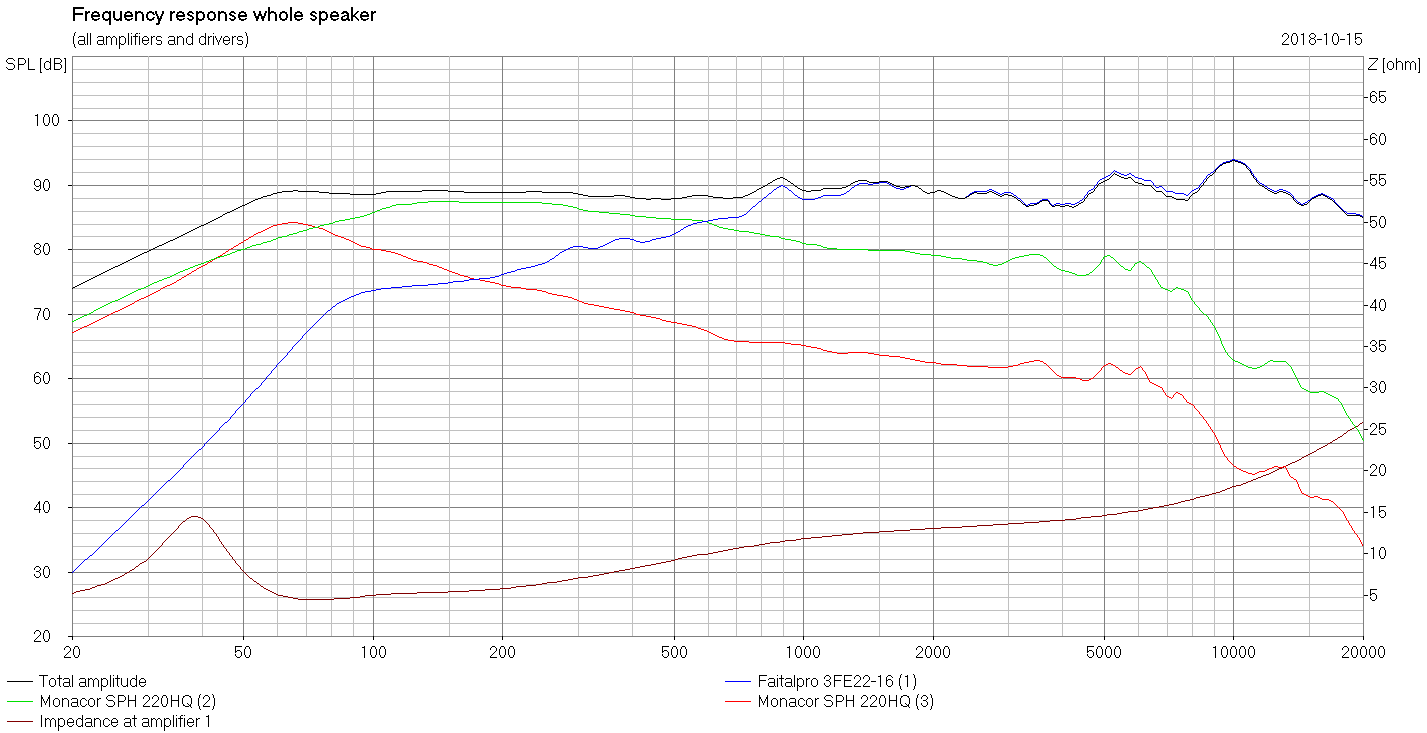

Anyway. I gave up on the second woofer idea. The program I used didn't handle multiple drivers with different crossovers very good. The impedance peak messed up the XO and gave me sensitivity peak at that frequency. To flatten the peak out I would need to add parts to the filter I didn't want and it was costly.
I then migrated my project to boxsim which is a much better program. It managed multiple drivers correctly. And when the drivers was in parallell there the peak was evened out enough for the bass extender to work again. So I revived the Idea.
So, what do you think of the attached graph? It includes calculations on the box with baffle step. The woofers and the 3FE22 I based my calculations on have roughly the same sensitivity. So I couldn't just counter the baffle step by matching XO frequency. For that I would need a louder woofer or two of them. So instead I switched to the 16Ω version of the 3FE22. Then I subtracted 3dB from the measurements since they where at 1W/1m, and I wanted 2.83V/1m. Was this correct?
The 8Ω woofers and a 16Ω fullrange together evens out the impedance peaks pretty well. So the filter is simple. 1st order between 3FE22 and the woofer, and 1st order low pass on the bass extending woofer. No baffle step correction, no impedance equalization circuit ot anything else. I did however need to mirror the polarity of the fullrange despite 1st order XO.
As you see the impedance rises a bit in this graph, so one might think sensitivity would be skewed accordingly. But as I said, I have lowered the fullrange 3dB to get a good picture of how it performs at the same voltage as the woofers.
