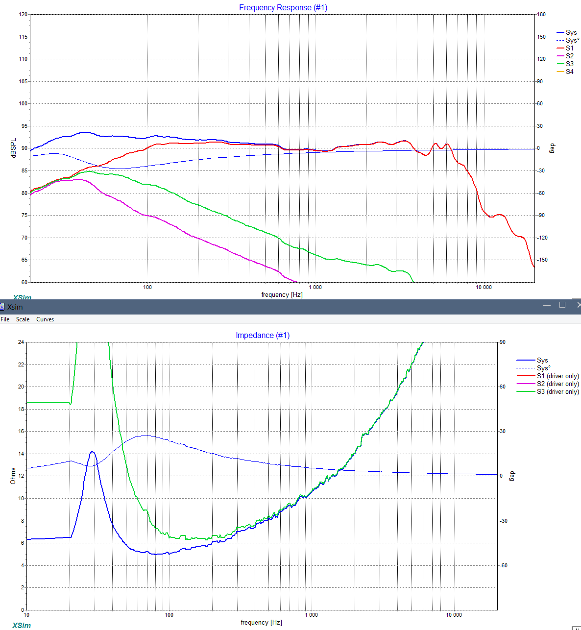

- hi X - wonder if my 30uF/1.5mH highpass and 4fe32 with 0.2 liter chamber would need much padding with Dayton's PA310-8 ? Faital's rating of 2.7 mm excursion shows >50 volts could be applied to the FR (hahaha) w/o exceeding xmax. Is there a good "1st" order solution with 4fe32? I don't like seeing cones move at high spl.
That 50v doesn’t sound right Freddi. With 91dB sensitivity, I recall these hit xmax around 15vrms or 30w. Are you sure you have the correct TS parameters?
So I shall research PLLXO a bit. But dependent on the amplifier? Why? Seems like it is complicating things.
The HP is a single cap and uses the input resistance of the amplifier for the other half of the filter. So C depends on R.

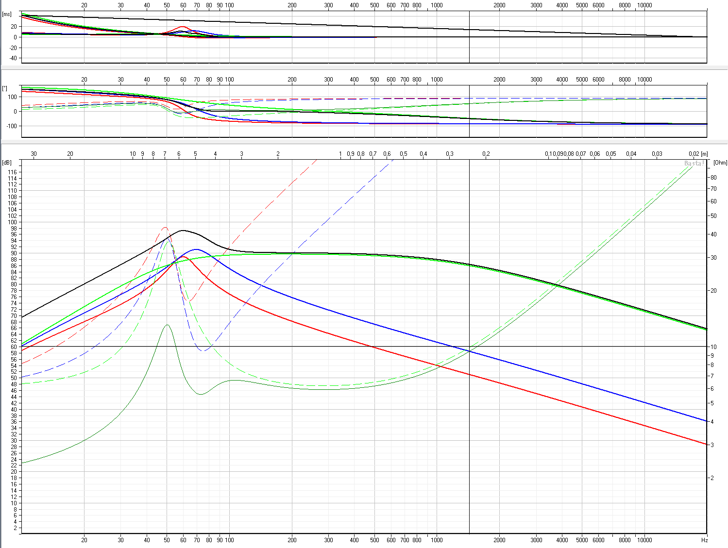

X - here's my sim - 12.2 cubic inches T-S I think from Partsexpress - they claim like 2.7mm xmax IIRC (?)
of course 10 watts sine long term would probably fry the coil
Freddi,
Are you saying you are using a high pass filter? In that case probably so with respect to xmax, but thermally 50vrms is 312w and it’s rated 30w thermal - which is about 15vrms.
yeah - 30uF/1.5mH - within the excursion limit if the voice coil could take it and not melt nor change resistance >56 volts. Qtc ~2, - filter Q ~0.5 (or less to compensate for unfiltered peaking) you can see the highpass gain is about -6 or 7dB @ 400Hz so compensates for the unfiltered peaking with 12.2 cubic inches tight back chamber = not much movement. Would it "sound" better on the highest spl peaks it could handle with a so called "1st order" passive highpass filter ? seems like that would take RLC Z nulling = more cost and still not "1st order"

Below are the simulation in XSim. The red speaker curve is unfiltered, and the Purple and Green curves are filtered with inductors at 25mH and 60mH respectively. Blue is total. I don't know if the Impedance is a problem. Never mind the jagged curve. It was a low resolution pic I made the ZMA form.
And below is the same configuration (with different colors) in Basta. It's a mess. I'm new to this so the bump maybe is what to expect with an LP filter? And the fact that Basta can't handle FRD or ZMA-files doesn't improve things.
In short. XSim and Basta gives me very mixed signals about the feasability of the project. And so does the internet.
Are there any objections to the alternative with the Beyma in a closed box with 1st order XO? In both alternatives i am thinking of putting the XO in a way to smooth out the baffle step. Also beveling the cabinet.
