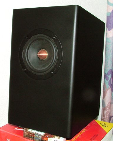

Robert, just go for it!!!
I`ve just discover the joy of fullrange myself. I have been listening to different speakers for 30 years, and none of them have given me the pleasure as the FR do. I did build myself a pair of speakers with Lowther DX3`s a month ago, and I`m pretty sure that I`ll never going back to the traditional ones again.
http://foto.aftenposten.no/show_album.php?aid=1095275
And, if you really want to enjoy the FR, go for tube amps too. I`ve replaced my transistors with a pair of 300B monoblocks. Wow What a difference!
After listening to FR for a month, I have been asking myself: where have you been those 30 years? I`m really sorry that I didn`t discover this earlier. Well, I`ll hopefully have many years to come, so!
The only drawback is the loss of bass. I am going to make myself a subwoofer with a 15" Beyma (98db) and with an active amp (Hypex 175W) to compliment the setup.
I`m pretty sure you`ll never regret if you do!!
Good luck with the choice you`ll make!

Try Fostex FE206E or FE207E(shielded), if you want slightly better speaker try Lowther...which is more expensive.

Just one thing Robert.
As I understand, you are able to make some complex cabinets.
Go for two layers of 10mm plywood with fine sand between them. You can also use wood as the outer layer instead of plywood of course.
I`ll think that you will find this as a better construction than the usual MDF one.
There will be no resonance what so ever!
Good luck, whatever design you choose to make!

love FR loudspeakers?...yup you probably do
a couple of comments..
first: if you love all music then, AFAIC, FRs are the way . You can always add a sub.
second: many comment about beeming, etc. Depending on the driver, this may or may not be the case.
third: this site is a great resource, many designers "hang out " here (I'm not one for sure)
fourth: never underestimate what 8 watts (or as few as 1.2) can do.
Now if I was you, I'd search out a great old console with a tube amp and (ususally) full range drivers or consider "vintage" drivers, or a pair (or two) of Radioshack 40-1197 drivers or similar. The Fostex drivers are better and well supported in the DIY community. Search Planet10's site (moderator,). I'm not promoting his business at all, but he and his fellow Islander Chris make a huge number of DIY loudspeakers and have a good sized library plans available free.

What I've learned over time has to do with
putting 2 lbs. in a one lb. bag.
To get the most out of full range, bigger is better.
This doesn't mean you have to play loud to
get something out of 4-5 in. full range drivers.
It more has to do with the music system having
room to breath in the sense that acoustic theory
says a certain length for the sound wave to
do its thing is needed.
So I asked the same sort of questions when I
started: how to put big sound in a small box?
I wound up somewhere in the middle-- not exactly
floor standers as a build but not the standard
bookshelf system from the Sansui 70's either.
Think outside the box for a bit and select a low
to mid-low price point like the Fostex 126/127e.
Bigger is Better so to get a small footprint you
can make some BIBs and put them in corners
of the room in a tall but slim design.
Here's a build that is getting a lot of attention:
http://www.zillaspeak.com/bib.asp
There's a long thread here on it, but the zilla site is better
laid out for a quick glance.
Also for that mid size project, check out the
Full range reference project here which shows the
range of construction based one driver:
the Fostex 127e. I say range rather than
how-to because the reference project consists
of a variety of designs for the same unit.
http://www.diyaudio.com/forums/showthread.php?s=&threadid=46934

My two cents on full-rangers:
Mine are CSS FR125S in a 9 litre bass reflex cabinet tuned to around 50 Hz. Additionally, I've used two notch filters to linearize the frequency response (1.5 KHz & 6.5 KHz).
Before, I had them in the recommended 7 litre cabinet without filters. The CSS FR125S sounds very good without filters at low volumes. With filters, they sound better at high volumes but seem to have lost a bit of their amazing detail. Still, they sound far more coherent than my two-way speakers and yes, the low end is simply amazing (don't go for a sealed configuration unless you want to use a subwoofer). What surprises me is that with sufficient damping they can play loud without screwing up the bass!
Beaming is an issue: you need to aim the speakers at your listening position otherwise there's not enough high end.
For DIY, I'd say it's more interesting to build a 1-way system than a 2 or 3-way system because there are enough cheap and good multiway speakers on the market anyway.
To make it short: Build a 1-way!
