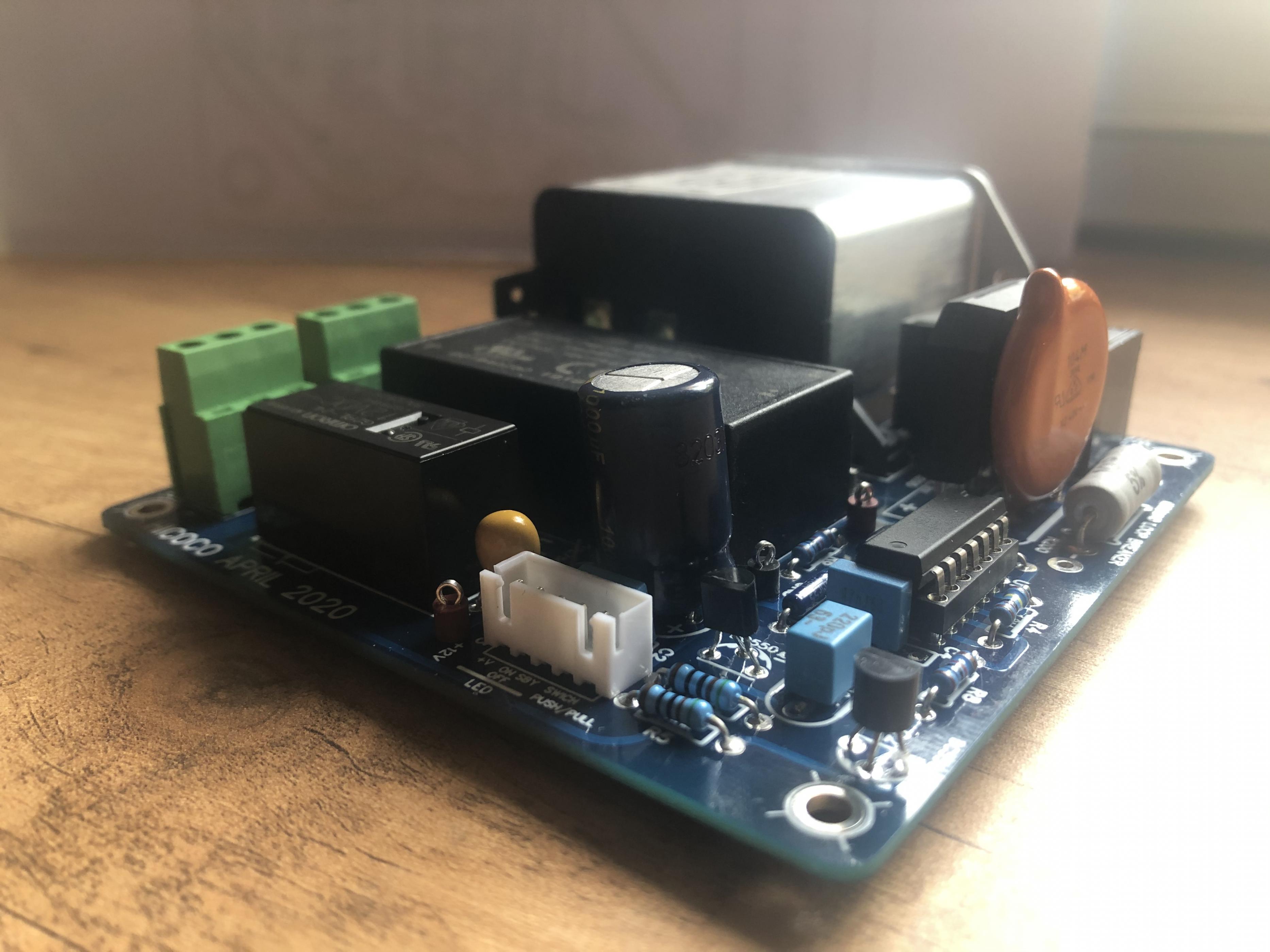

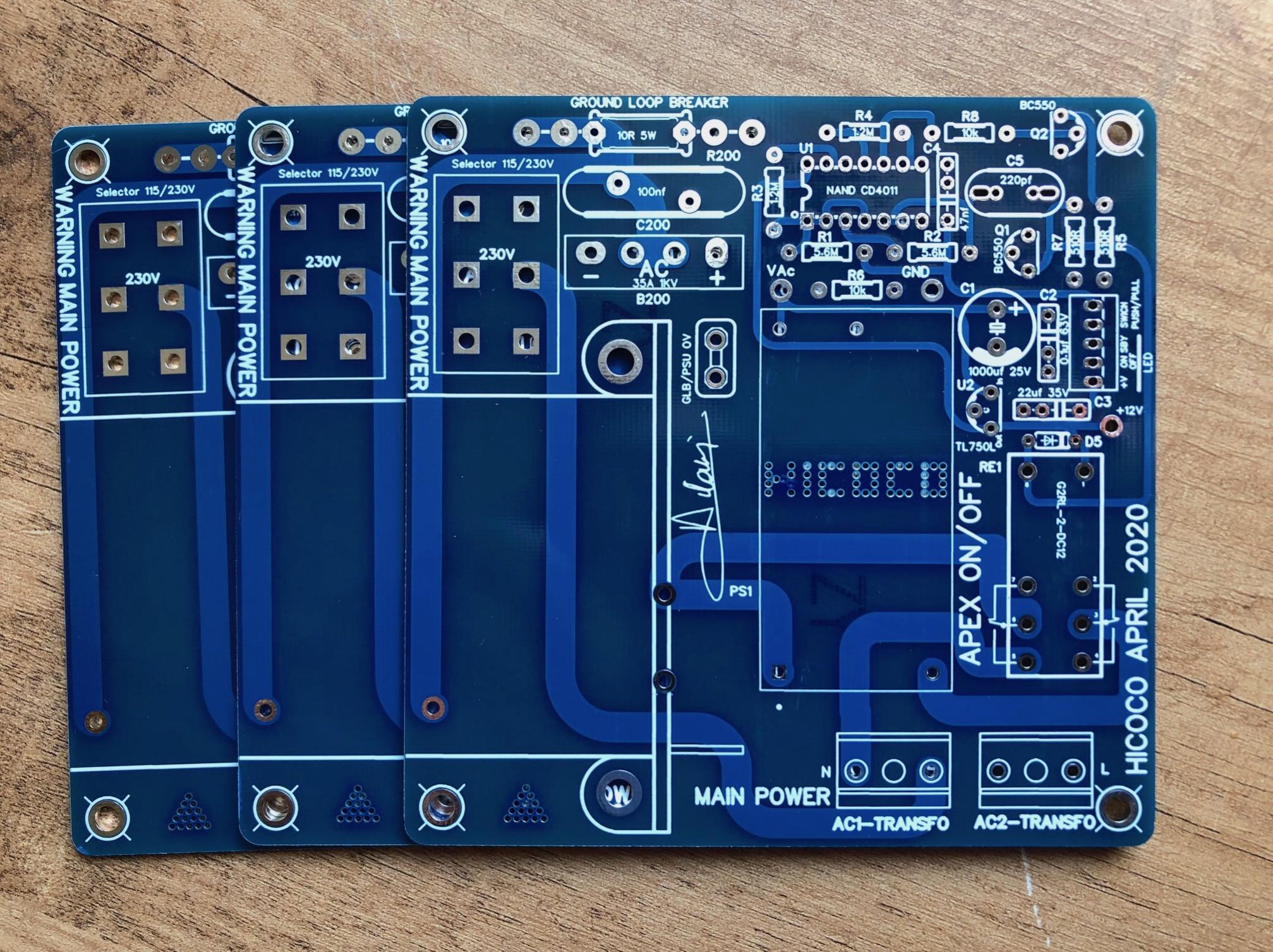

I have a spare of this ON/OFF switch, may be this is what you are looking for.
