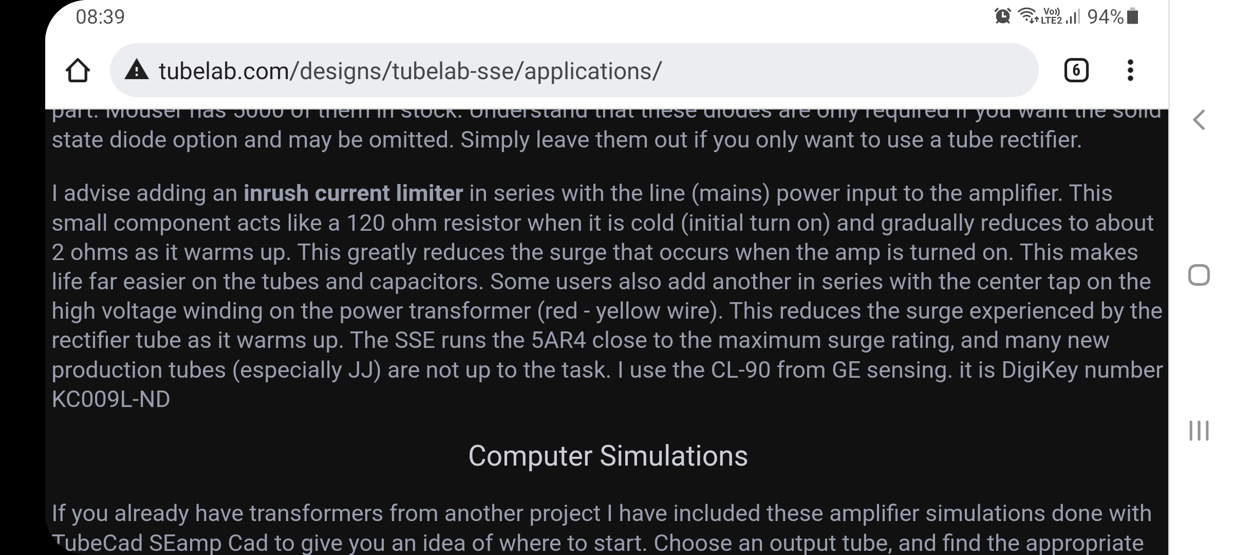

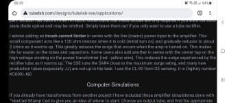

On this page does Gorge mention a inlines current rush limiter. Is this a replacement for R1 or is it a complement?

The inrush current limiter is an optional component that could be wired in series with the line supply to the power transformer. It slows down the initial surge of current when the amp is first switched on to make life easier on the tubes and caps. After the first 30 seconds or so, it does nothing.

There are three components that are not documented on the web site instructions. D3 and D4 are ordinary 1N4007 or UF4007 diodes. TR-1 is a CL140 inrush current limiter. These parts were added after around 2012 to improve the life of the rectifier tube at a time when the quality of some new production tubes was pretty bad. Be sure to order them with all the other parts.

TR-1: I Have 2pc of CL-90, are those sufficient?
