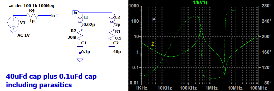

Who here thinks about resonances? Every part has R L and C. Every part has at least one resonance. Any two parts together will have *multiple* resonances.
There was a time when electrolytic caps had large ESR and also large inductance. Back in 1959. Today the inductance is similar to a piece of wire between the cap terminals.

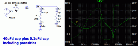

Say you put 0.1uFd across 40uFd. The 40u cap Z drops from 4r @ 1kHz toward 0.7r @ 10kHz. It may typically have 2uH of inductance which drives Z higher.
With a 0.1uFd across that, we have a parallel tuned circuit a lot like the input to an AM radio. (Who here built crystal radios?) Like the radio the impedance goes HIGH at some point. For the estimated values here, around 330kHz. And 40 Ohms, far worse than the 40uFd alone.
This don't help. Does it hurt? Most tube audio amps have little gain at 330kHz. Not just the nominal gain between jacks, but any internal gain may make trouble.
If you "need" to do this, you may actually want "high ESR" which would spoil the Q of the resonance, lower and flatten the 330kHz resonant tuned circuit.

Some real, measured data can be found here:
paralleling film caps with electrolytic caps
Draw your own conclusions....

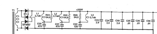

ARC have had a solution for this for the last 30 years. Interestingly, they use the same decoupling components in all their power supplies, whether B+ or heaters. Very easy to replicate.
US5036292A - Decoupled electrolytic capacitor
