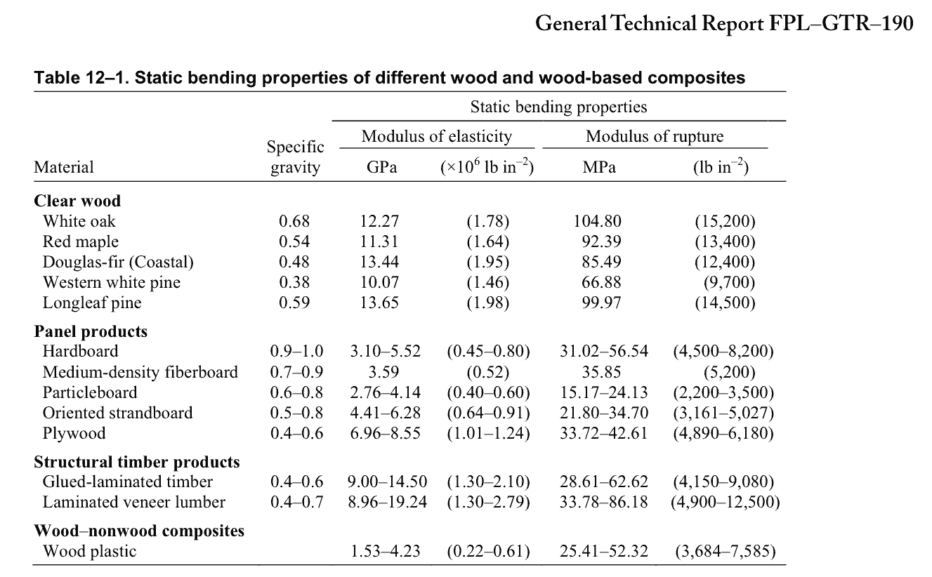

Did some googling, MDF is typically 3450 MPa, Baltic Birch 9100 MPa (bigger is better), which, in this case, gives an even grater advantage to BB than the GM supplied number of 18mm BB ~ 1 1/4" MDF
Attached is a more generic table from a textbook. You can see that BB is at the top end of the scale.

Thanks Dan for explaining.
In my view, conclusions based on material characteristics charts are not very useful for this subject. Charts of those properties are based on 'contact vibration' and panels in free field. They don’t represent acoustic properties from a loudspeaker enclosure.
In a study from Jim Moriyasu (AudioXPress, February 2002) for an 8” subwoofer, he tested the same design with different blank panels to construct several enclosures. He measured a 1 to 2dB lower level of primary resonances for MDF compared to plywood. In a study for studio loudspeakers from Any Munro (Munro Acoustics) for Dynaudio Acoustics/Professional (not published but shown at an AES convention) the conclusion was 22mm MDF had similar properties to high quality 25mm (18-layer) Scandinavian plywood for the Dynaudio ABES studio subwoofer. In several AES papers you can find studies as part of research for subwoofers/loudspeakers in which they 'prefer' the acoustic properties of MDF. 99% of all top range studio monitors use MDF. Using an economic factor for their choice would be strange for 50K+ Dollar handcrafted systems.
Anyway, studies may have shown an 1 or 2dB better damping values for MDF, this number becomes even less when proper (supported) braces are used. For that reason you can even build high quality enclosures from (fine) particle board if you know what you are doing. But lets face it, how serious and sexy would your design be received if you are using particle board? When you ask a critic if he ever properly constructed a particle board enclosure and compared it one on one with ply or MDF the answer is... In my view the only motivation why particle board has a bad reputation is because all cheap and bad constructed encloses use it. It doesn't matter much what you are using; mdf, ply or even particle board. However, I do agree with Dan that (supported) braces are not an option...

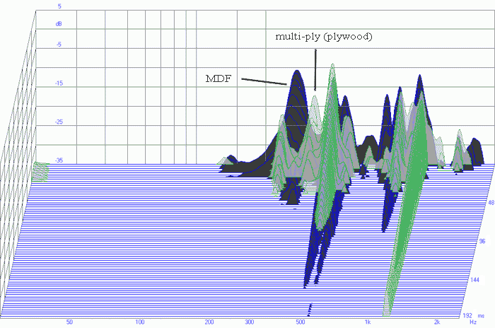

Excuse my ignorance, but when researching the charm of different panel materials, do you want to see the resonance higher or lower? Wouldn't ballooning flexing walls make it lower (and all other freqs where you have ballooning)? But higher where you have some kind of sympathetic vibration at unison or octaves?
Ben
I aim for as high a panel resonance as possible. With energy available to excite any (potential) resonance falling with the square of the frequency, so if you can get them high enuff they will not likely ever get excited and it will be as if they do not exist. THis theory has worked very well in practise for me.
Wouldn't ballooning flexing walls make it lower?
Typically a subwoofer box is small compared to the frequencies it produces, so it is easy to push (potential) resonances above the passband. Ballooning is different, and happens when the walls are not strong and stiff enuff to resist being pushed out or pulled in by the change in pressure inside the box.

My bad. Interesting to hear your take on wall-resonance freq but my puzzlement had to do with the alleged research showing amplitude of output changes (and presumably, we are talking about total box output... drivers and walls). In that case, ballooning versus sympathetic vibration act in opposite ways. In other words, is it more desirable to show the amplitude goes down or the amplitude goes up, say at the box resonant freq?

I'll do you one better, here is an overlay from that study. It will be noticed that ply resonates at higher frequencies. The stuff above 500 hz will likely never get excited, possiblly the one at 500 Hz (ply falls faster than MDF), the big MDF one at the bottom quite likely.
